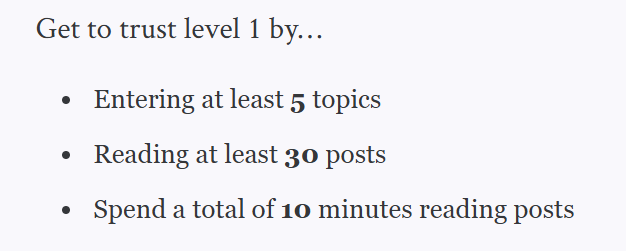

Unfortunately, there’s so much spam etc around that forums need to take some spam protection measures ( Understanding Discourse Trust Levels). But they are not overly difficult to meet.
You already have the 10 Min reading time, so it is probably only a matter of entering and scrolling through a few more posts (maybe search for “PETG” in the forum?) or needing to wait for the system to update (which can be forced by logging out and in again).
