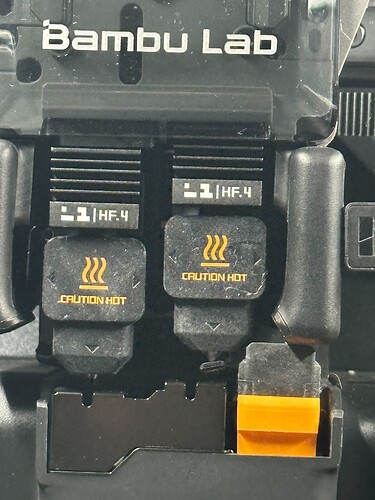

I don’t know if any of you experienced something similar, but somewhere around the last time I did a firmware update, my printhead isn’t aligning correctly with the purge bucket when using the left extruder and it creates weird chunk of plastic that sticks on the top of the purge bucket. Is there a way to adjust that?
Here’s a picture of what it does:
Anyone knows if there’s a way to either calibrate that or reset the purge position for the left toolhead? The right toolhead doesn’t seem to have the same issue.
So, turns out that the right nozzle does the same thing, it’s wrongly offset to the left and extrudes on the top part of the purge bucket. I’ve been going through a multitude of steps trying to resolve this with tech support, but so far, nothing has worked.
I’ve seen people have this problem before but it was because they had something in the way of the print head so when the print head would home it would hit something and home at the wrong location. Are you sure the print head isn’t hitting something or there isn’t a plastic piece in the belts or something? Have you tried recalibrating the machine or reseting it? I’m guessing since you talked to support you probably already tried these things? I have definitely seen multiple people have this exact issue. For some they had the poop chute installed incorrectly and the print head was hitting wrong.
I can’t see it hit anything. I even sent a video of the whole homing process to their tech support and nobody reported that. I’ll definitely take a look though. They did make me check if the purge bucket is installed correctly (and it is) and if my hotends are installed correctly as well (both are installed correctly).
This started happening after I installed the laser upgrade. Everything else seems to be working correctly. Once it starts printing, everything is aligned correctly, even when it changes nozzles for a second color.

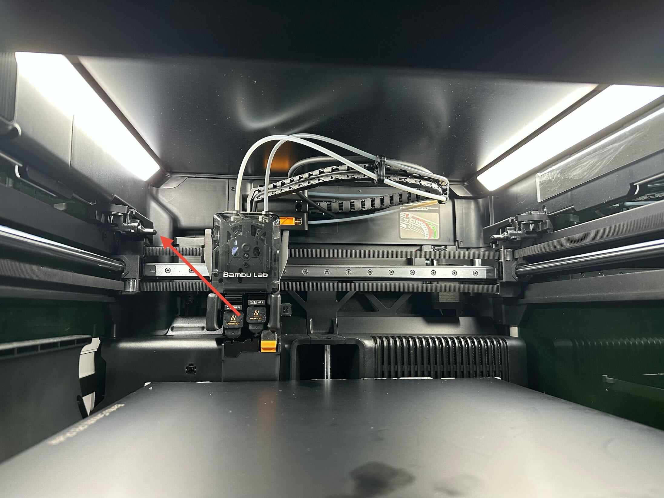

I think I found the problem! When I installed the laser upgrade, I must have bumped something in there. One of the 2 plastic pins on each side of the printer that seem to lock in place when the printhead goes all the way to the back, like to park or to purge, was a bit offset compared to the other one.
There’s a gear in the back of that thing and it looked like it had skipped a tooth. I popped it back into its correct position and now the heads align correctly.
