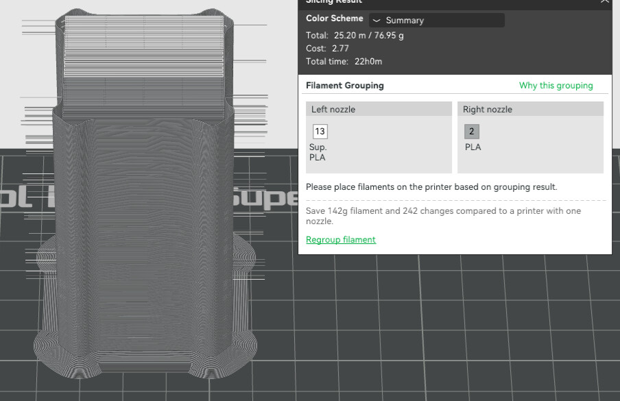

Purge is beginning to extrude before the purge tower
Not sure if this is a setting I’ve messed up or something?
This is the result of a slice on my H2D, left nozzle has Support for PLA, right nozzle has PLA. Used the suggested settings when I switched support interface to the Support material.
Why would my purge begin off the tower?

As far as I can tell, it is tied to the “Adhesiveness category” in the filament settings.
If two filaments have (very?) different categories, the slicer assumes the need for good anchoring at the tower walls. To achieve this, it ensures an already in-process extrusion as the nozzle crosses the wall.

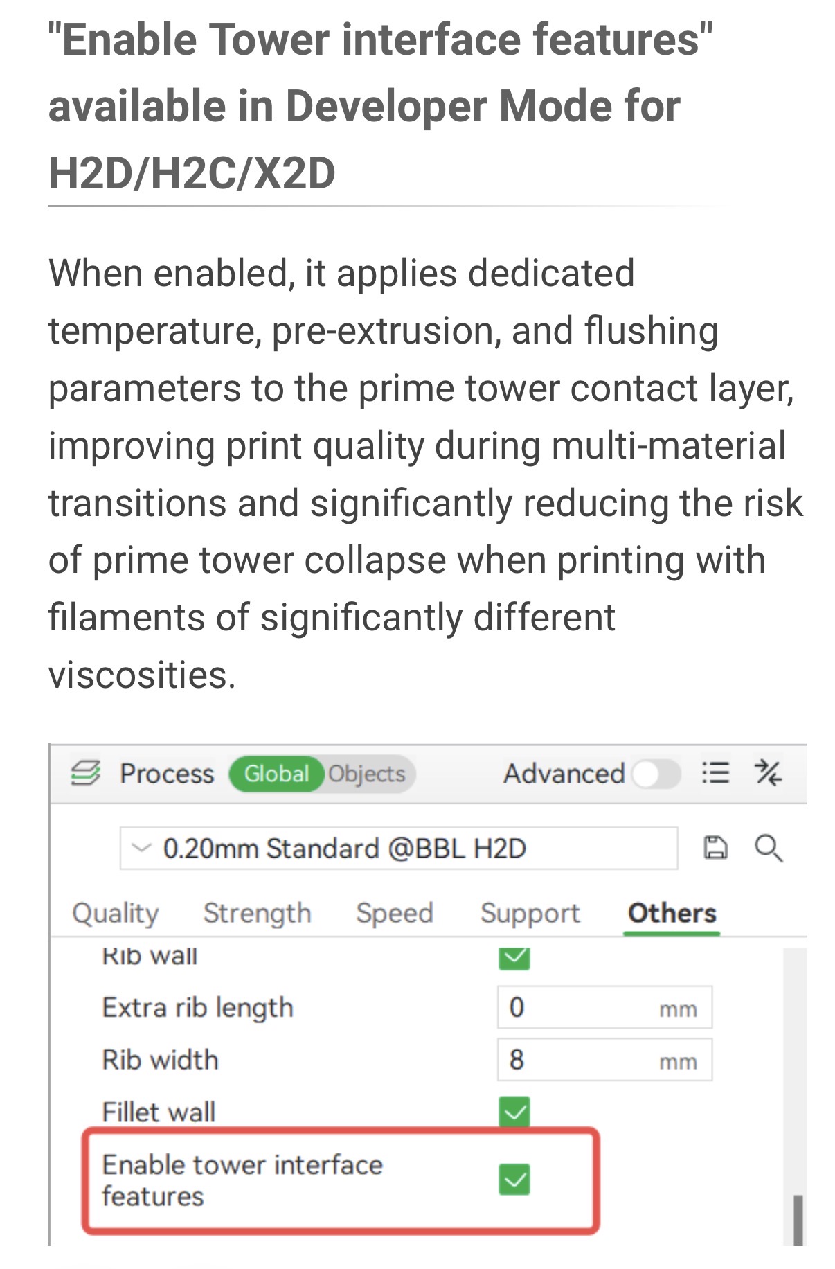

It only occurs if you use 2 different materials. It also increases the nozzle temperature to make a better bonding with the other material.
So multiple colors of the same material should not have this behavior.
There was a nice image of the before and after situation in the what’s new notes of Bambu Studio but somehow Bambu has removed it, or I am just getting blind. As. Soon as I find the link, I will share it.
Here is the link. You can disable it also:
