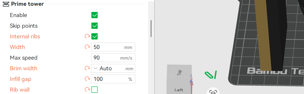

My Bambu Studio acts crazy with the purge tower after this newest update as well… If I tell it not to do a rib wall, and want it to do the older style of purge tower, it goes insane and doubles or triples the length of the tower. I miss the old one.

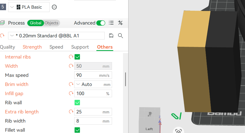

You can manually adjust the purge tower’s size but wow that is a cursed screenshot.
The width you can - which you can see I already did - but the length of it you cannot.

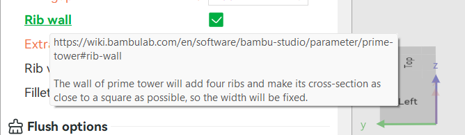

Enabling rib wall allows rib length to be changed
Is that before or after slicing? That is crazy.
I get the old style tower pre-slice then that unusual shape after slicing.
