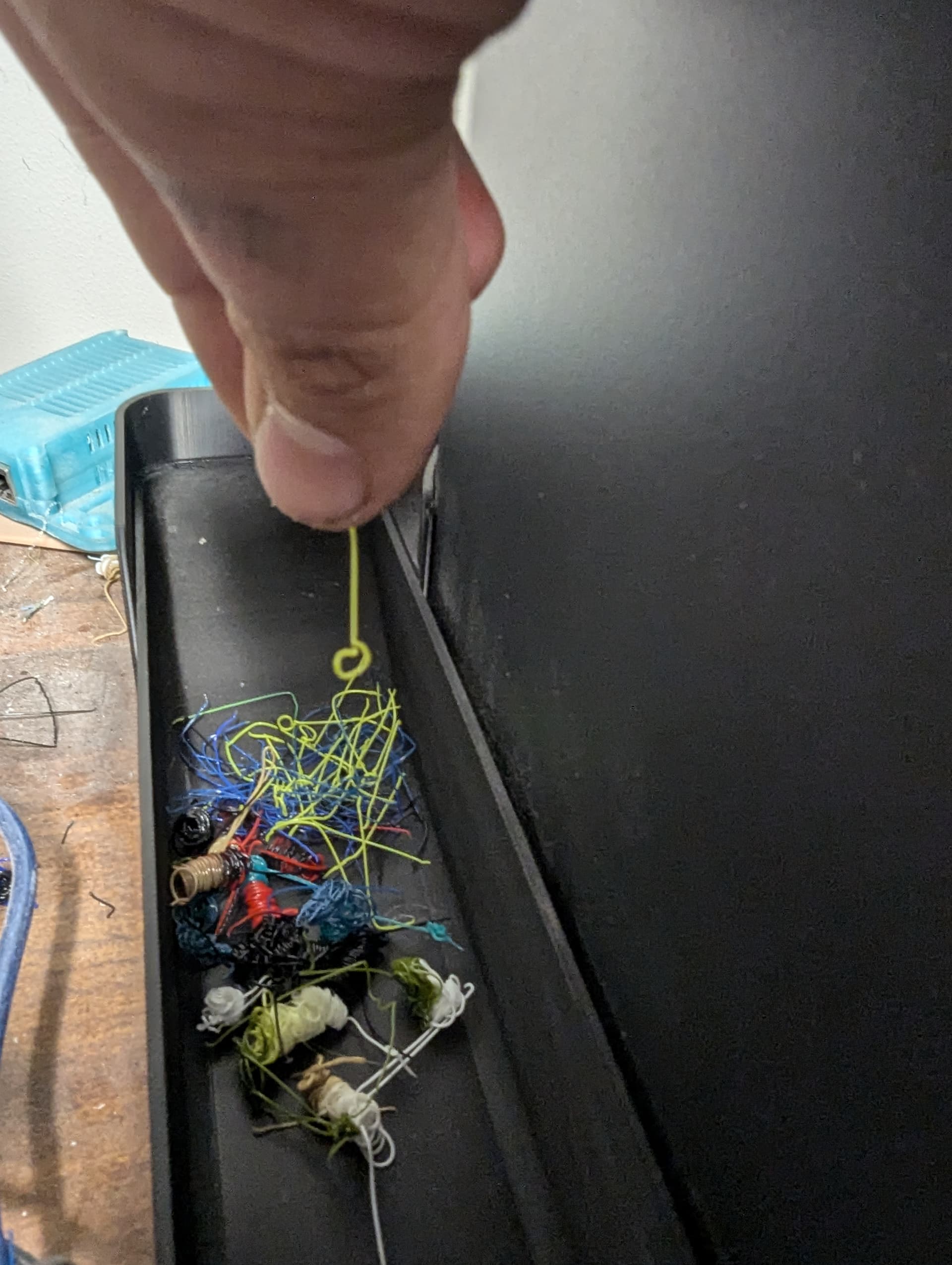

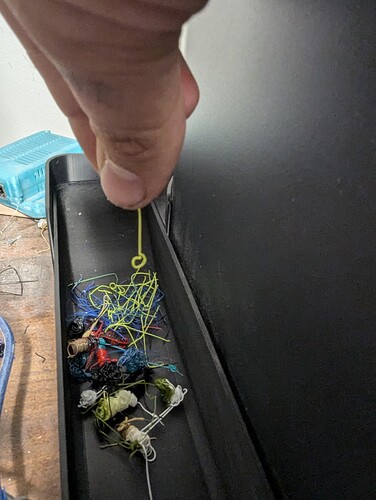

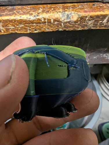

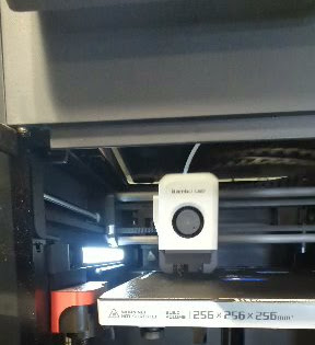

I don’t know what is causing these issues but I have cleaned my extruder and made sure there are no clogs in the hotend or the AMS. After cleaning and proper maintenance, this issue still happens. I am at a loss. from the video a slight clicking can be heard when the filament is being pulled back and when it purges it does a little spurt and then goes back to printing. I have tried to load filament from orca slicer, bambu studio and the printer itself, all have these issues. I have even factory reset the printer to no avail. Disregard the thermal sock not on the nozzle, it broke when I had a blob of death.The purge volume if fine but the actual poop part is the issue. In the video you can see it only does a small little spurt and then continues to print. Normally the poops take a few seconds and build up a little bit. In the first picture of the poop chute you can see the little strands Below is the video for what it is doing

Just asking as I see a big white poop, a small red one as well.
My flushing volumes are fine. The big ones there are from previous prints. The blue and yellow are from the most recent prints

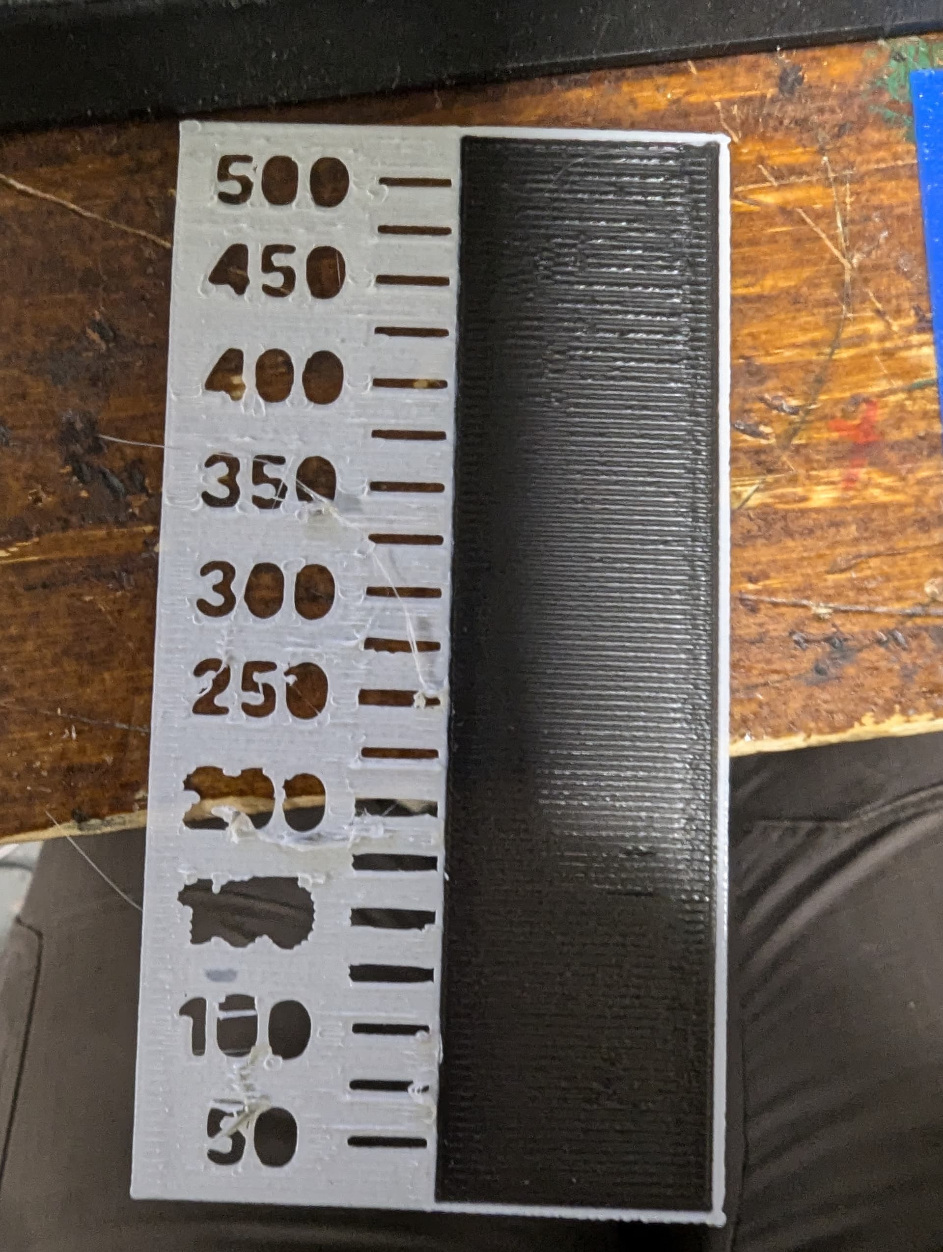

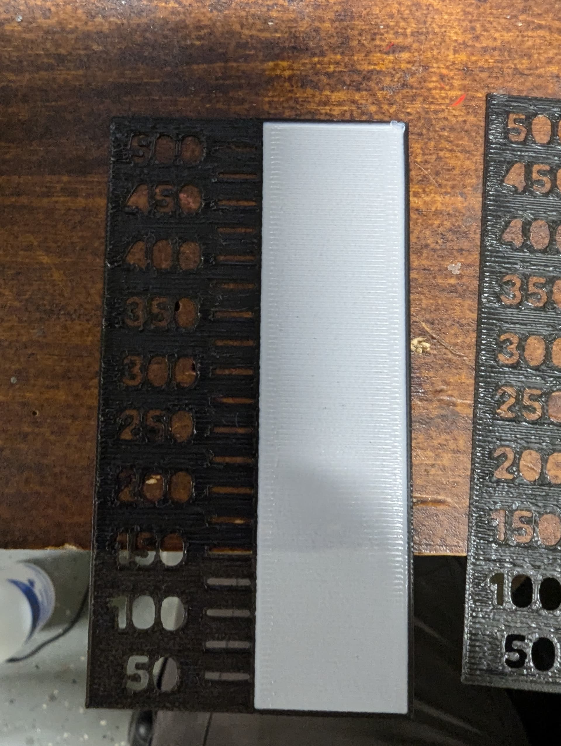

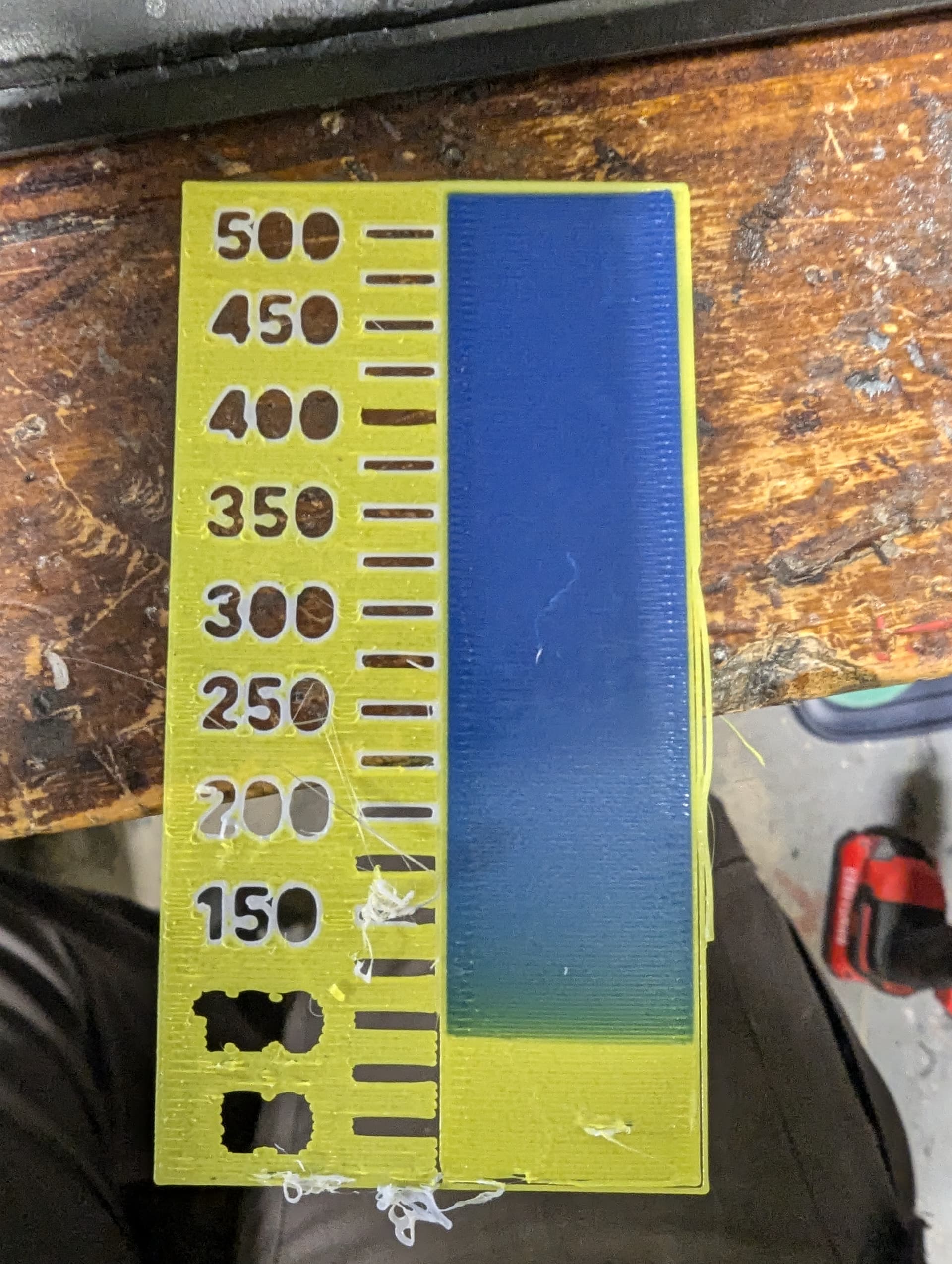

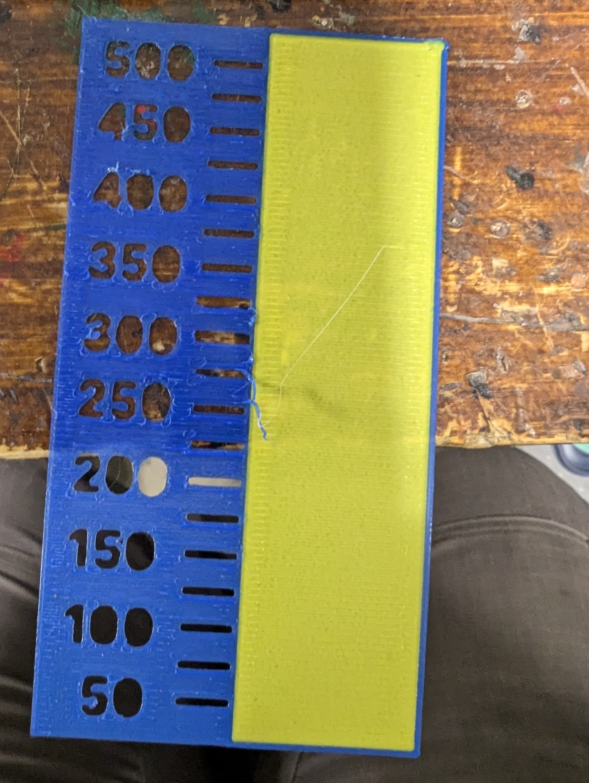

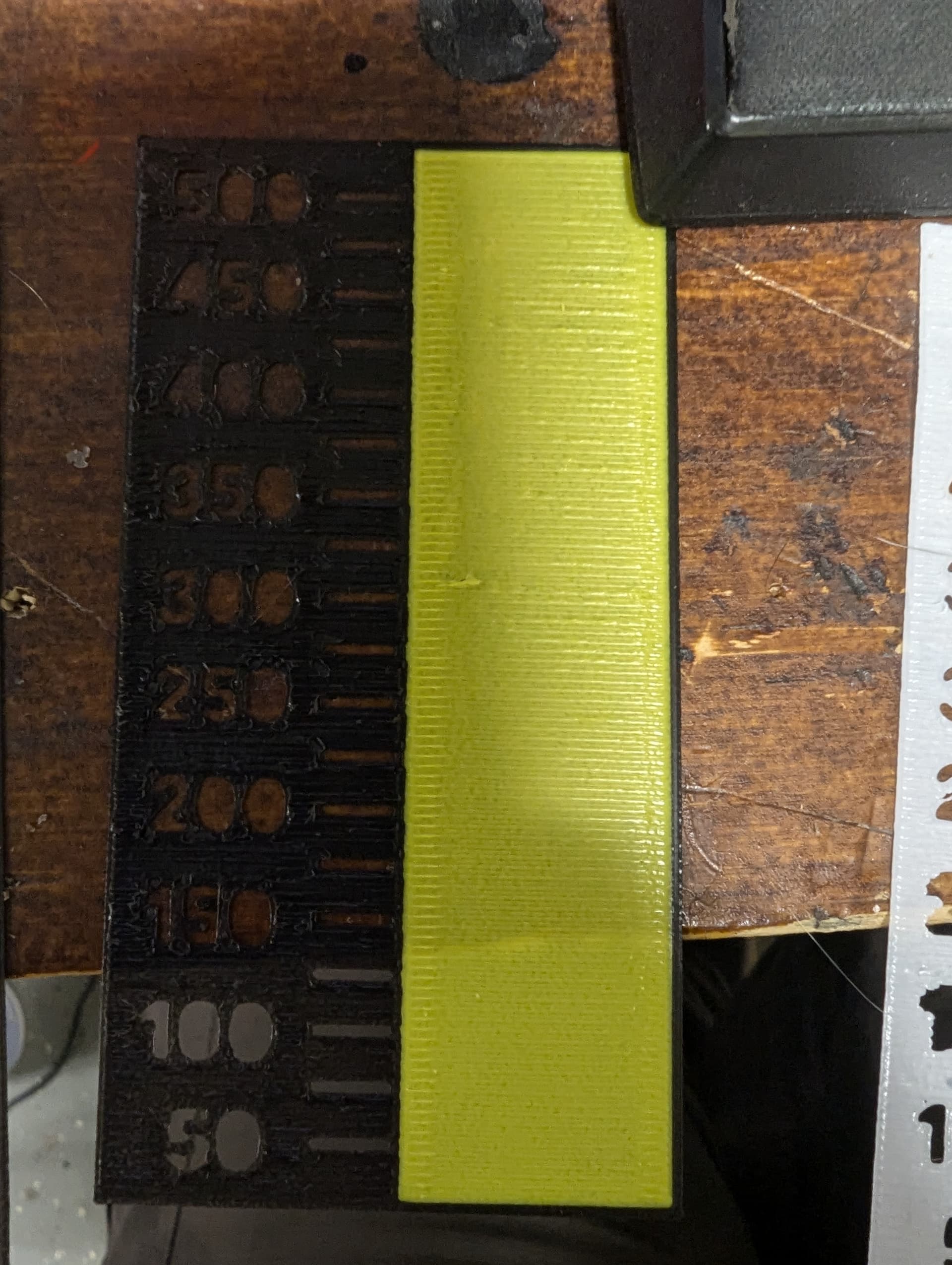

I did a purge test on my filament and for some reason yellow to blue had issues but all others were fine
