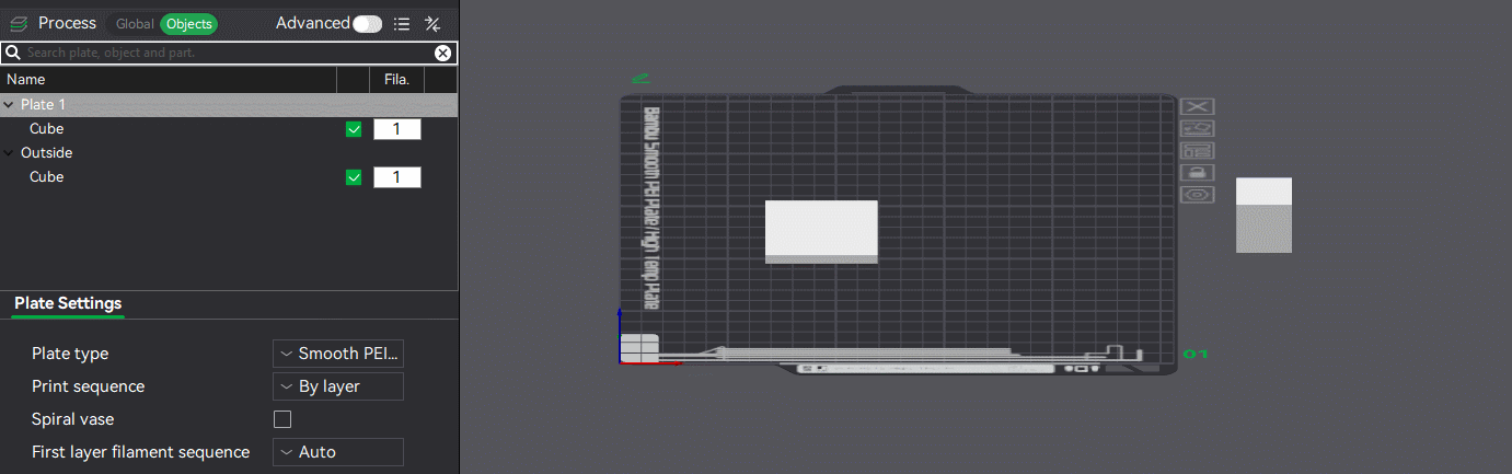

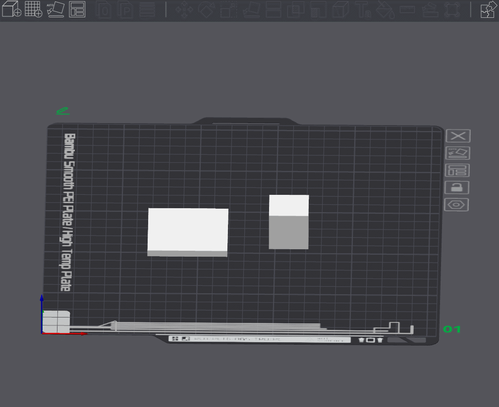

I have a model that has no flat bottom. So I want to create a bottom. But I can’t seem to slide the object on top of the rectangular cube I added. The z-axis does not seem to work, to raise it and then slide it on top of the cube.
Ideas?

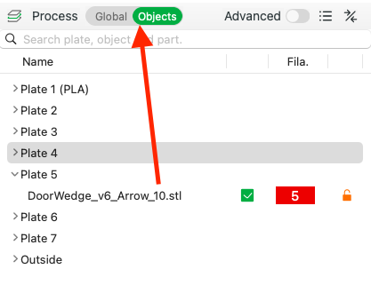

  • Move to the objects view.
    Screenshot 2025-06-11 at 01.13.30
  • Navigate to the plate and expand it.
  • Expand the merged group of parts
  • Select the part from the objects list you wish to move up
  • Use the toolbar move tool
  • Either enter a new Z or use the arrows to drag it upward.

Seems you got this far - select multiple objects by whatever method (ctrl click, shift drag a box around them), right click and select merge from the menu. This groups both items into an assembly and selects the entire assembly. Any actions you attempt will apply to this entire assembly, moving 1 part will movr all parts.
To enable you to stack them on each other you will need look in the left pane and make sure you are viewing Objects, not Global. You should see an assembly with the individual parts listed. Select just the part you want to move and choose Move (M) in the menu bar at the top. This will enable you to manipulate the Z axis position with it falling down to the level of the build plate.
