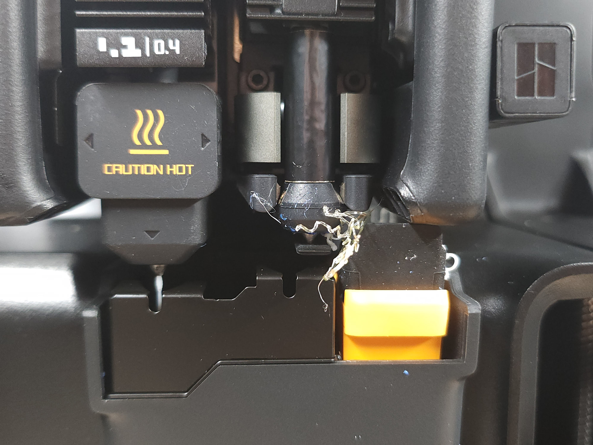

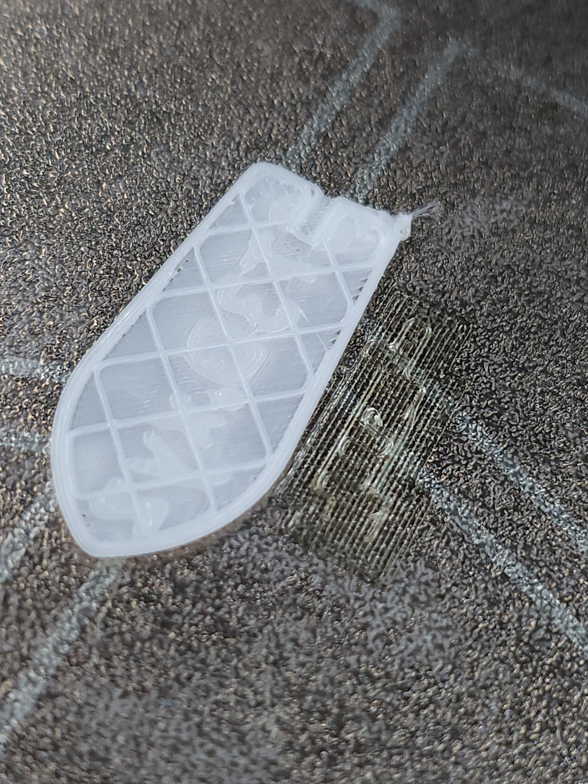

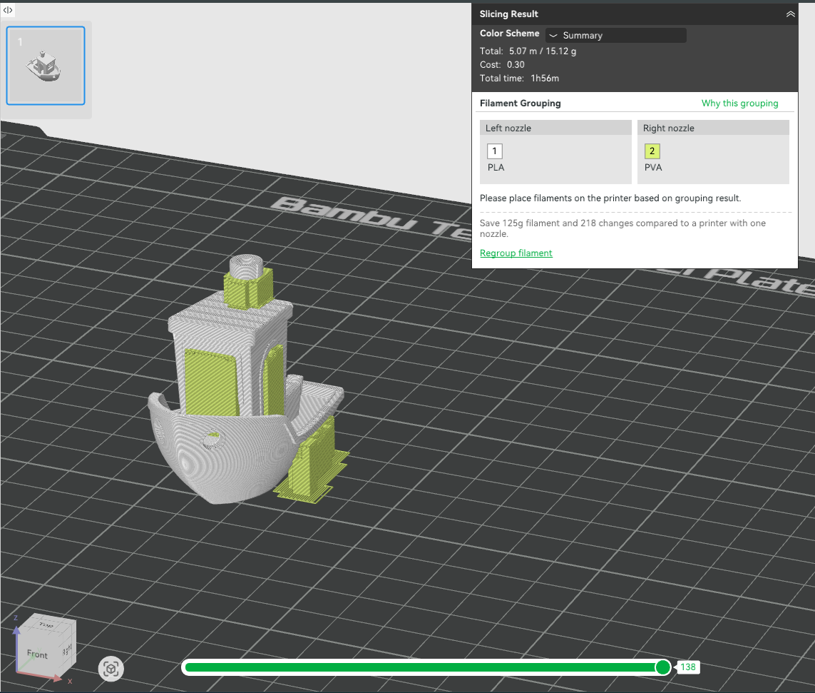

I have been attempting to test print with dual extruder a white PLA Benchy with PVA supports to figure out the settings, however the PVA supports continue to fail after the second layer because it separates from the base layer. Pictures of fail attached at the end.

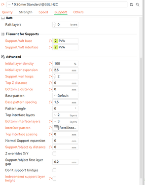

I’ve attempted to slow down the print speed and decrease base pattern spacing. I use a glue stick to help with bed adhesion. The bed and nozzle temps are within the parameters for the PVA (Sunlu PVA on Amazon). SS of settings attached.

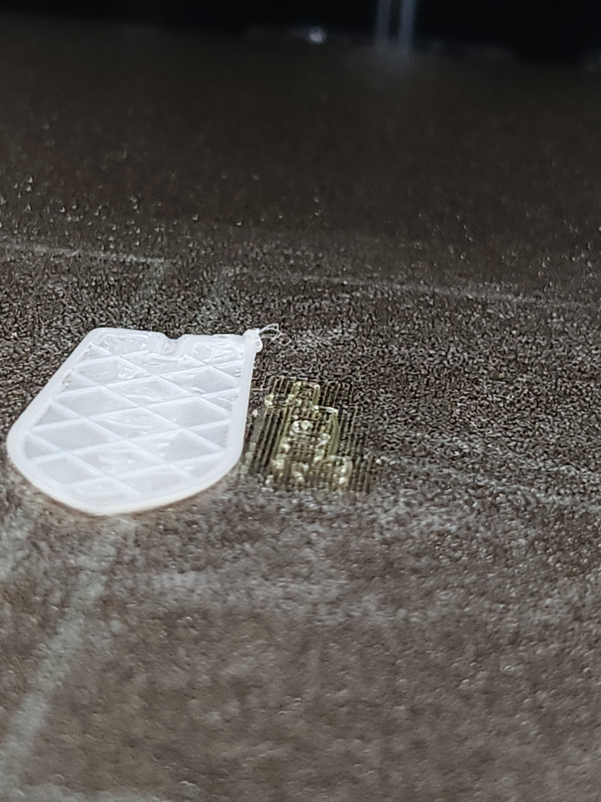

When I was watching the first couple of layers I noticed that after the base layer was printed, the first layer of the support pattern would print, but not bond to the base layer. When the print head came back to print the second layer of the support pattern it would detached the previous layer and make a mess.

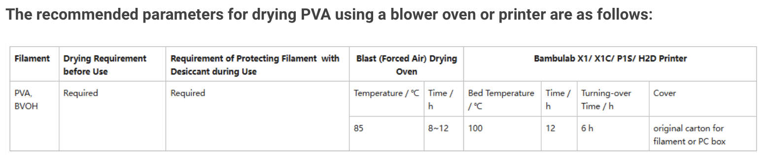

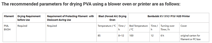

how much drying did you do in the AMS2? bambu lab calls for 12 hours at 85C which is higher than the AMS2 Pro can go
i picked up an AMS HT which goes to 85C for exactly this requirement of PVA

Hi guys! Thank you all for your input! Just wanted to update and say that with the comments (and more research) I was able to determine:
  • I didn’t have nearly enough desiccant, so I bought some renewable kind
  • Drying the PVA with the desiccant inside the AMS wasn’t actually drying, so I pulled the filament out, dried on the print bed low and slow (35C for 15ish hours because I wasn’t at the office to flip it half way) and then swiftly loaded it back into the AMS after
  • Needed to turn off the part cooling fan! It was cooling the PVA way to fast to be able to adhere the layers.
  • Some other small changes to temperatures and speed, especially when trying to print PVA onto a PLA surface.
