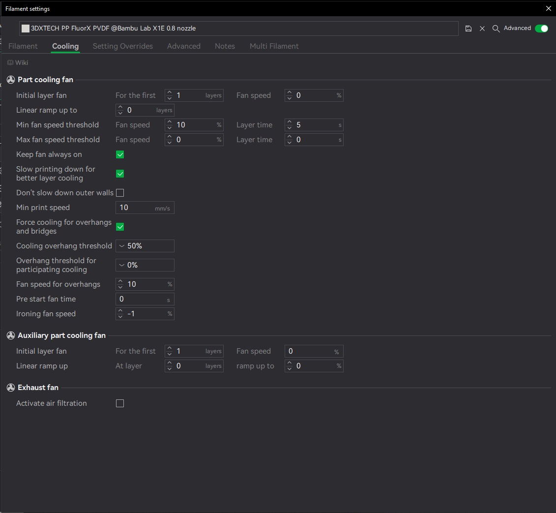

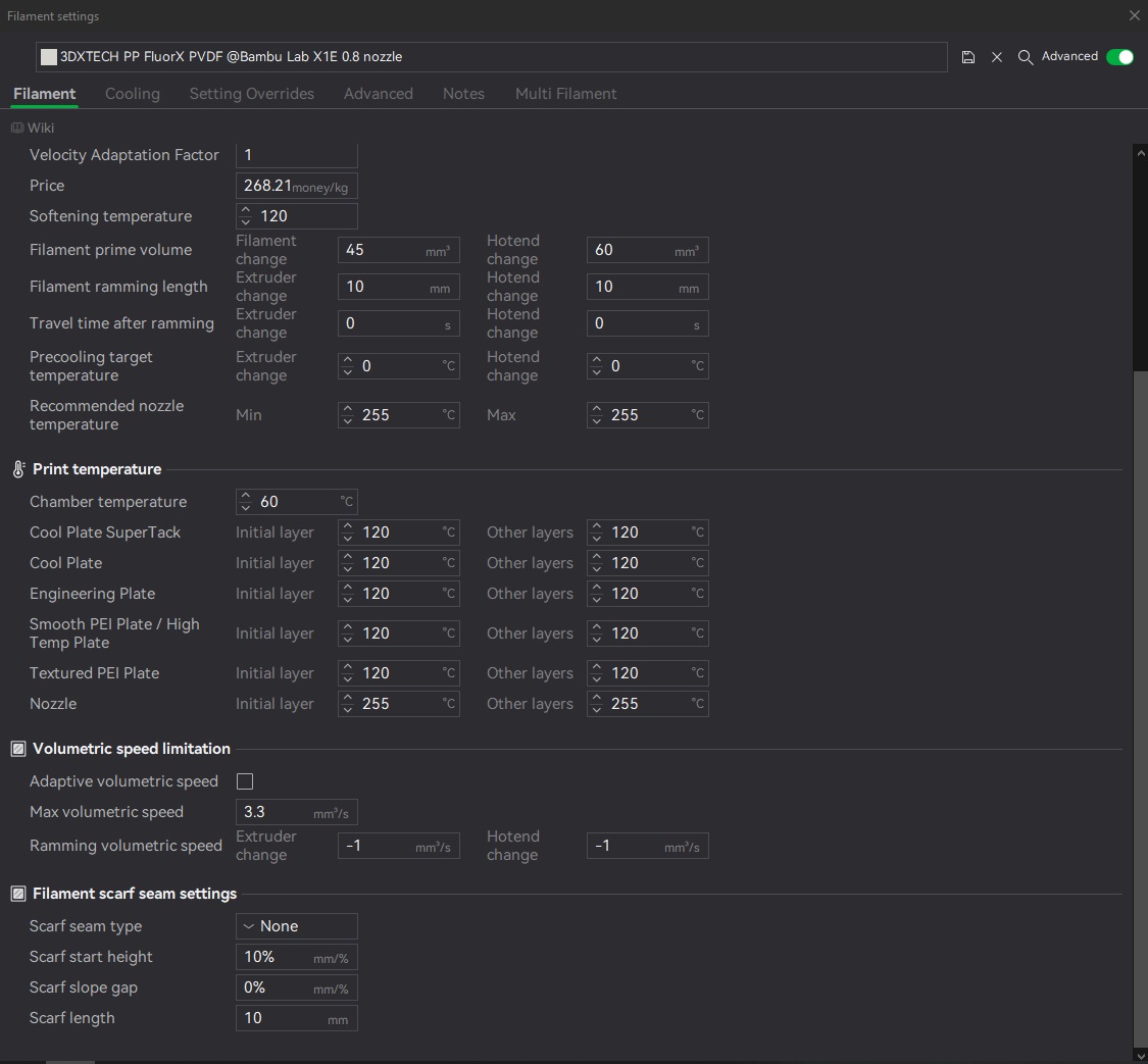

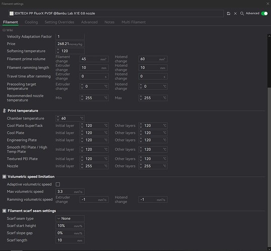

This are my print settings in the filament (direct copy from my notes:
//Non listed values default
Filament:
Type: PP //generic base to work from
Vendor: 3DXTECH
Filament Ramming Length: 10
Flow Ratio: 1.05 //testing, above 1 seems to make no difference in test cylinder
Density: 1.71
Shrinkage: 96 //Correct when flow ration was .94
Price 268.21
Softening Temp: 120 //When set to 151 seemed to elephant foot the hot end feed
Recommend Nozzle Temp: 255 //both
Chamber Temp: 60
ALL Bed Plate Temp: 120
Nozzle: 255 //both
Max Volumetric Speed: 3.3
Cooling:
ALL fan speeds set to 0

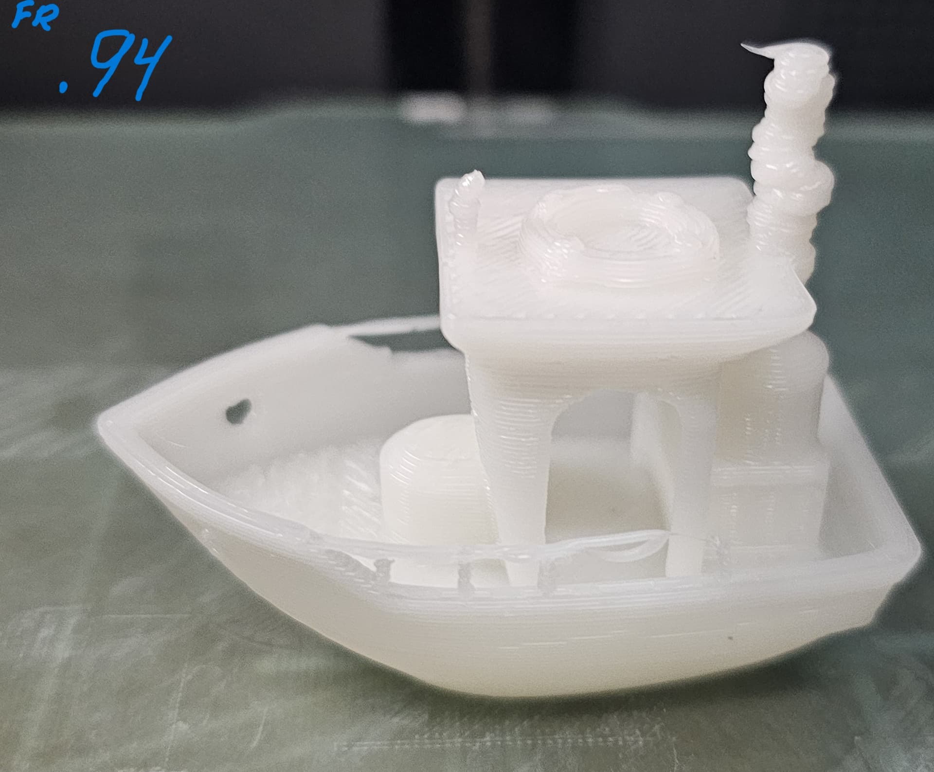

PVDF being amorphous really holds onto the heat, thats why the chimney and small details look that way. if you want to do fine details you may have to adjust your minimum layer time to give it time to cool down. I haven’t printed PVDF on a bambu yet, but have used it in the passed and it had a rather steep learning curve to get it right. For our application PPGF was way easier to print and still gave the chemical resistance we need.
Yup figured that out. Now have 3, 8 dollar benchys lol. Finally was able to make a profile. Never added the responses back about it since their seems to be no users interested in printing with pvdf.

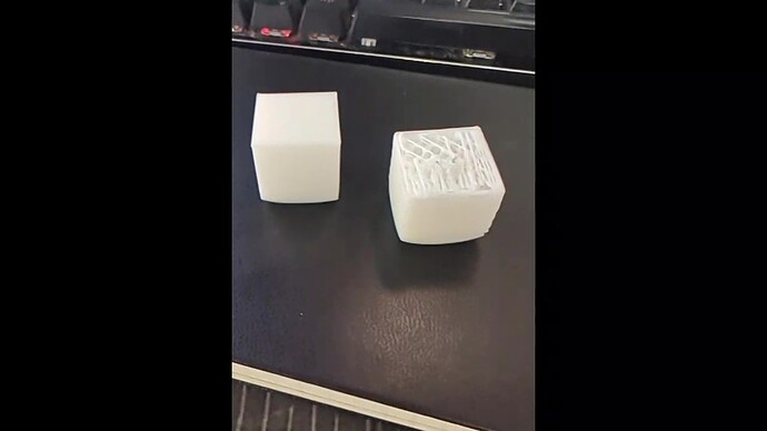

first basic test on x2d, which i put settings back to. plate temp 100, flow 1.5 mm^3, fan at 0 after layer 3 fans at 40… Camber set to 90
plate temp 120, flow 3.0 mm^3, fan at 0 after layer 3 fans at 0… Camber set to 60
kinda side comp…
0 gap brim cube ripped away
