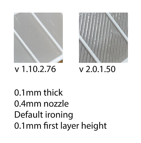

I noticed a huge drop in quality for the first layer of a technically special slice. By that I mean… what I’m doing is a bit unique but should still be within the printers capabilities, but may be filament-dependent in terms of how well it comes out.

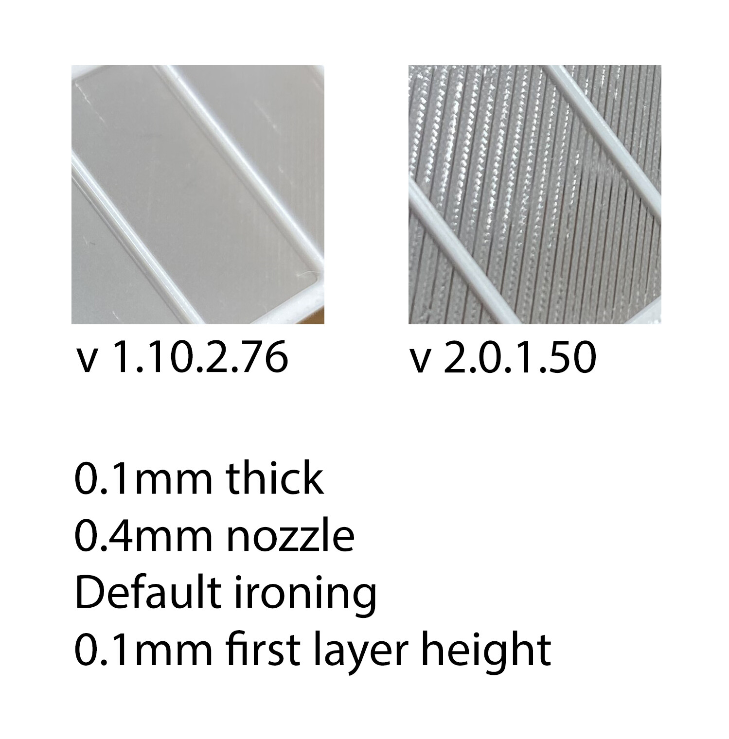

I’m printing a thin feature - 0.1mm thick part - and ironing that layer - with a 0.4mm nozzle. ALL of my test prints with v1 came out identically. I updated my software to 2, and this first layer started to print horribly - the individual extrusions now have a gap between them. I installed 1 back on my computer (alongside 2) and printed - it printed as before.
I reviewed the default settings - but nothing changed between the two besides the version of BambuStudio.
Obviously, it is a newer version and filament settings have changed - but comparing those besides the new ramming parameter, nothing else seems to be different.

Either downgrade to an older version or do a printer reset and redo calibration. A few users experienced the same issue.

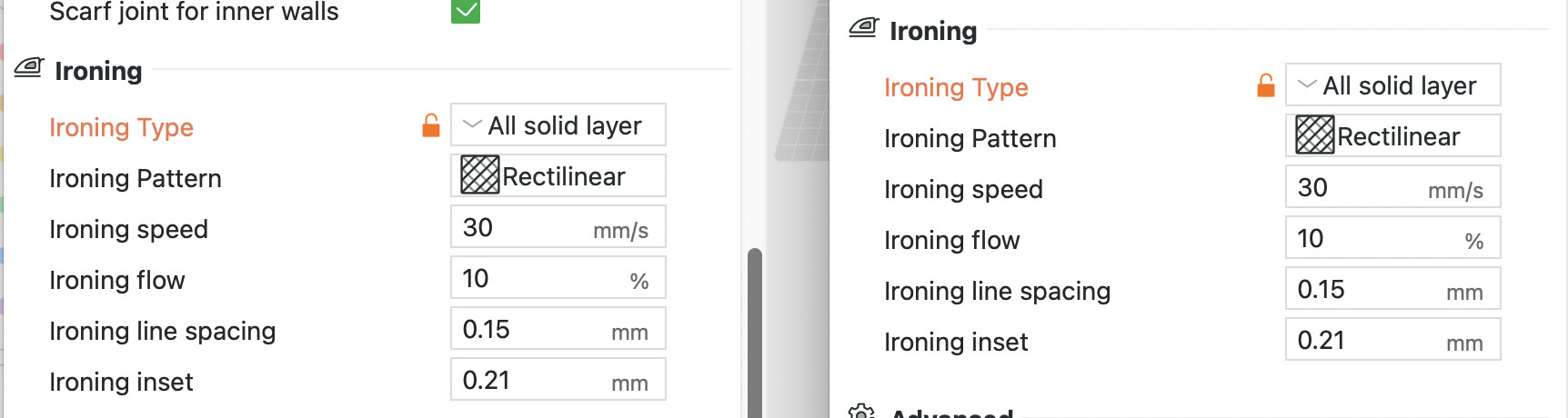

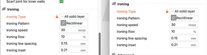

Try to adjust the ironing flow, i think they dropped from 20 to a default value of 10 :thinking:
Ironing settings were unchanged between versions:
Printer reset? I’m wondering what you mean - I don’t see how resetting the printer/calibration would fix this (but I’m willing to try).
And - yes - downgrading fixes the issue… but I can’t reliably expect users to downgrade to v1 if they want to print this with the same quality in v2, I may have to rethink this design… but I was pretty excited with my results.
