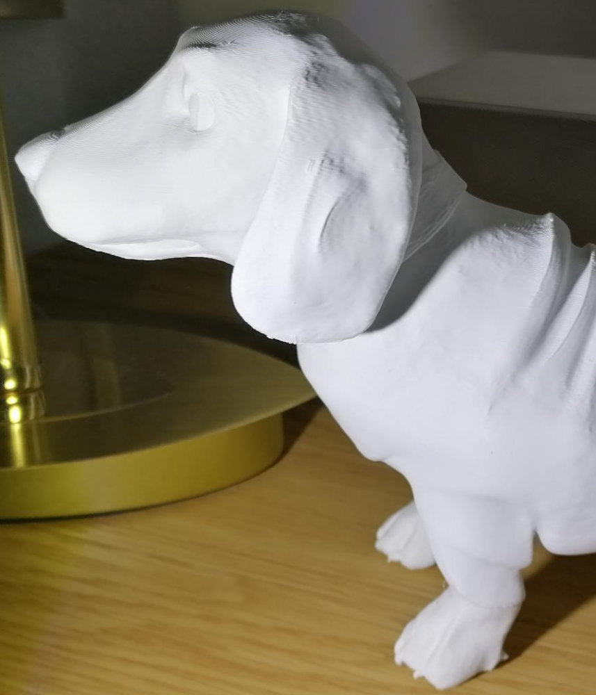

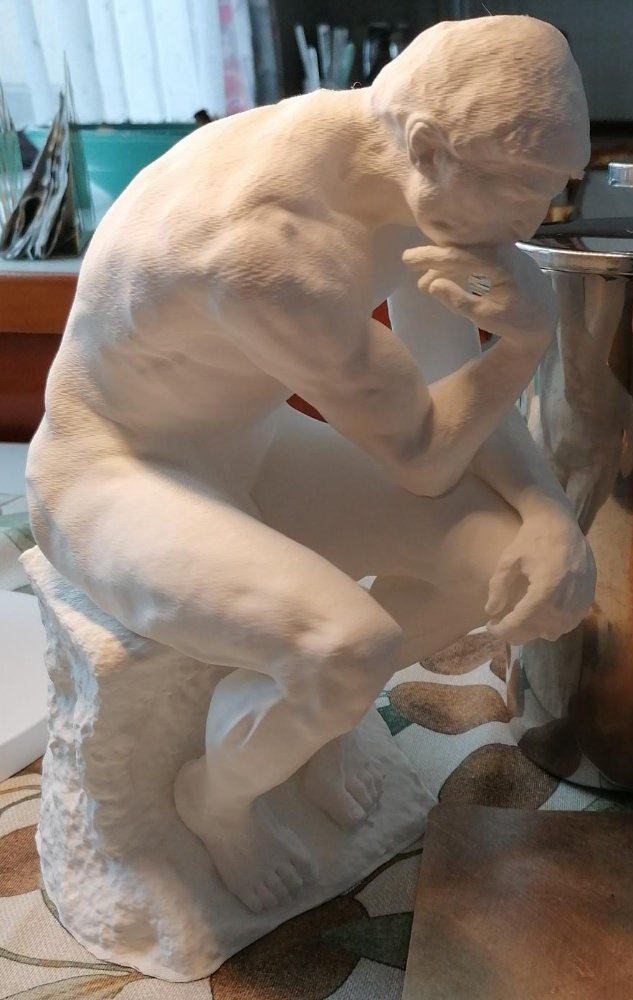

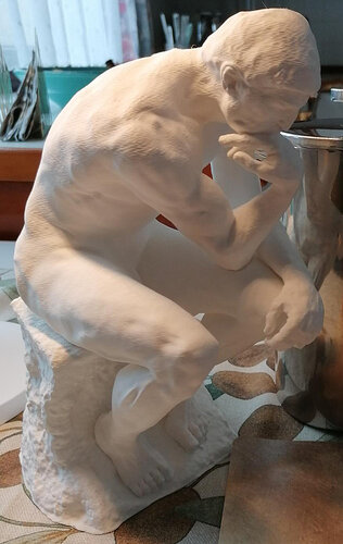

I’m printing some large models that get quite heavy (300+ grams) and I’m getting vibration artefacts later in my prints as the printed model is getting heavier.
In the attached pictures, the bottom starts smooth then more ringing starts to show up higher in the print.
I suspect it’s the A1’s heavier loaded bed not matching the vibration calibration values anymore, which was done when the bed was empty.
I’m already printing quite slow, but this is probably something I have to accept when using a bedslinger, but my idea for a solution is: Would it be possible to get a firmware option to redo the calibration maybe every 50-100 grams?
