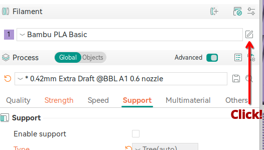

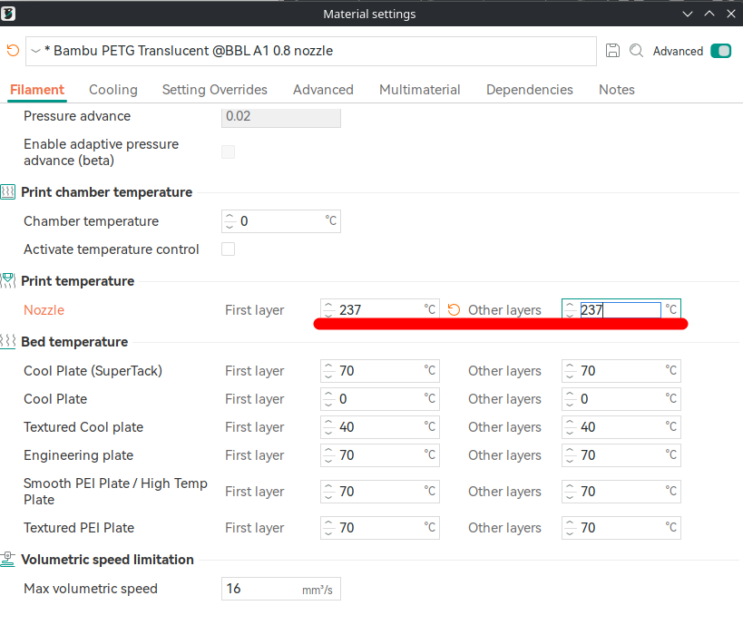

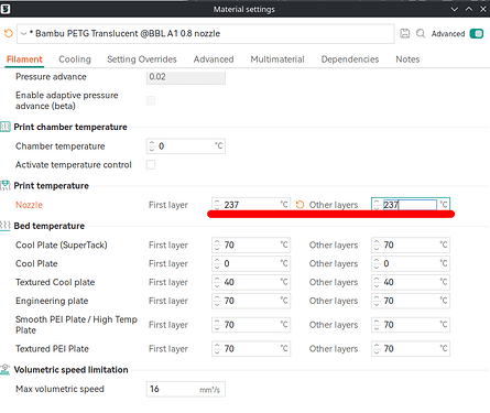

You can test this by editing the filament in the siler and having it do a weird between number (say your filament prints at 220 to 240C; if you edit the temperature to “237C” like in the image below you can just check your printer and see its printing at 237C).

Ok so that’s how you change the nozzle temperature. The only way I figured out how to do it was to wait for it to start printing and then change it at the machine. This is much smarter :smiley:
