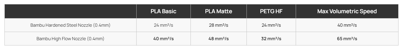

I took this screen clipping from the Bambulab Store product listing for the H2D HF 0.4mm nozzle:
(source: Bambu High Flow Hotend - H2D | Bambu Lab USA Store)
I think I understand the meaning of the first 3 filament columns, but what is the meaning of the last column?
It is the maximum amount of plastic a printer can extrude per second, typically measured in cubic millimetres per second (mmÂł/s).
Right, but doesn’t it depend on the plastic? That’s why the first 3 columns makes sense. The last column doesn’t name a plastic, though, so what does that even mean? Is it the theoretical maximum speed that the extruder can push a 1.75mm filament, assuming no resistance at all? For example, with the hot end removed? No, it can’t be that, because the difference is due to whether the hotend is HF or not.
It represents the highest possible flow rate of filament through the hotend.
It helps to prevent issues like under-extrusion, where the printer fails to deposit enough filament, leading to poor quality prints.
Bambu Slicer uses the value to determine the maximum speed at which a print can be performed without exceeding the hotend’s capabilities.
It is a value based on the printer and the hot end assembly as a whole.
This is why the HF nozzle has a different value, it is capable of receiving material faster than one that isn’t.
Since I dont see different ratings for different nozzle sixes, im assuming thats how fast the extruder could theoretically push filament with no resistance(max speed of the extruder servo)
It wont let me edit my post but i would think .2 would be different than .8 nozzles
Based on the speed of the h2d and the x1c with its nozzle rating, this 65 has to be theoretical.
Here’s my opinion on what these numbers mean. It is the highest theoretical limit of the nozzle’s ability to transfer heat into liquid plastic under optimal theoretical conditions. I believe this is based on the inner surface area and the wattage of the heater cartridge. Nothing to do with the ability to actually use that much plastic and have a reasonable outcome(at least with a 0.4 nozzle.)

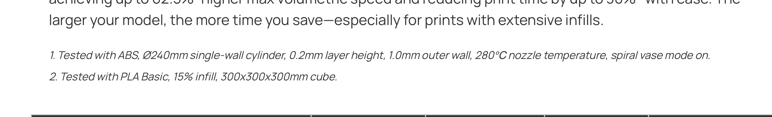

I see a few others have explained it already. Just wanted to throw out there that I’m pretty sure they use ABS to test the max volumetric flow rates.
Why are you pretty sure? Does it align with what you measured?
Most speed ratings on equipment that manufacturers put out are tested using abs.
The single wall cylinder print using ABS notated in number 1 is how they got the max volumetric flow rate
Number 2 with the pla cube is how they figured the percentage of time savings in the paragraph above the chart on the website.
I don’t print ABS and rarely do vase mode cylinders, so I may never see that flow rate.
Very interesting! The quote is taken from the same link I posted in the OP.
At least on first blush, I think maybe you nailed it. :clap:\
Assuming that’s the answer, wouldn’t you agree they should have labeled that column as ABS though?

I am confused; you wanted to know what Maximum Volumetric Speed means, specifically concerning the last column, which is labelled Maximum Volumetric Speed (the same thing).
Things veered off to trying to work out if the last column means a specific material, which it doesn’t. Nothing in the notes 1 & 2 relates to a direct correlation with the last column, simply their explanation of their testing regime.
Nope, for the reasons above.
That’s not the answer; that is a testing note about how they performed their test.
You had the answer.
You had a follow-up to the answer.
Now you have linked a reference to a testing note and postulated if there was a correlation they failed to write (as in the material), there wasn’t.
They could have selected ASA as the testing material, but it wouldn’t have made the final column ASA-related any more than it currently makes it ABS.
