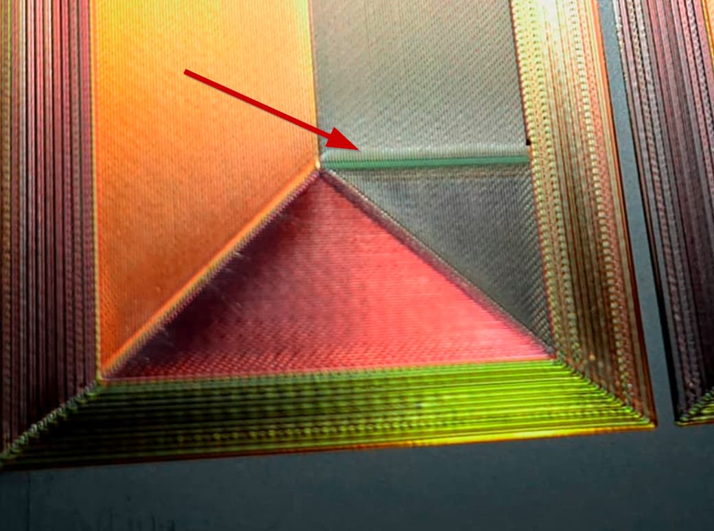

I have an X1-C and I’m unable to move forward with my current project because there are random seams appearing in very conspicuous locations on nearly every print. I don’t mean random like the “random” setting. They are neatly lined up, but they aren’t the seams that show in the slicer preview, which are tucked neatly into the corner. In fact, they do not show up at all in the preview.
If I do three identical models on the same plate, usually one of them will be good and the other two will have a seam appear, both in different locations. If I delete those two and clone the good one (even though they are all clones to begin with) the seams will show up again, but in different locations.
The only thing I can think of that may be useful to mention at this point is that all of my lower layers and infill are monotonic lines/grid, but the top layers are concentric. I don’t know why this would create any problems, but I’m putting it out there anyway.
This is my own design, created in Bambu Studio. It’s just a primitive cube that’s been stretched, flattened and has beveled edges.
4 wall loops, 3 top surface layers, mostly .2ish height, .42 width, silk PLA (but it happens with any filament). Again, the problem is on the top layers only. The bottom surface is perfectly clean.

May I assume that you are referring to this horizontal line?
A picture doesn’t really helps us help you. There isn’t a lot to go buy here. This could be caused by many factors and without access to the actual model, it is very hard to diagnose. If you care to upload a copy of the offending 3MF, it will help us help you. Outside of that is pure guesswork.
So while we’re “guessing”. If you could show a screengrab of what the model looks like in the sliced window, that will say a lot about the design intent.

Again, this is all random thrashing without a good working theory and without seeing how the model sliced or how the model was intended to look, it’s hard to help you. Also, silk is the worst filament to photograph to see what is happening. Have you tried to use a monochromatic color? That will show where the flaws are much more readily with less guesswork.

This is an old thread but I have the same problem and I know what to call it: Top layer seam. I don’t know how to fix it. It’s the seam of the lines making up the concentric top surface pattern. UNFORTUNATELY seams on the top layer are not affected by the “Seam position” setting, nor by painted seam placement. I haven’t found a way to reliably control it.
This seems like a missing setting. It would really only apply to Concentric and Spiral, and other loop-based fill patterns. But it would make a big difference to the top finish on those, so I think the setting should be added.
