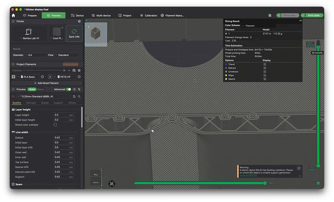

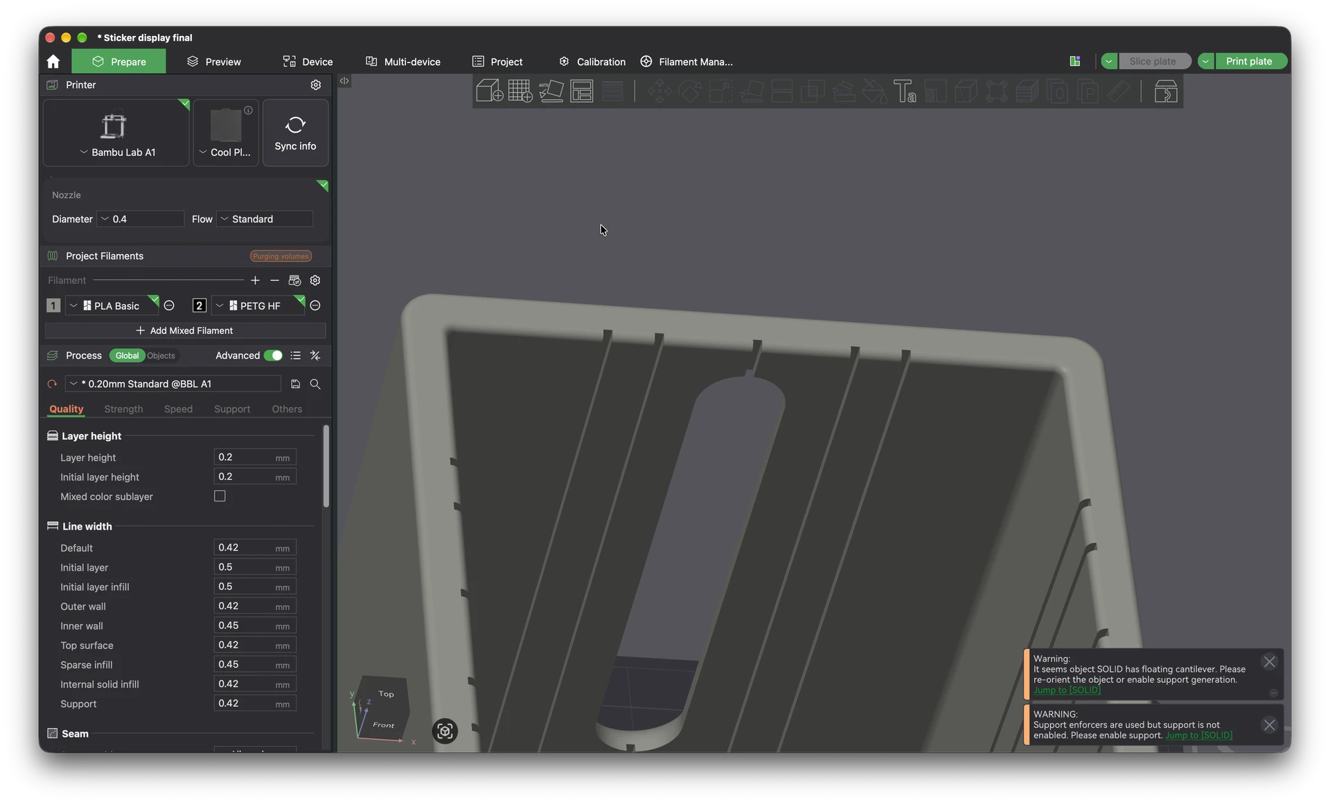

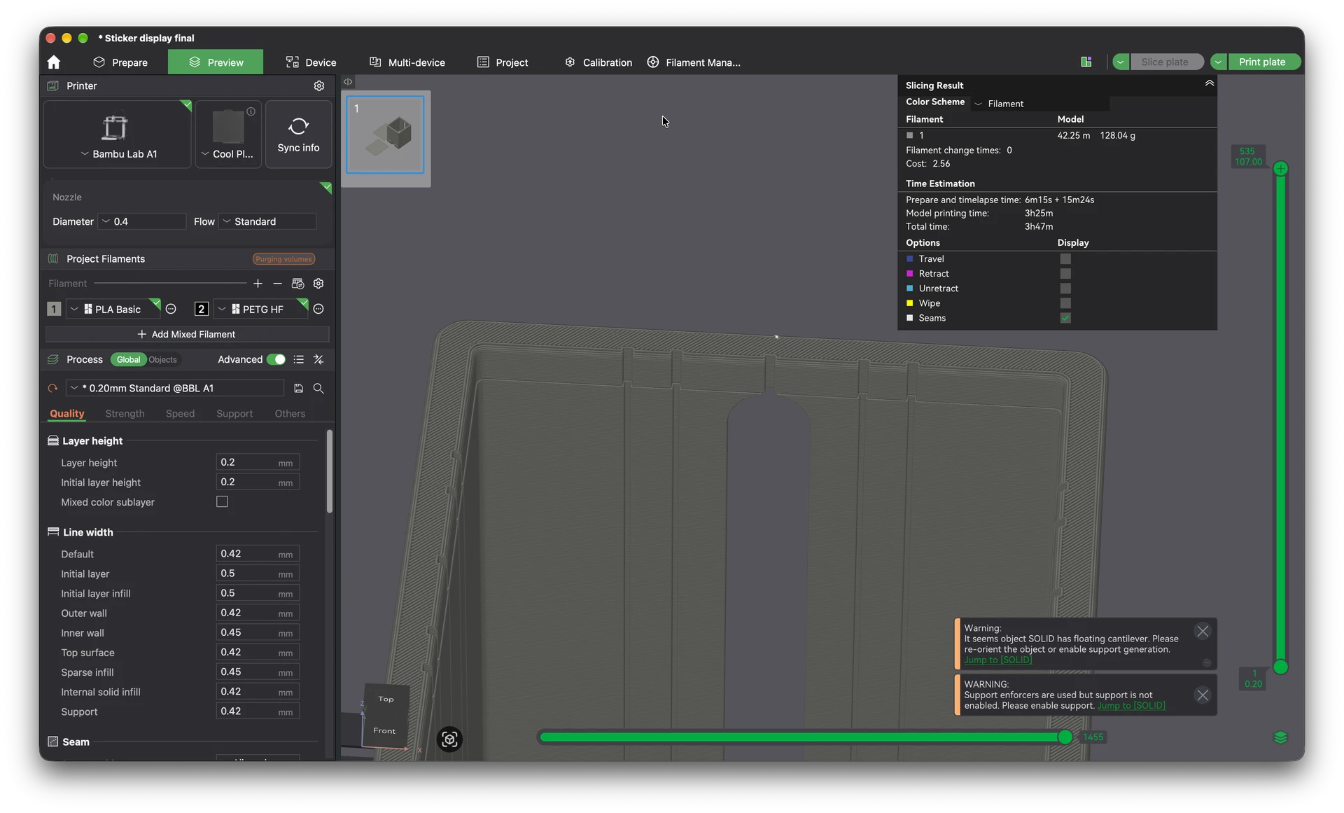

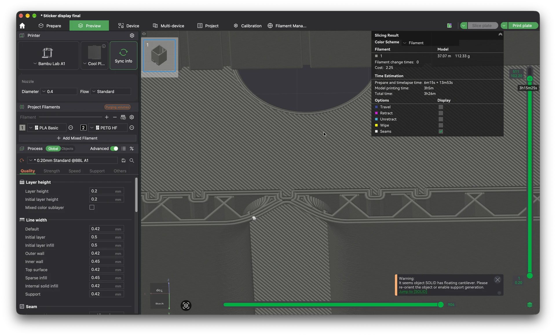

Random width changes
  • Printer model used
  • Slicer settings used
  • Type of filament used
Hi Anthony,
That’s a bit of an odd post… you’re expected to replace the instructions with the actual information it ask for… :wink:
Do those walls taper towards the top very slightly? The width change could then be where the line width threshold allows for a thinner wall to be possible. If that’s the case and you’re using Classic wall generator, try Arachne.
That’s my only guess w/out more details.
-Max
whoops! :distorted_face: My bad. I was in a bit of a rush, so I actually designed this model myself and I had it to be a constant width. I did notice the change happens at this point, right when the small bridge happens.
