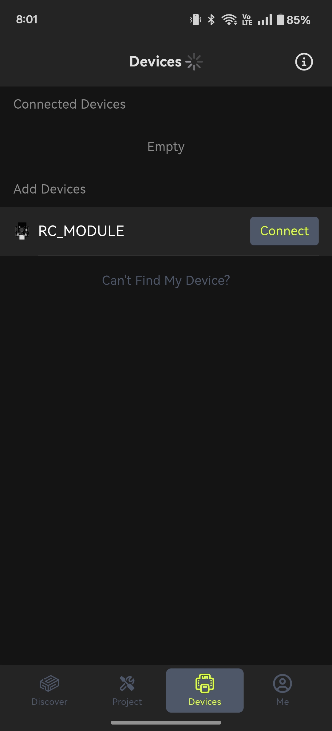

Picture1:
The app recognizes the module.
Picture 2:
I attempt to connect.
Picture 3:
LED is green
Picture 4:
LED goes blue and I get the message on next picture.
Picture 5:
Connection error on RC module

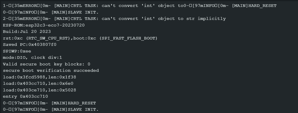

I had the same, it seems that a wrong configuration can boot loop the esp. In my case it has some integer in it where it expected a string. I created the config with the official android app.

Tested both button, it stuck in same state as Gabosky describe. When attempt to connect its static green light then follow by blue light and the app show connection failed.
Seems there is no way to connect at all once you hit the bug.

Same for me, reset doesn’t do anything different it seems. I think the problem is that whatever got programmed into the esp is all wrong. I think the only way to fix this is to flash it via USB the same way they do in the assembly. If only the Cyberbrick software had a flashing option to reset the device with the original firmware.
Edit: I’m trying to see if I can flash it. Looking into the API website.
Yeap, serial monitor seems return same error as topdrob.

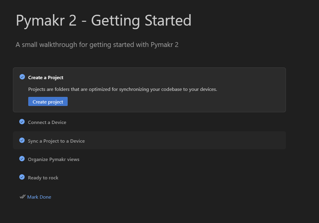

Once setup, follow below steps.
  1. create a project in “Pymakr 2” (There should be a Pymakr2 welcome screen, follow the steps from create project and connect device).
  2. After that, plug in your cyberbrick core into your PC via USB-C cable (Make sure is data enabled cable)
  3. Connect a device, in Pymakr page you should see it listed under devices connect to the device
  4. You should see your device now appear above under your projects, turn on “Start Development Mode”
  5. Mouse over your device below your project folder, click sync project to device and this should upload an empty micropython script into your cyberbrick core
  6. Try connecting via CyberbrickApp
Please take note only try this if you’re comfortable with programming and messing with the script. I could not 100% make sure that it would fix your issue.

If I use any terminal to communicate with device now I get this message:
And this is the message that I get from esptool:
I had tried that erase_flash a first time and it seem to had work or done something, because after that I no longer have bluetooth access.
Then I flash it with the bin file mentioned above:
I had to use the force to get it working. (https://www.starwars.com/video/use-the-force-luke)
Yesterday it wasn’t working, but now is working. Now if I go again, and try to use serial communication this is what I get:
and nothing else a bunch of other stuff should load too. But it just gets stuck there.

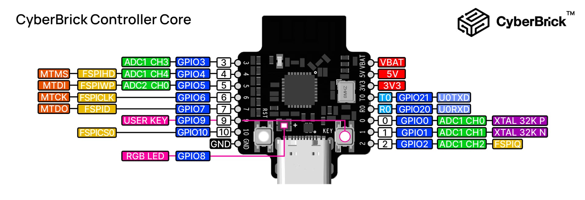

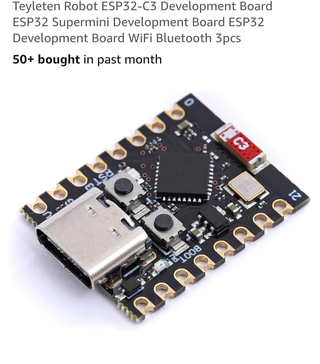

I ordered this ESP32-C3 board from Amazon.
Which is the same microcontroller they are
using for the Cyberbrick controller core module. This should be a pin to pin compatible swap.
I will desoldered the one from Amazon and resoldered into the Cyberbrick module. I will have to flash my own code since there’s no way to flash the original firmware from Cyberbrick.
Unless somebody can point to where I can find the original firmware and download it.
I’m not sure why you’re convinced of that. I wouldn’t expect it to be a pin for pin swap. BL is not known for standardization.
The footprint shown on the Amazon page doesn’t match at all.
Unless you’re saying that the PROCESSOR chip is the same footprint and that you’ll desolder that???!!!
