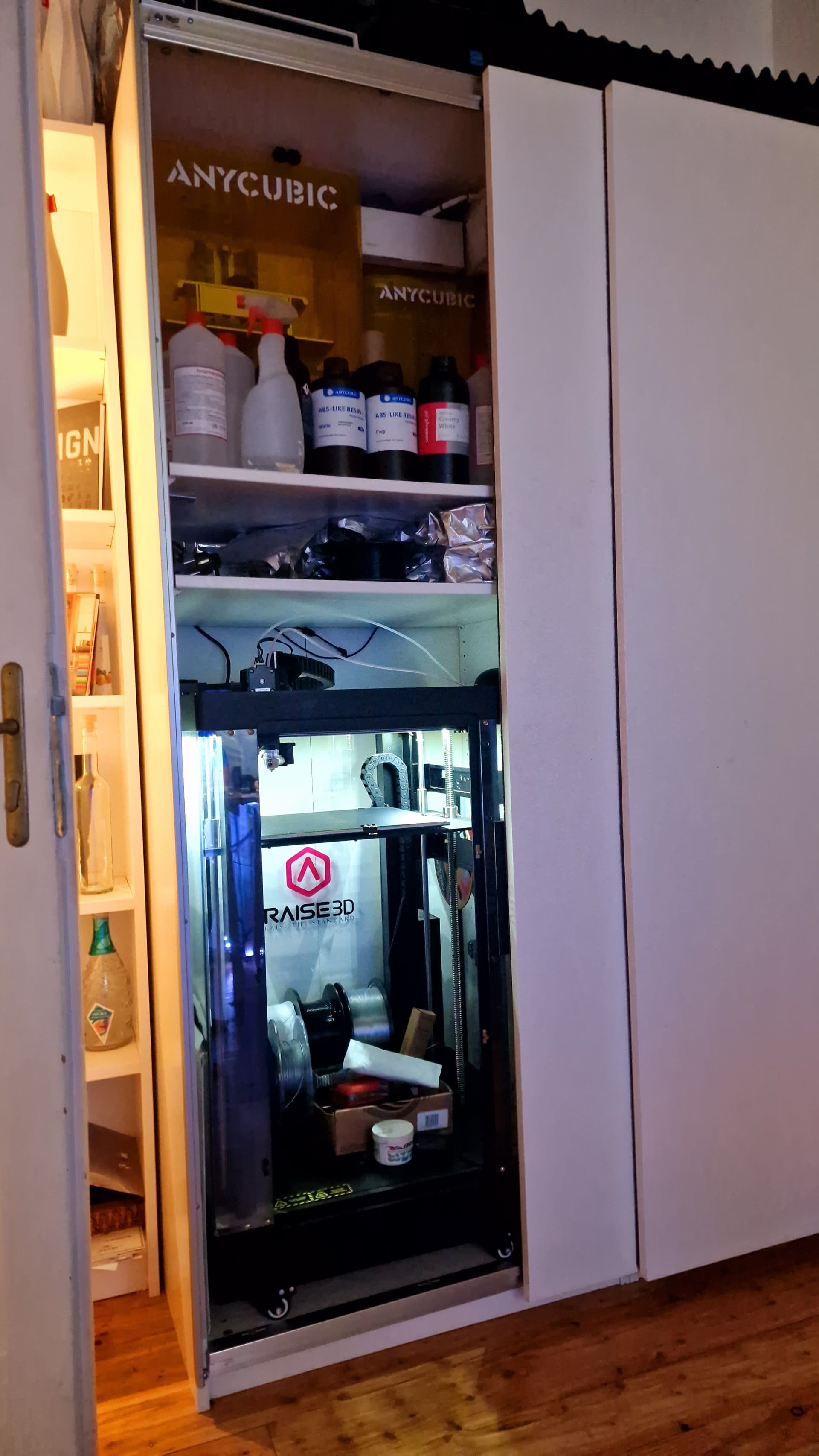

Care to share what you have in mind with the measrements?
You cannot just hide that magnificent 3D printer behind a sliding door?
Please take into account, that you should have a good ventilation above and behind the printer. Even if you only do 3D printing, more so if you have the laser version. I am printing ABS right now. 90 C bed, 60 C chamber and 270 C nozzle produce a lot of heat. The front glas and the whole printer frame are quite warm to the touch.
