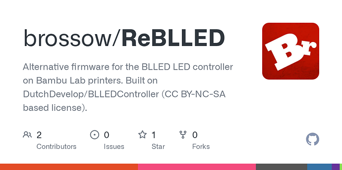

I’ve been running one on my X1C for ages but wanted it to work a bit differently in a few places. I ended up reworking the firmware pretty heavily, so I’m putting it out there in case it’s useful to anyone else. It’s called ReBLLED (“rebelled”), it runs on the same BLLED hardware, and it’s built on DutchDevelop’s BLLEDController 2.3.0 — same license, credit where it’s due.

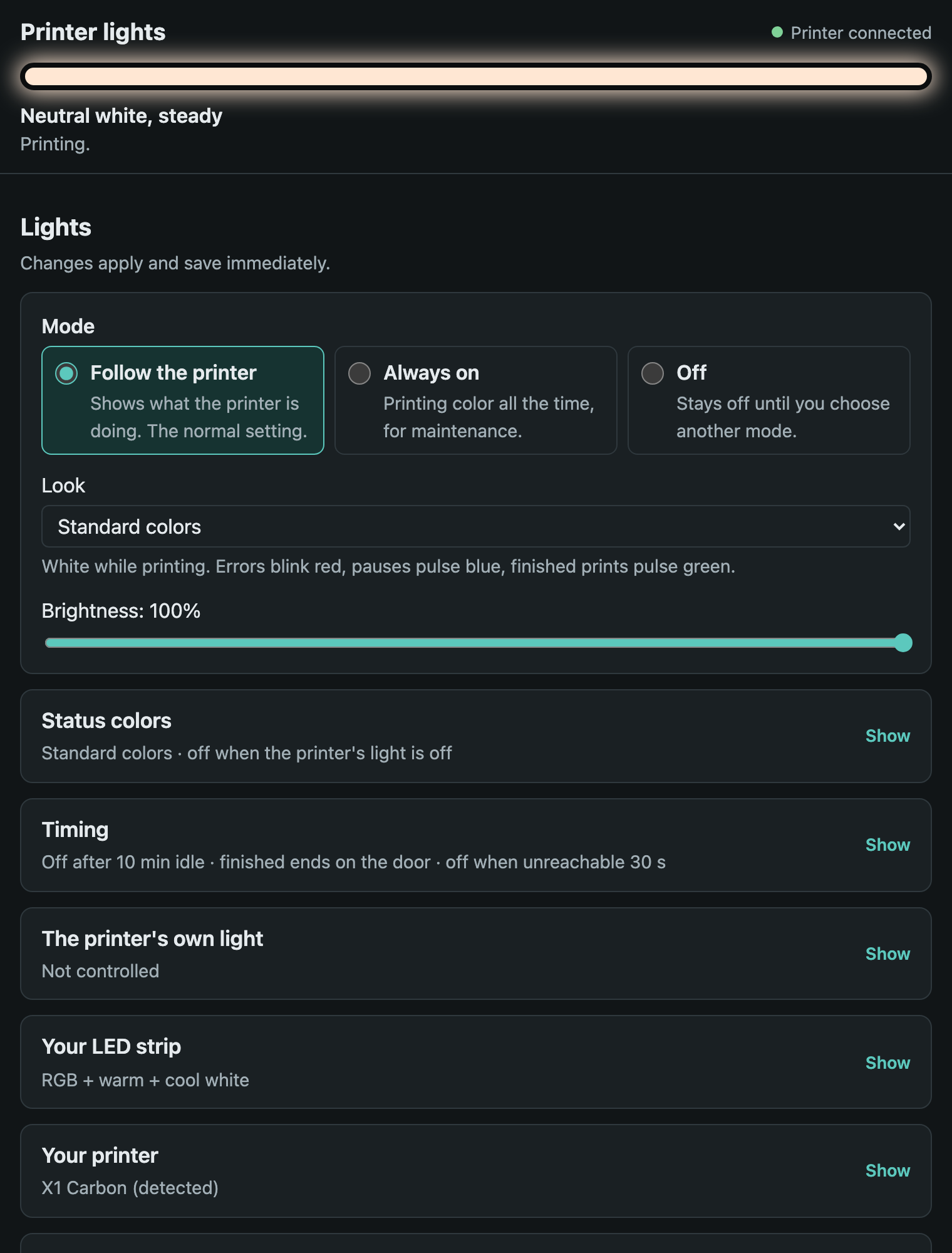

  • New setup page — essentials first, autosave, a short first-run setup, and a status line that tells you why the strip is showing what it’s showing. Works on a phone, in dark mode, and with a keyboard/screen reader.
  • Simpler LED logic — one set of rules, per-step and per-error colors with previews, and the strip stays lit for nozzle cleaning and bed leveling (so the camera doesn’t set its exposure in the dark) but goes off for the lidar steps.

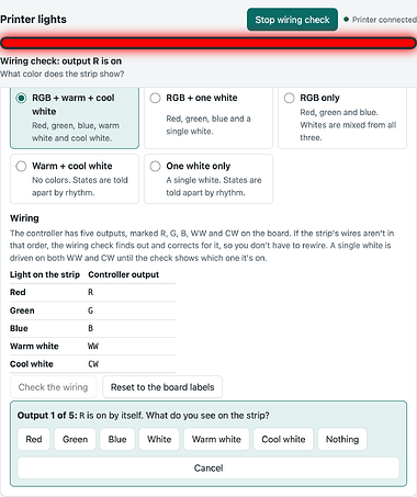

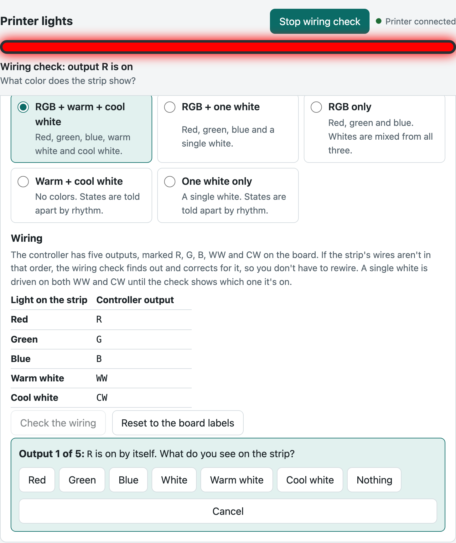

  • Strip types + wiring check — RGB+WW+CW, RGB+W, RGB, WW+CW, W, and swapped wires can be fixed in software.

What it looks like (examples from a test setup — the page follows your device’s light or dark mode; more in the README):
