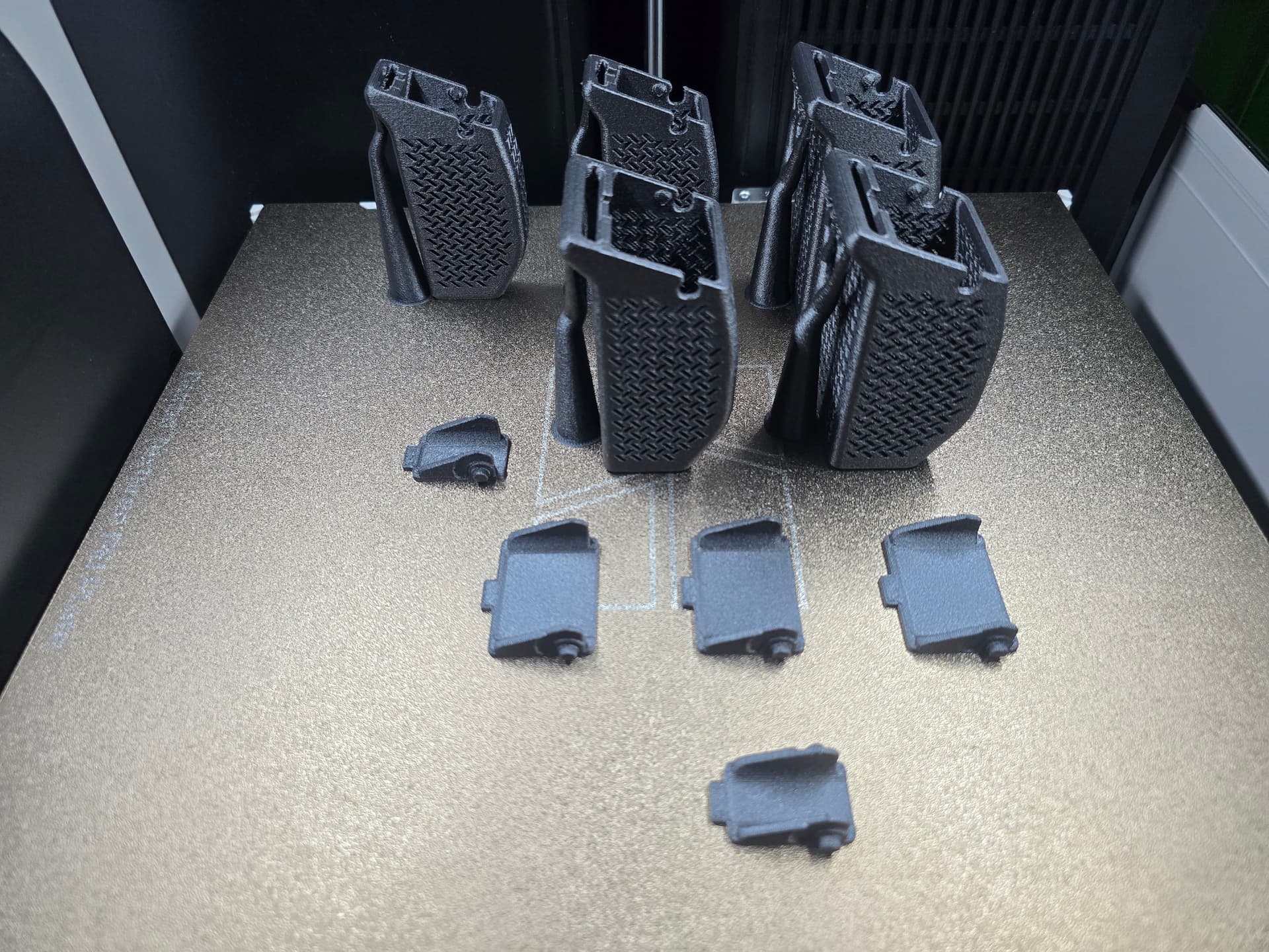

I’m giving it a shot with the Polymaker PPS-CF10. Just printed out some AMS2 desiccant pods. There’re currently in the blast oven annealing. I have some activated alumina desiccant that I will be putting in them. I’ll see what happens in the oven at 210*c when full.

Sounds like we think a like. Just out of curiosity could that be annealed in a standard kitchen oven? Also does annealing have to happen right after printing, or can you do it any time?
Yeah you could anneal it in anything that will get up to temperature. I’ve just noticed that my kitchen oven will slightly very temperature more than my blast oven. So it would be good to check with an independent thermometer to see what you’re oven actually does. I’m sure someone knows a lot more about it than me. But my understanding is that you anneal it at the recommended settings before going up to full temperature and it changes the characteristics of the material. And then the material can usually handle higher temperatures after the initial annealing without warping. I anneal at their recommended temperatures, I shut off the oven and let it cool slowly in the oven until it reaches room temperature. On low temperature filaments I do not like using the oven, as I’ve noticed you get high and low spots and parts warp easy.
