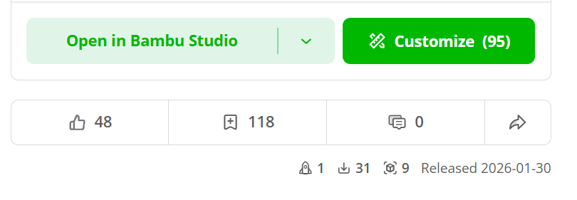

If I see this: 61 customizations but only 3 prints.
I get that not everyone prints after customizing but still, this is something I see all around my models. Like this one below: 95 customizations, 118 have added it to their collections, 9 prints only and no profile rating?:
What hurts the most on the last one is the total lack of comment :frowning:, but that’s something else.
