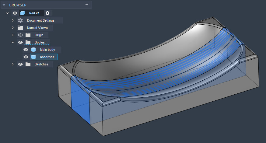

I’m trying to find a workflow to increase the infill density in certain parts of my model and found modifiers are the way to go here. Below is what I have so far, but when it comes to slicing there’s an issue.
In Fusion I have one component consisting of two bodies, the main body and the body to be used as modifier:
In Bambu Studio I set the body to be a modifier:
But here’s the issue. When I set wall loops to 2, i get noting. Setting to 3 gets me 5:
Not a big problem but this is:
Having wall loops on the modifier causes the outer surfaces to have a seam
This also happens if I import one solid stl and use the modifier geometry within Bambu Studio.
So what is happening here and how do i get rid of those outer seams?

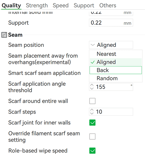

I can’t tell you that, but to help you in the meantime, here’s an idea: Did you tell the slicer where to put the seams?
You can do it automatically, which I don’t recommend in this case, but it’s worth a try, like nearest, back, aligned…
Then, of course, paint in the seams yourself:
In Studio or Fusion, make the modifier shorter by two line widths to fit entirely inside the walls of the main part? You can play with modifier size and wall layers, which can be set to zero if you wish.
Hi Jordy,
I’ve been learning about similar/same issues recently as well. Not an expert, just what I learned so far…
For the surface issue, I’d keep the modifier part completely inside the main part, so it doesn’t touch the surface at all, with a decent clearance (ideally around the same as your top/bottom/side thickness or so).
As for the internal transition… the slicer indeed has trouble separating parts sometimes. Changing the wall count is a sure way, but can create the issue you found with too many walls. But changing the infill should also create a transition. Though w/out a wall it isn’t always pretty. So far I’ve worked around it by just using one wall on the inside part, vs. 2 or more on the outside, but don’t see a way to have it just use one or two walls at the transition point.
Does it help if you keep the modifier object as a “part” instead of making it a “modifier?” There shouldn’t be any practical difference if it’s not touching the surfaces.
Here’s a shot of a couple primitives I threw together in the slicer, the cube is the first/main object with a cylinder added as a part (not a modifier). The cylinder is completely enclosed in the cube. The only difference in slicing settings between the two is the infill density.

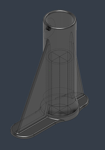

Increasing infill percentage has limited effect on strength. In your case, I would build the strength into the model, by making structural supports, such as using the web feature of the Fusion. It is also simpler than making a custom modifier for use on Bambu Studio later.
@DWdesigns Yes for this model that would sure be an option but to test this workflow I added “internal webs“ as bodies in Fusion and set the infill to 100%:

The webs can be made thin. They will be all walls, no infill. No need for a separate body either. Make it a simple one-body design.
