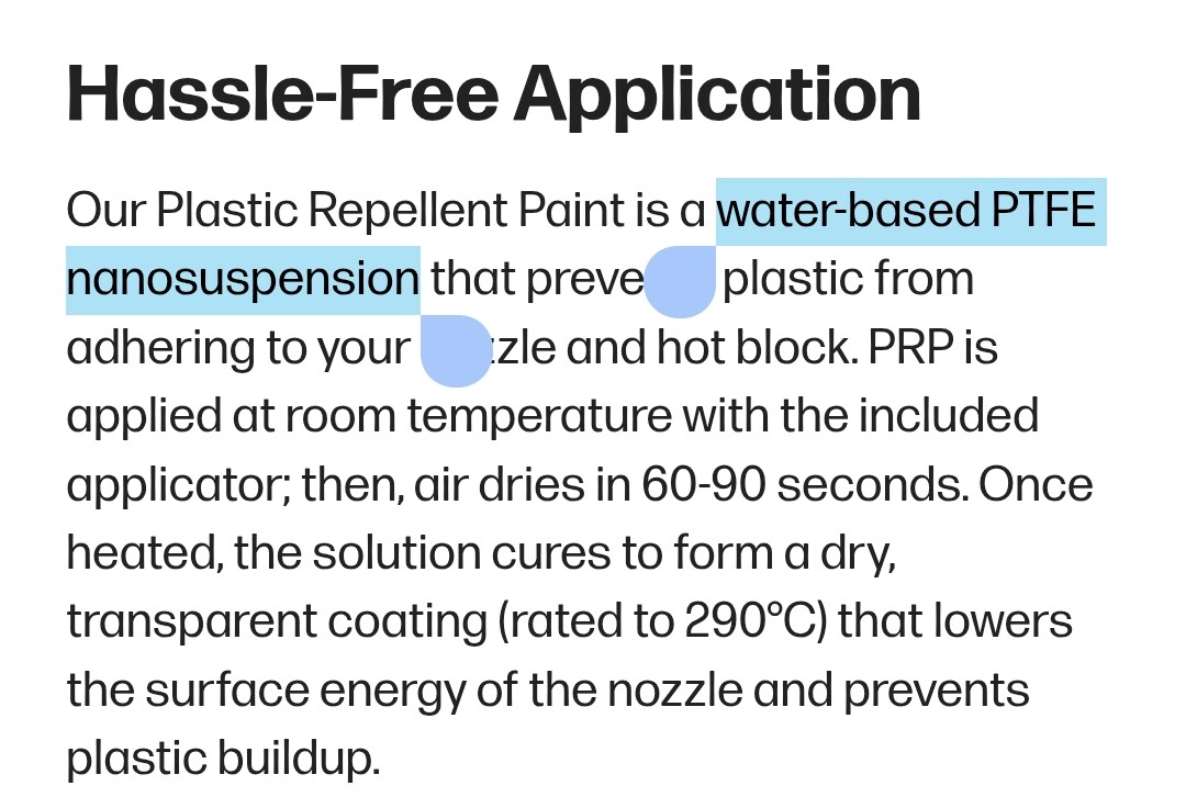

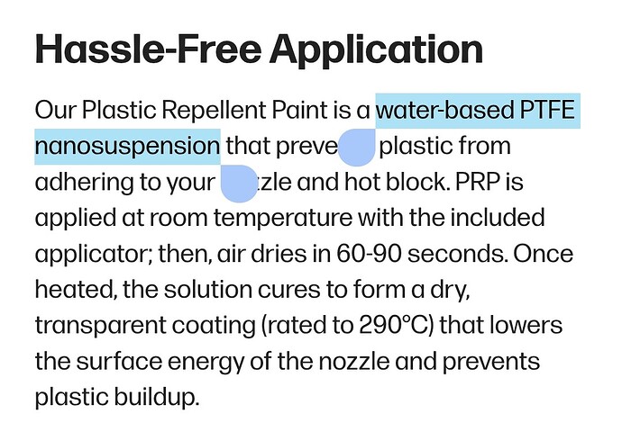

Slice plastic repellant paint
My biggest concern would be; what effect will it have on your print if even the smallest amount was transferred to the filament as it passed through the nozzle? That would most likely occur at the start of the print, so could conceivably affect print to plate adhesion. I may be completely wrong but I personaly wouldn’t risk it.

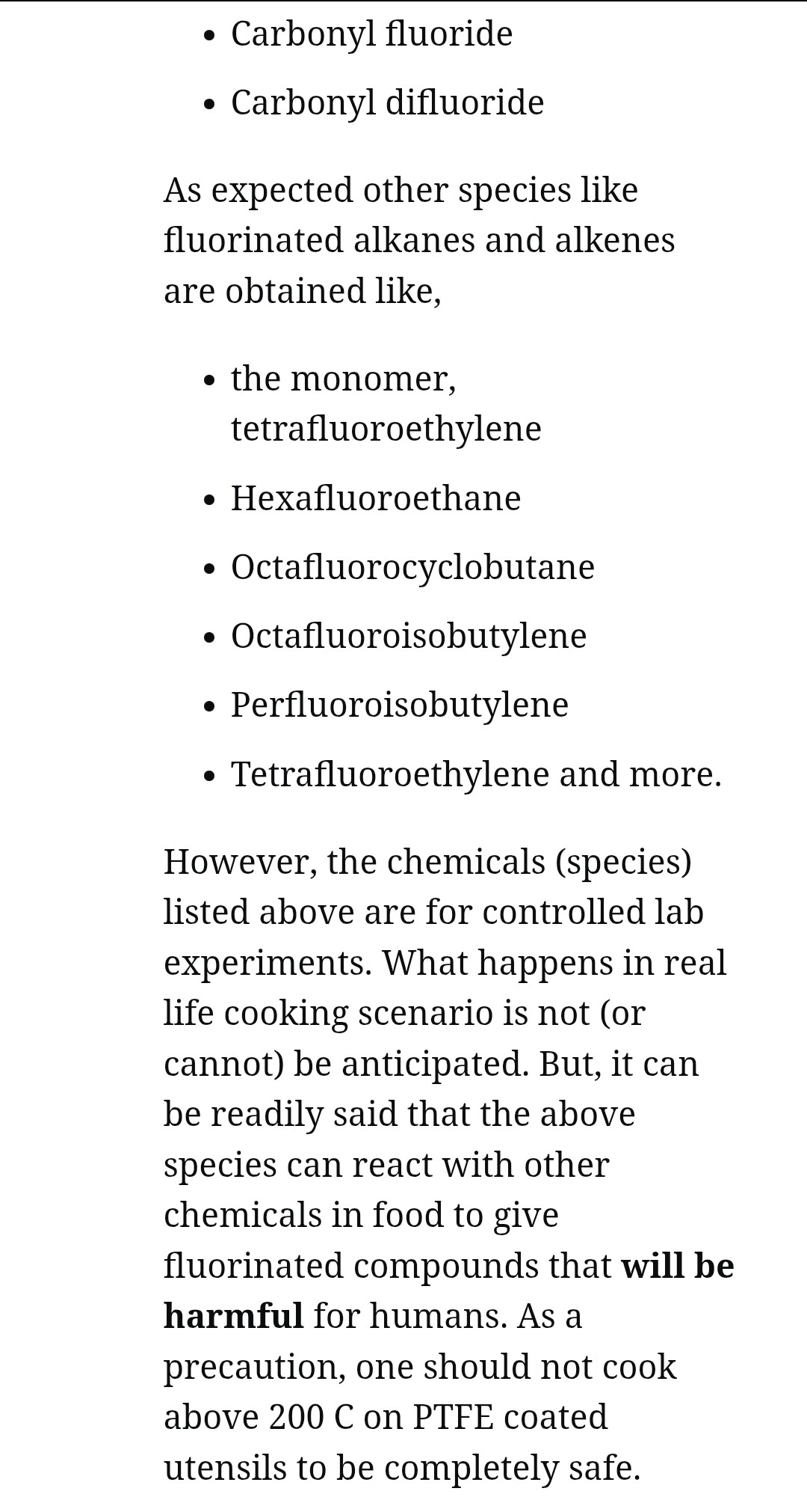

Hold up a minute…
Yeah, that’s gonna be a no from me. Rapid decomp may happen at above 290, but unlike cooking, we keep printer nozzles well above 200 for extremely long periods of time, and without the benefit of a range exhaust.
This stuff shouldn’t be on the market.
Oh, and water-based application of PTFE is a joke. It’s the ultimate low surface energy compound, it’s not sticking to anything it’s brushed into and will absolutely rub off on anything it touches, including prints.
