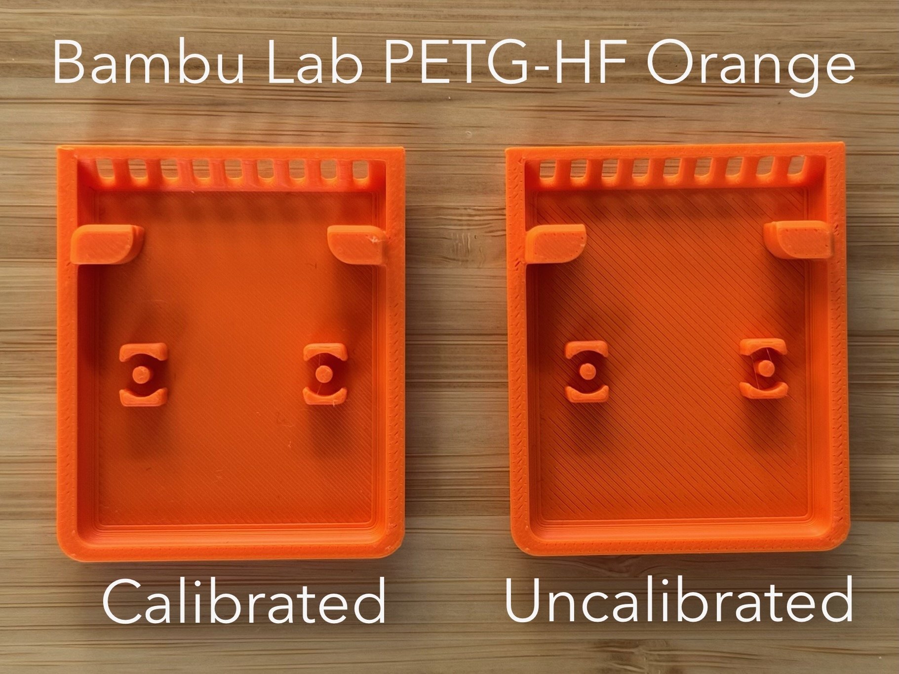

I learned this myself when I first started printing with PETG HF:
Both prints were the exact same model made with the same material. The only difference was that one profile had been calibrated and the other had not. The difference was noticeable right away.

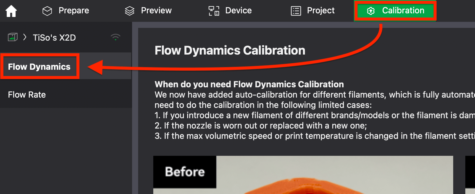

Flow Dynamics Calibration - official Wiki guide here.

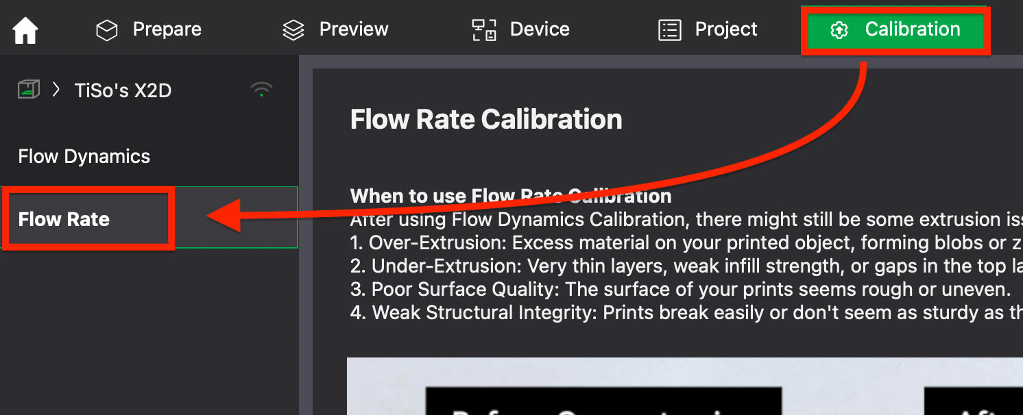

Flow Rate Calibration - official Wiki guide here.
These two are obviously just the tip of the iceberg when it comes to calibration, but they only take a few minutes and can make a much bigger difference than most people expect.

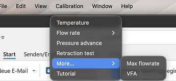

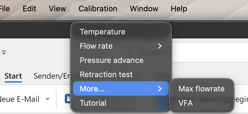

If you want to go even further, you can enable the Developer Options in Bambu Studio’s settings and unlock additional tools and tests for calibration:
I’ll admit that I haven’t really explored those myself yet. Maybe that should be my next rabbit hole. In my experience, a surprising number of print quality issues disappear once the filament profile is actually dialed in.
