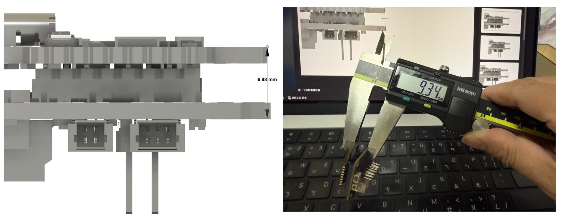

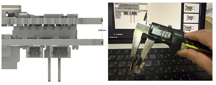

I received the kit today and noticed that the CyberBrick Remote Control Kit has a noticeable discrepancy between the actual assembly spacing and the values shown in the 3D model files.
For example, in the Remote Control Receiver Kit, one of the measured spacing values in the 3D drawing is 6.98mm, but the actual assembled module measures 9.34mm, a significant difference.
I recommend that the @CyberBrick team review and correct the spacing in the 3D files to ensure accurate alignment and avoid potential issues during assembly or when designing compatible modules.

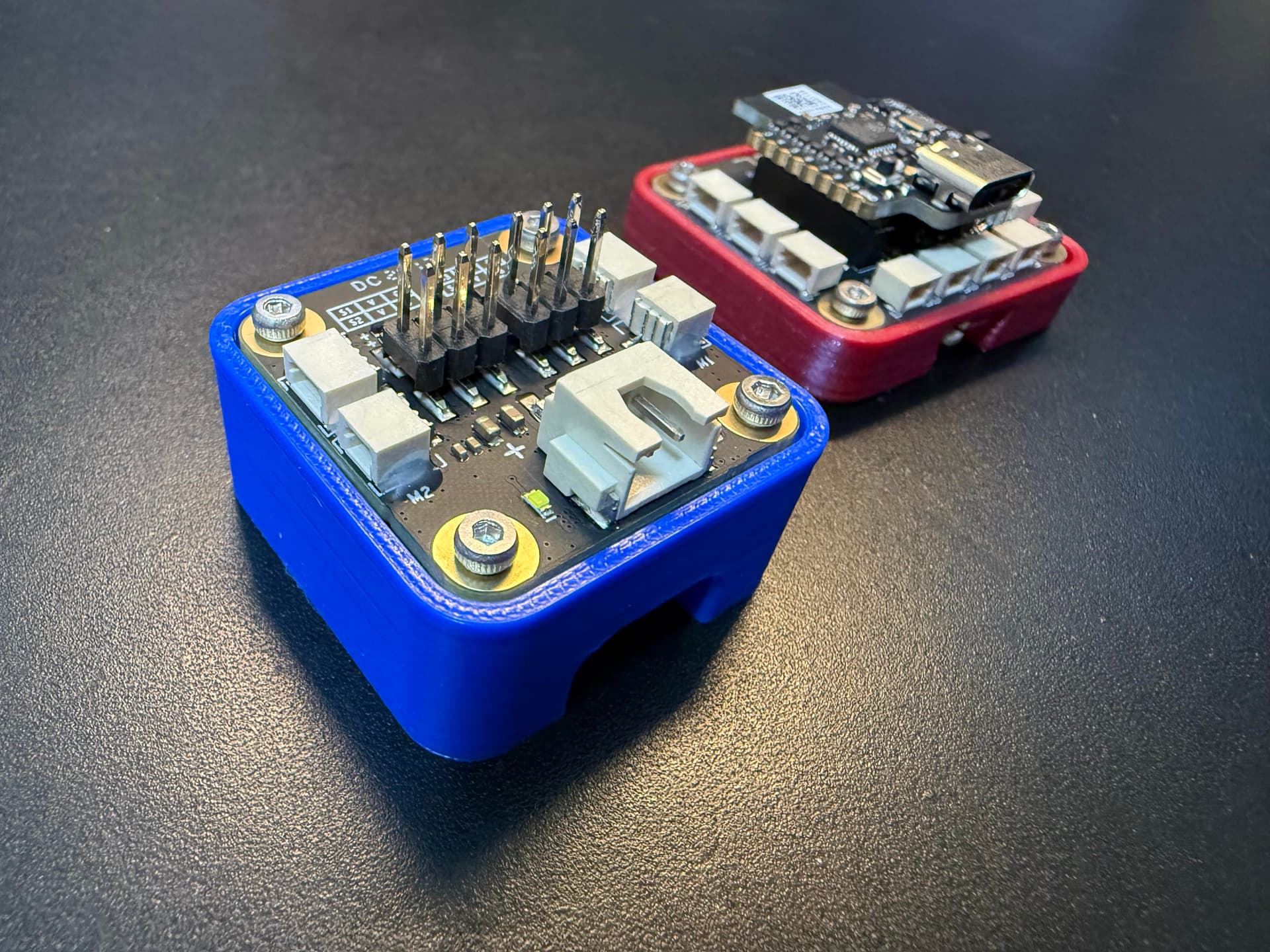

To address this, I’ve updated and corrected my CyberBrick Test Housing - Receiver model.
If you’ve previously downloaded and printed the earlier version, please re-download the latest file and print again. Thank you!
Fixed Design
CyberBrick Test Housing-Receiver
Related Extended Design
CyberBrick Test Housing-Transmitter(Controller)
