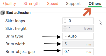

Removable extra layers on bottom
I made my first print on my Bambu,
How can I make a change on the removable bottom layer ?
Specify “bottom layer”
Do you mean the brim that surrounds the part?
Or are you referring to something else?
No, that’s what I mean, thank you for your help.
It’s a little hard to get rid off it, I will try to make it easier to remove it…
Is it really necessary to use it ?
The brim is there to help keep the print fixed to the plate. The “Auto” setting is a little too cautious for me, so if I think the print has enough surface area in contact with the plate, I turn it off. I usually guess right, but sometimes I get to start over.
My project has a large surface, I will turn it off then, thank you…
