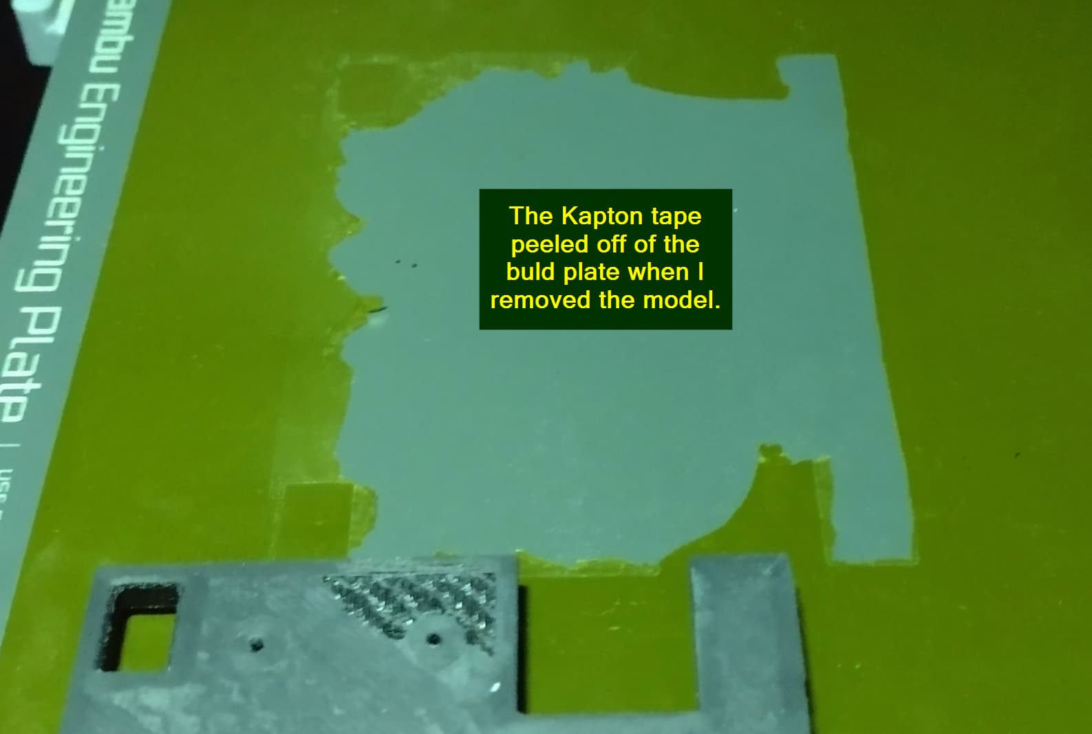

  3. Engineering plate with Kapton (polyimide) tape

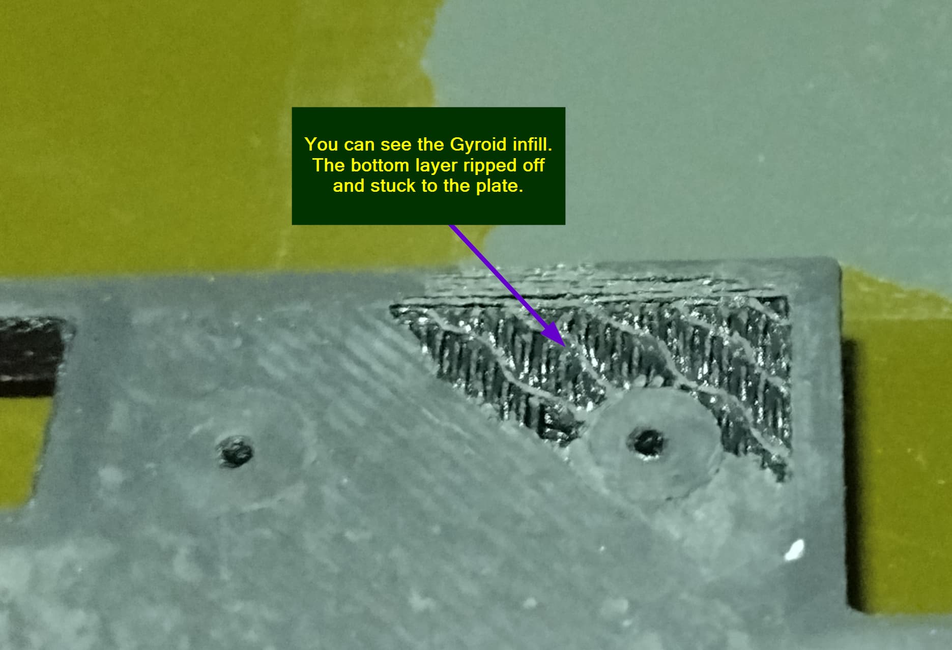

Direct-to-plate printing was a disaster. The part bonded so tightly it broke during removal.(see photo below) I since remedied that by going 100% wall thickness. Nothing to delaminate with that but it created a secondary issue in that it stuck permanently to the plate.

  • Second try: Kapton tape + tons of glue. That let me eventually peel it off - after hot water and careful razor work.
  • Final method: soak in hot running water with squirts of Windex, while carefully wedge up using a razor blade and guitar pick. While it worked but I think I can do better because I can easily see there being problems with thinner models. My test strip was a 75x15x3mm cube primitive.

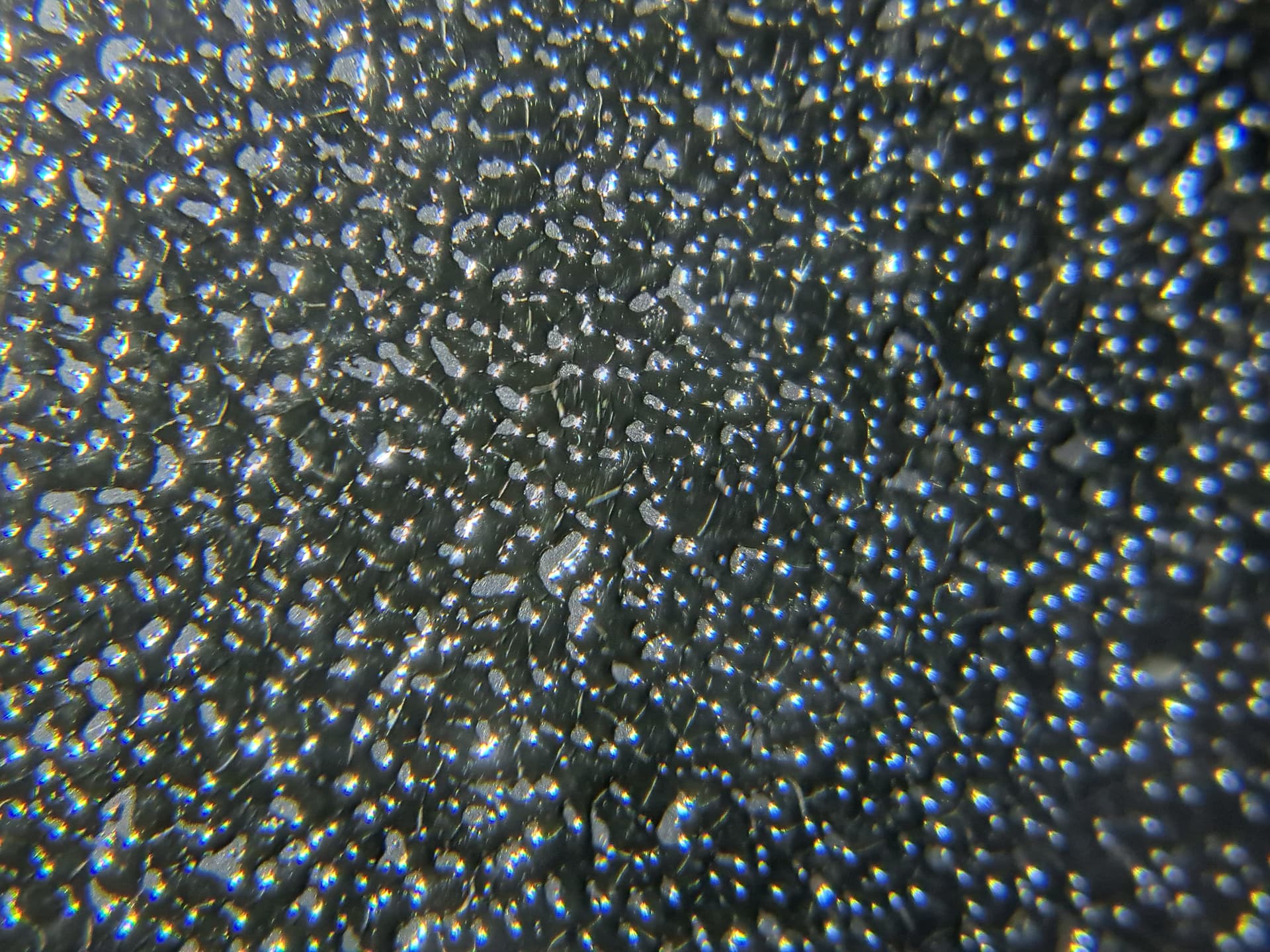

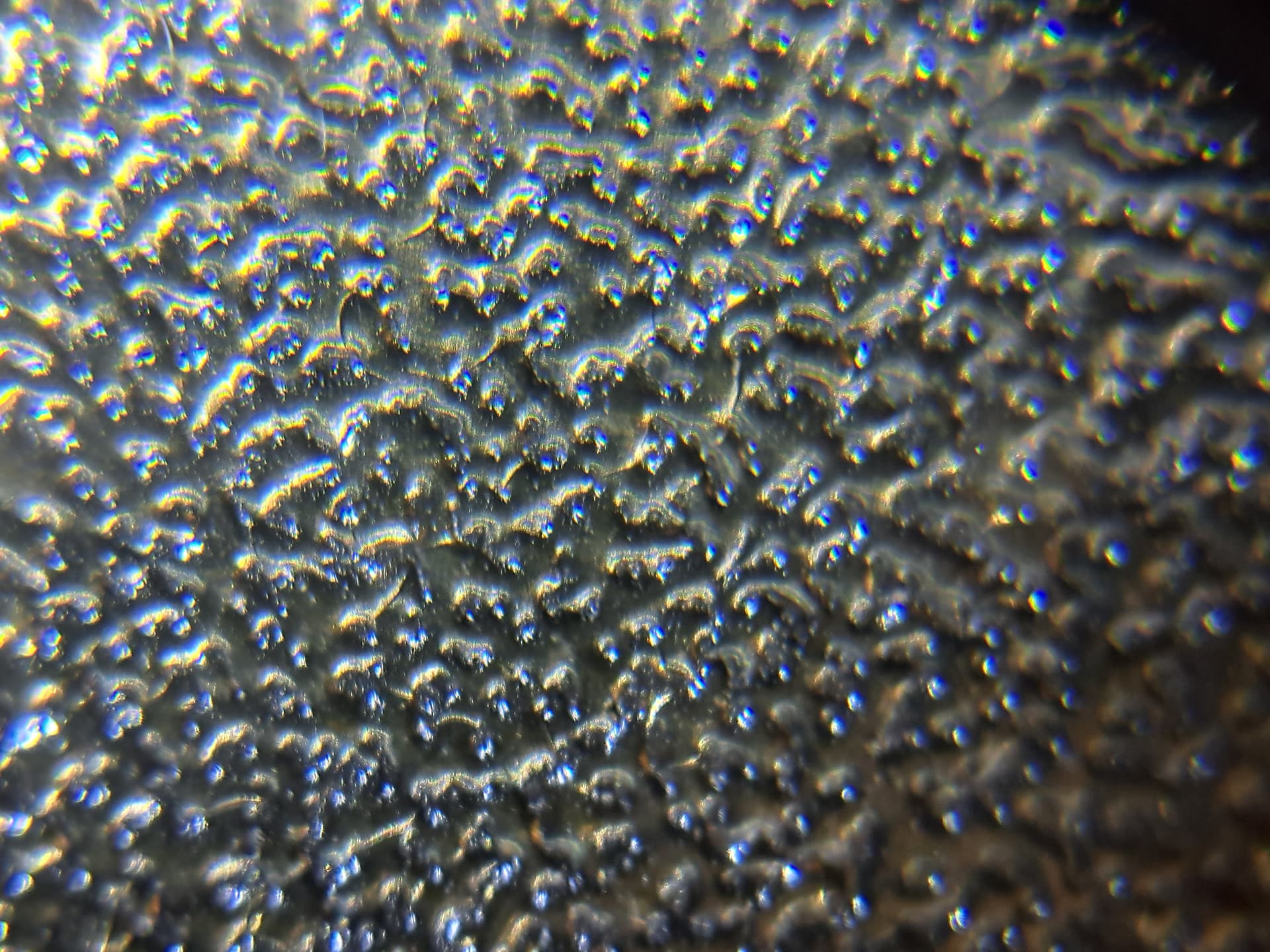

You could use aliexpress textured pei plates. Some of them cheap out when making those black textured pei plate. But that was exactly what I needed for ABS print as I had problem with ABS print stick too darn well to build plate.
Below are macro shots of the pei surface of
Black textured pei plate
Gold textured pei plate
