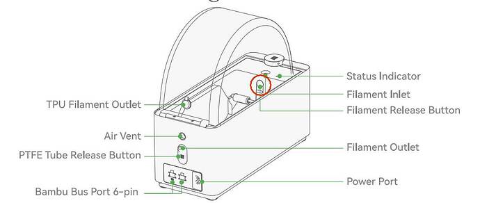

Removing spools from AMS-HT
When removing a spool from the original AMS you push back on the first stage feeder inlet which allows you to pull the filament back freely.
There is no such function on the AMS-HT and the only way I have figured out is to withdraw the filament from the feeder against resistance.
Is there a better way of removing the filament?

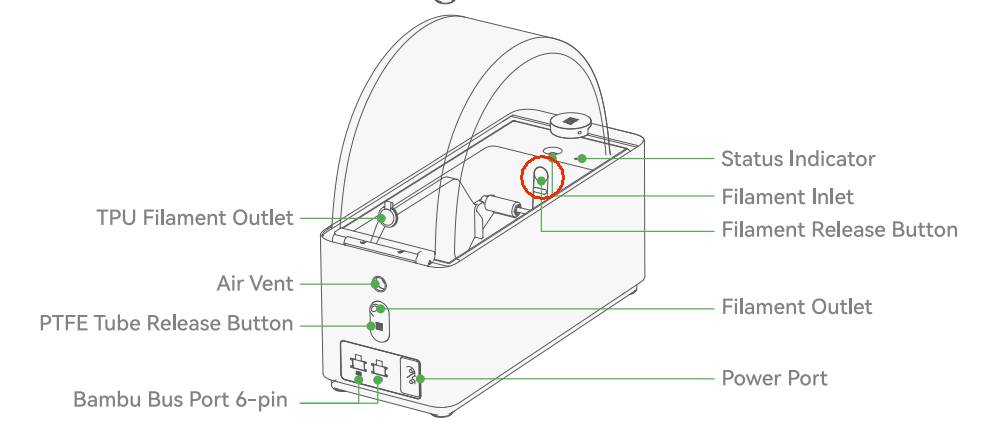

The release button is placed inside on the back side of the feeder on the AMS-HT
