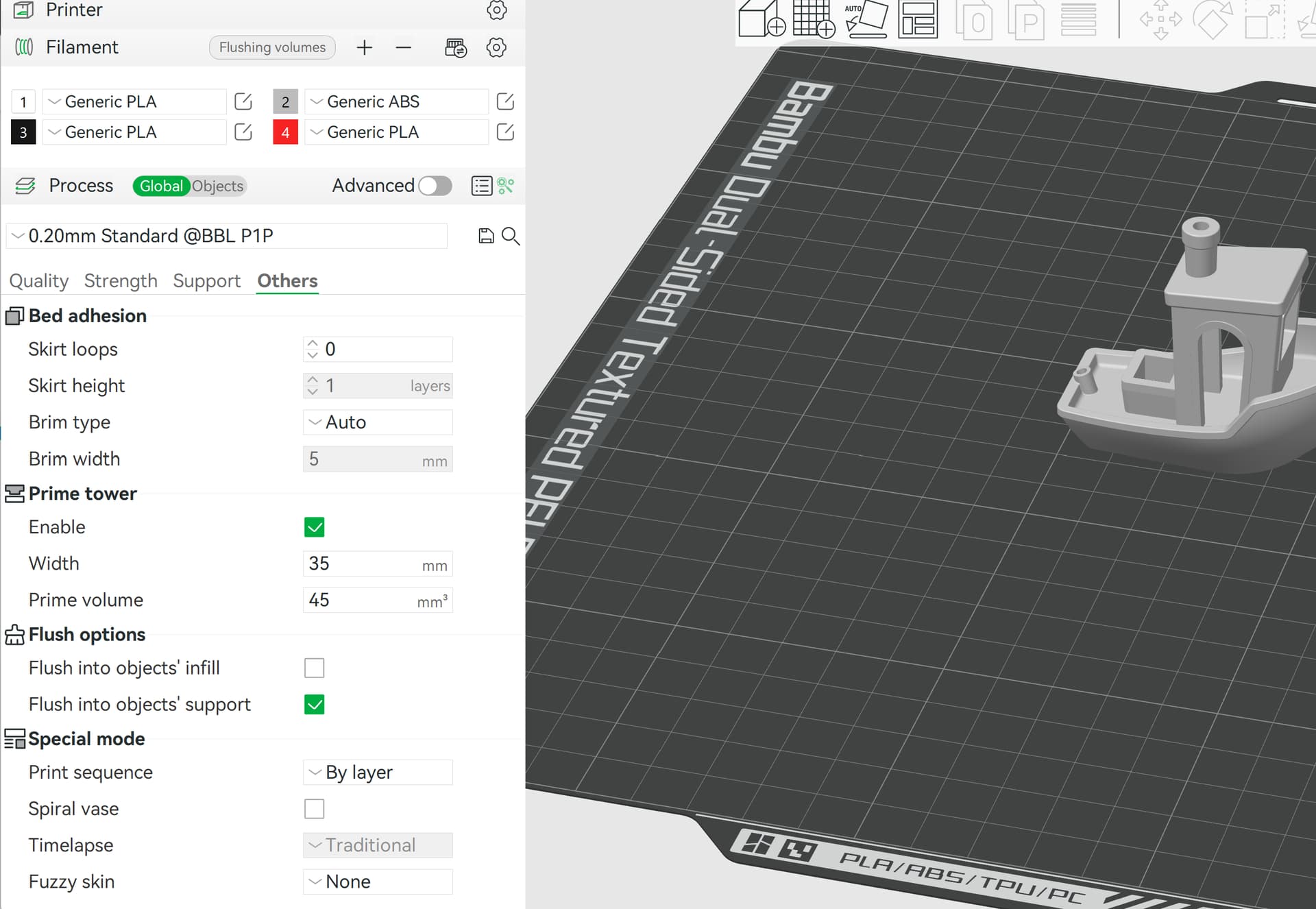

i cant for the life of me figure out how to change the timelapse mode. its greyed out no matter what i do
any help would be appreciated.

You have an X1 correct, not a P1P?
You have a functional micro SD card installed into the right of the view screen?
oh man, ima dummy. youre right, it was because i had p1p selected.
