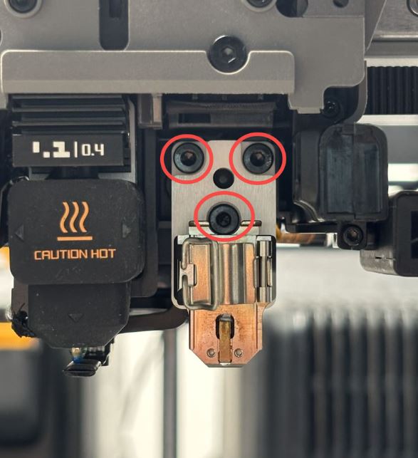

I have an issue where my right nozzle is printing in front of my left nozzle. Tried the High Presicion nozzle offset calibration multiple times but no fix. Tried multiple filaments. Tried swapping the nozzles left to right. Nothing fixes it
Its of by as much as 0.6mm so this is not a subtle shift but a constant right is in front of left. You can see it in the prints as well as the print from the calibration.

A bent nozzle has been ruled out.
It’s strange that the calibration isn’t showing an error.
Check the right heater screws to make sure they are properly tightened and securely fastened, and the heater is mounting correctly.
Right heater

I’d start with a factory reset as well and then go from there.
Trying the factory reset and recal
So the reset, full printing calibaration has improved this dramatically. not perfect but not anywhere near the 0.6mm i had measured before. Thanks for the input folks
