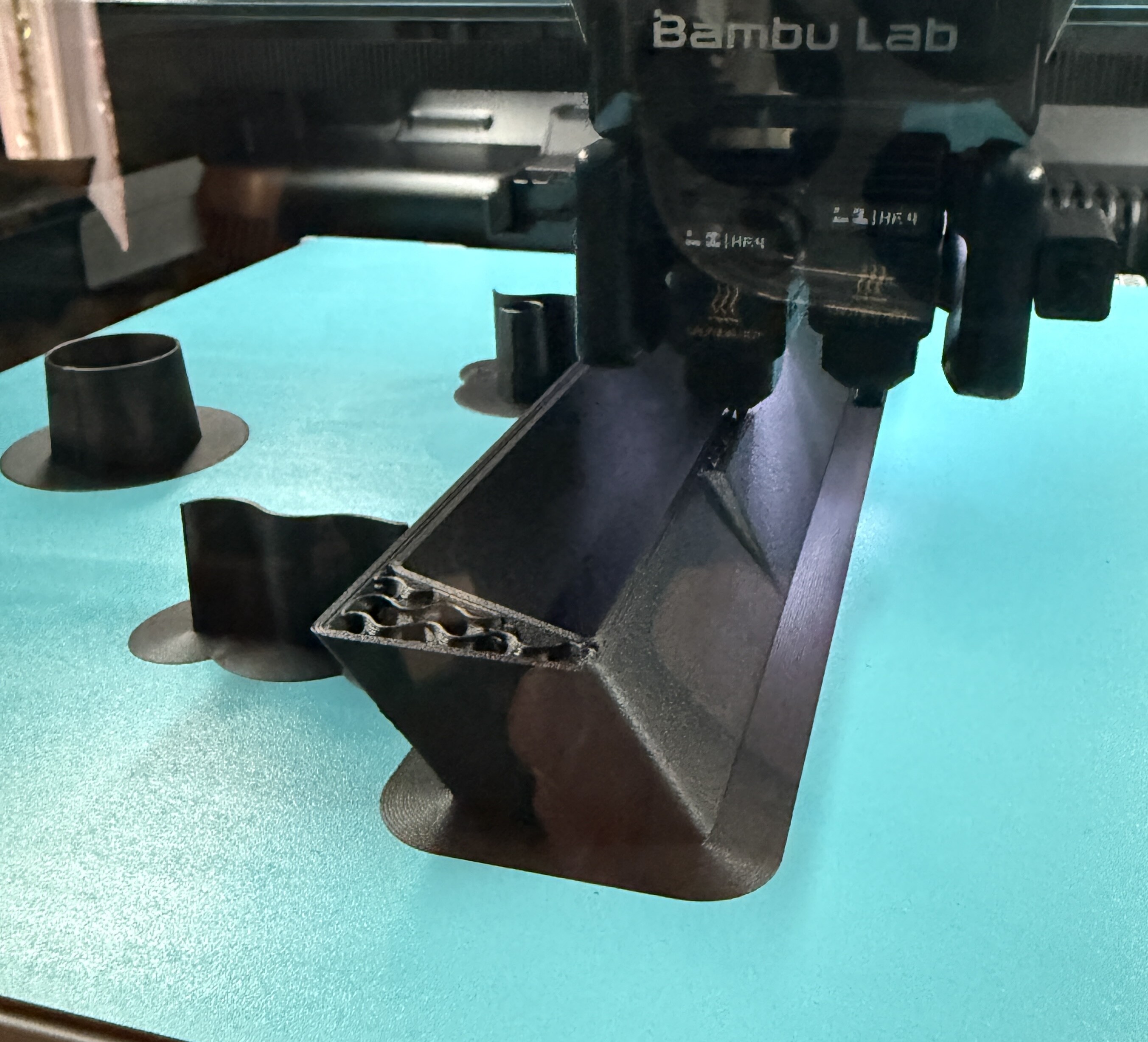

Risky, but it’s working great
Siraya tech PPA-CF
300°c nozzle temp
0.4mm High Flow hot ends
I bought 0.6mm hot ends thinking I’d need them for filaments like this, we don’t lol. The 0.4mm hot ends work great. I thought it was a little risky with the HF hot ends considering HF nozzles are usually clog prone with filled filaments.

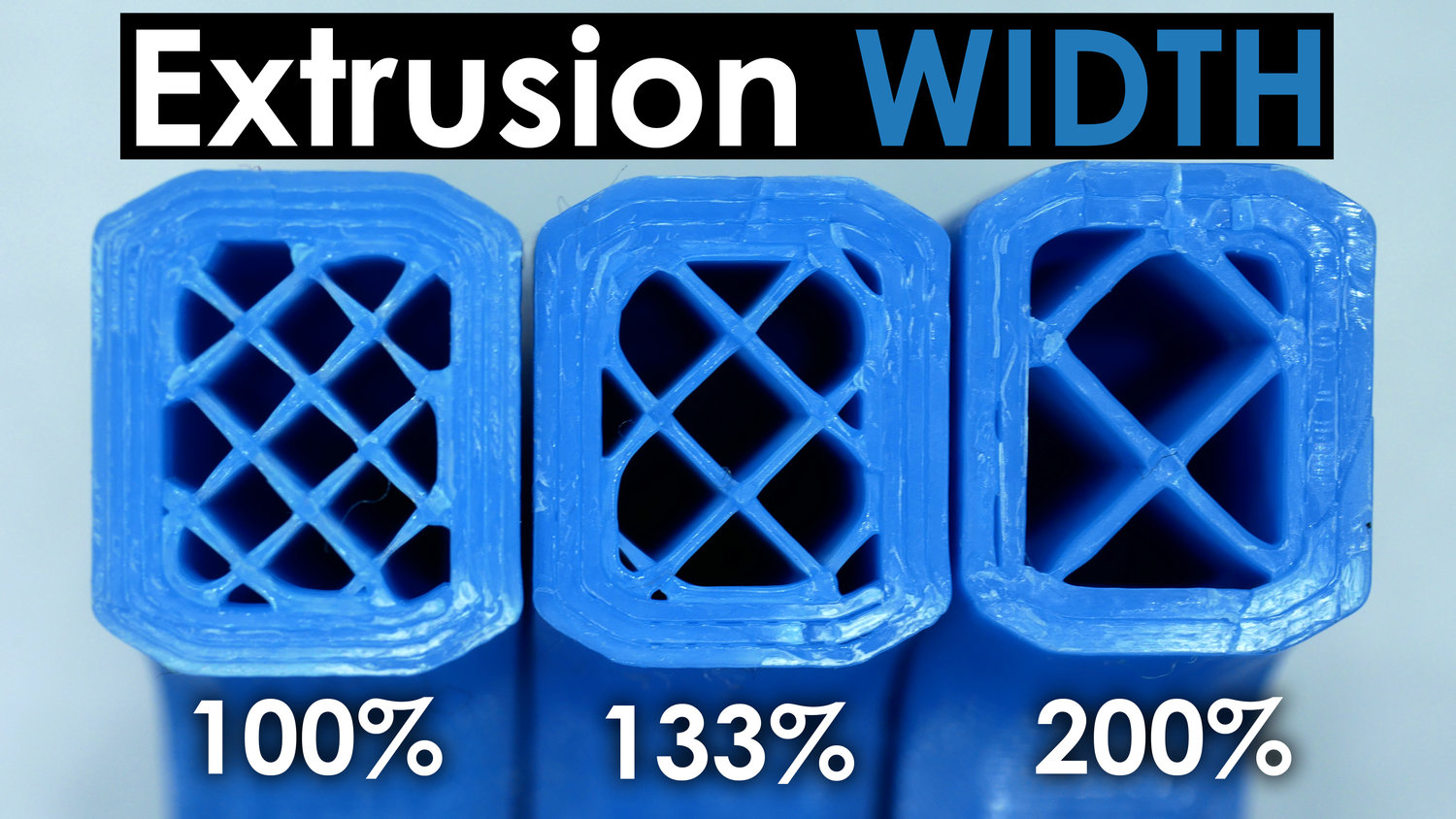

I print all my nylons and CF filaments with 0.4mm HF nozzles, never once had a clog on my X1/P1 and now H2D. I think they recommend the 0.6mm just to be on the safe side, although it is supposed to increase part strength a tiny bit due to the wider extrusions.
Yea, I guess I believed too much of the internet hype without just actually seeing for myself.
Could always just increase the line width of the walls for better strength. I already run my infill at 0.6mm.
Yes i do that as well sometimes on functional parts, 0.5-0.6mm extrusion width except on outer wall to keep them looking good.
I thought PA6-GF would be overkill for this application. I see you are talking precautions though - that’s a big brim, and gyroid too.
Siraya tech PPA-CF - that is so much cheaper than the Bambu one - and you even get a full kilo. What do you think so far?

Yea, I didn’t fully trust it to not warp, but so far there is zero warping at all. This is my first go about with ppa-cf so I wasn’t sure what to expect. 10mm brim to keep things planted and gyroid to use a less linear infill so it didn’t contribute to warping.
Much much cheaper than the Bambu stuff haha. So far it seems to print much better than the eSun pa-cf I was printing yesterday. That eSun warps as soon as you look at it wrong hahah. I’ve printed a lot of siraya tech pet-cf so I fully expected their ppa-cf to give me a good experience.
