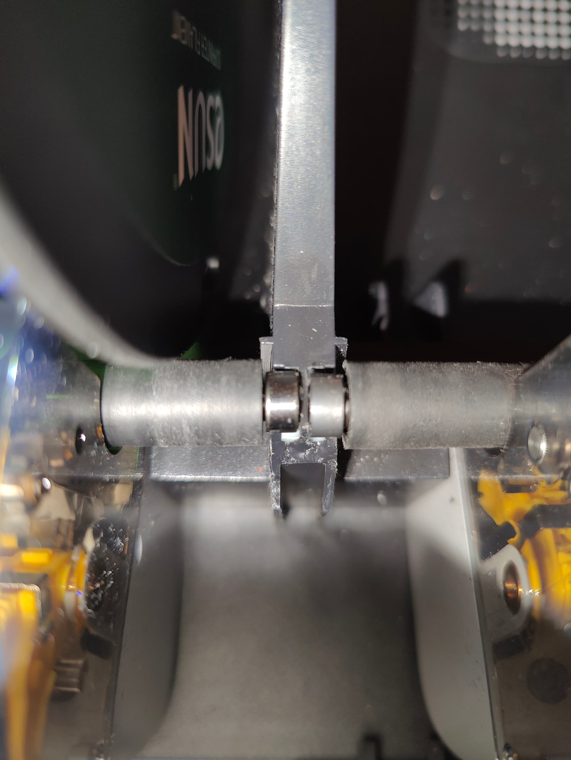

The guidance in the middle for the rolls seems broken of, which is causing the rolls press against the plastic and get stick. I have tried to make s photo and video of the problem. Is there a fix apart from buying a new AMS?

Is that one of the early AMS units? I did read that the early ones had a problem where that piece broke off and the fix was a printed piece to go over it. Otherwise, I’d print the Hydra mod trays instead.

Thank you for the tip with the Hydra Mod, Seems to be the way to go. Do you happen to have a link to the other part? Maybe a fast provisionary repair.

Sorry I don’t, it was an official Bambu Lab fix though.
