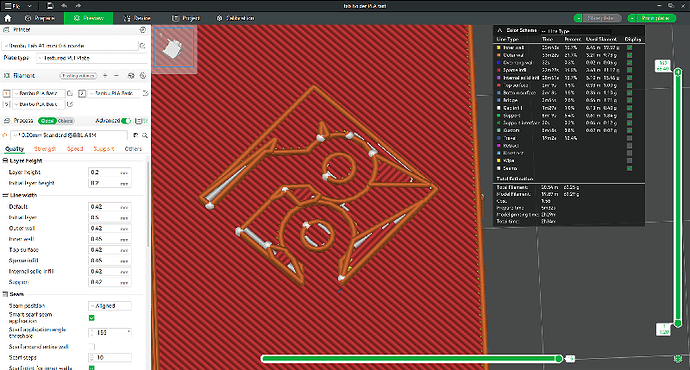

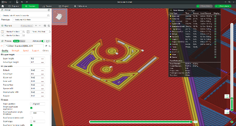

There seems to be a loss of precision when a part is rotated in Bambu Studio. I have a logo on the surface of a model that appears to be parallel to the plate in Bambu Studio. It’s entire surface should be in one layer. However, the slicer shows that its surface ends up on two different layers, 0.2mm apart. The part has been exported from FreeCAD as .step file. In the CAD program the logo is on a surface rotated by 50 degrees around the x-axis. In Bambu it is rotated back 50 degrees to put it on the x-y plane. This leads to the problem. A better way is to rotate it 50 degrees in FreeCAD. Then the surface of the logo will actually be in one layer in the x-y plane, after the step file has been imported. I also had to convert it to a solid in FreeCAD because the rotation wouldn’t show up in the step file without this step.

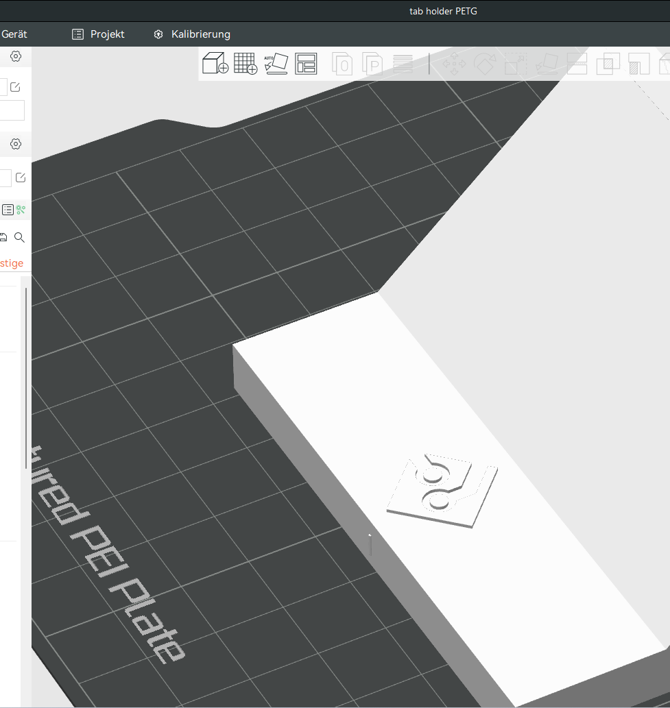

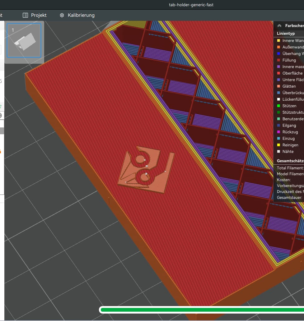

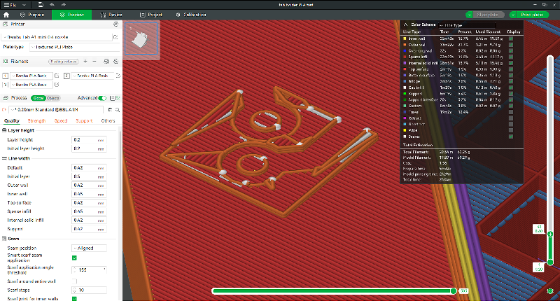

Here is an example. The part can be rotated into this position in the CAD program or in Bambu Studio:

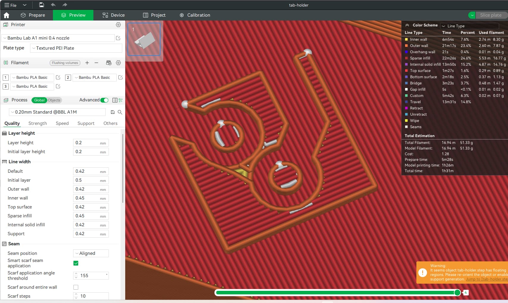

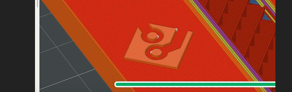

If the model is rotated in Bambu Studio, the logo’s surface is printed in two layers. First layer:

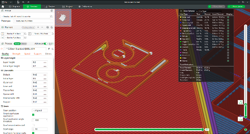

Second layer. Now the logo is completed but looks bad:

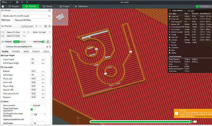

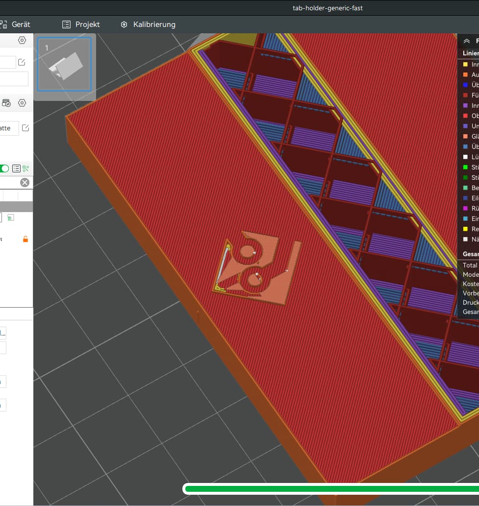

If the model is rotated in FreeCAD, its surface is printed in one layer:

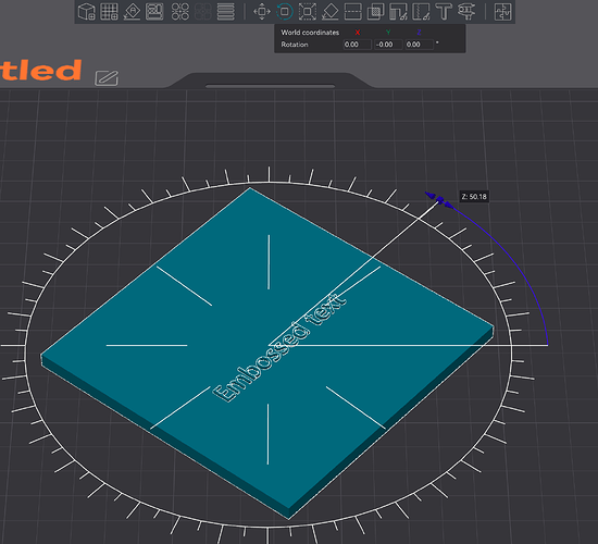

what do you mean by … part can be rotated into this position in the CAD program or in Bambu Studio
In order ot have a certain side of the design on the plate, I can rotate the design in FreeCAD or I can rotate it in BS. The end result should be the same.

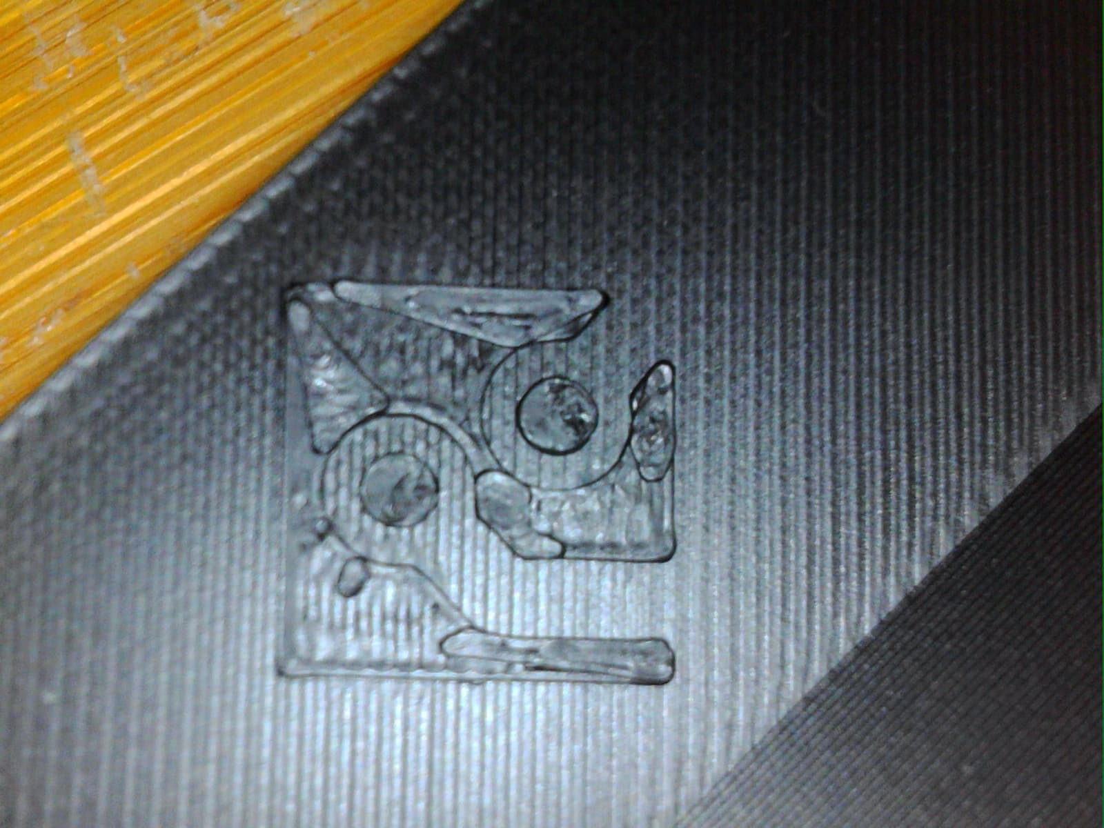

did you actually try to print this?

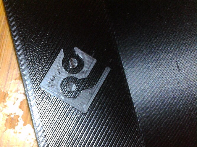

Sure. This print was rotated in BS and printed in PLA. One can see the defects in the logo (exactly as they apear in the slicer preview):

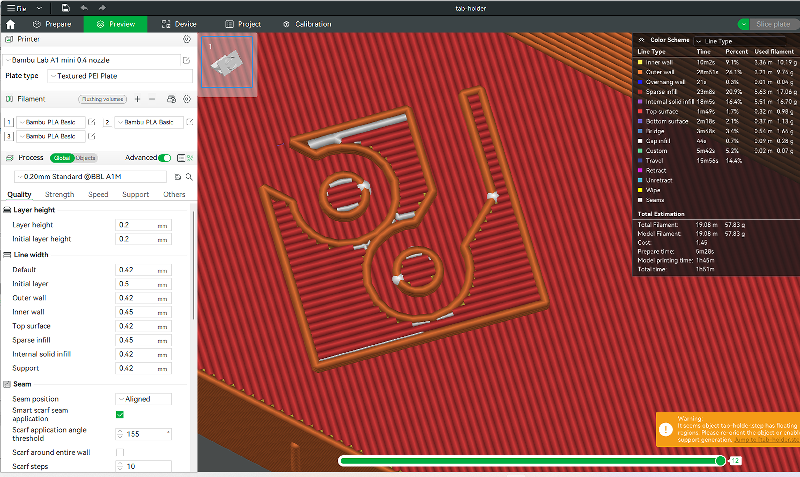

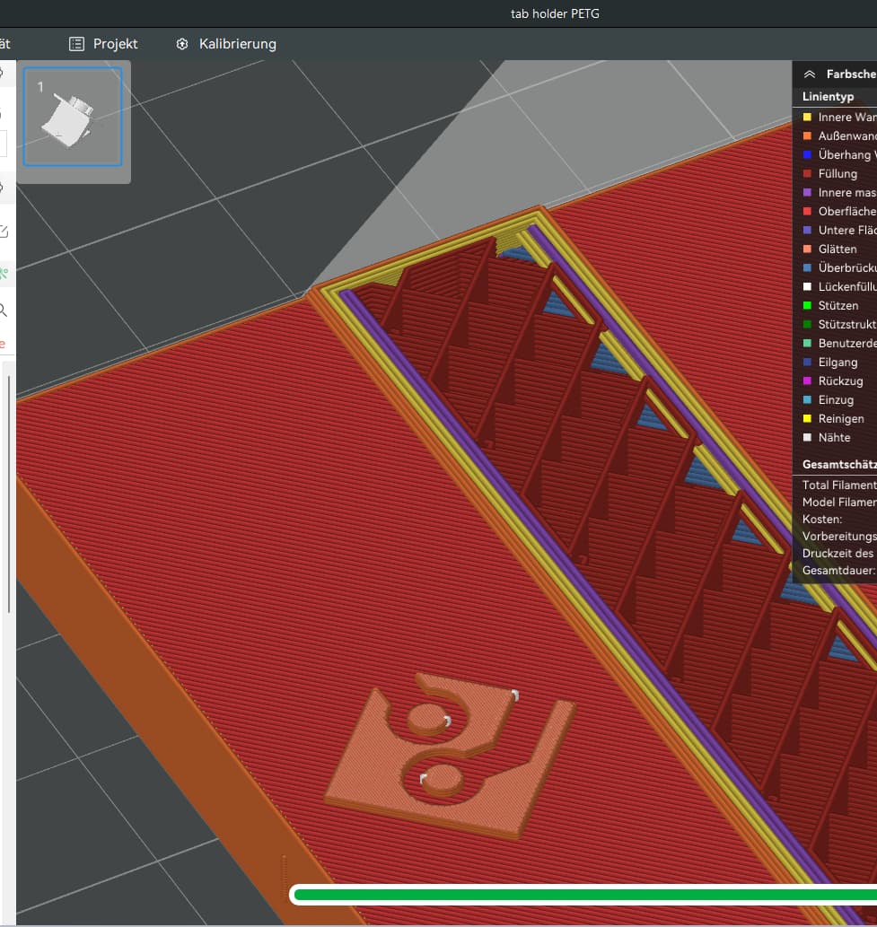

This print was rotated in FreeCAD. The defects do not show up (neither in the slicer nor the print). I only have a photo of a PETG print with badly configured ironing:

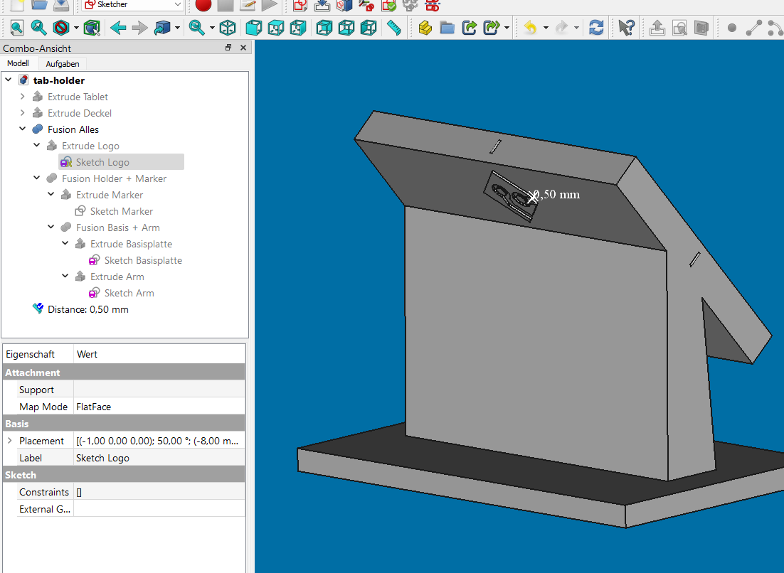

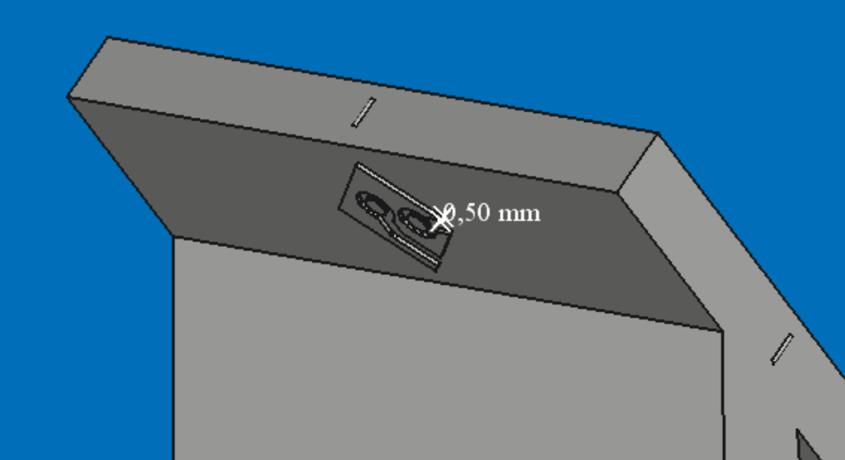

Go into FreeCAD and measure
Everything is fine there. I’ve padded the logo’s sketch by 0.5mm, map mode is FlatFace.

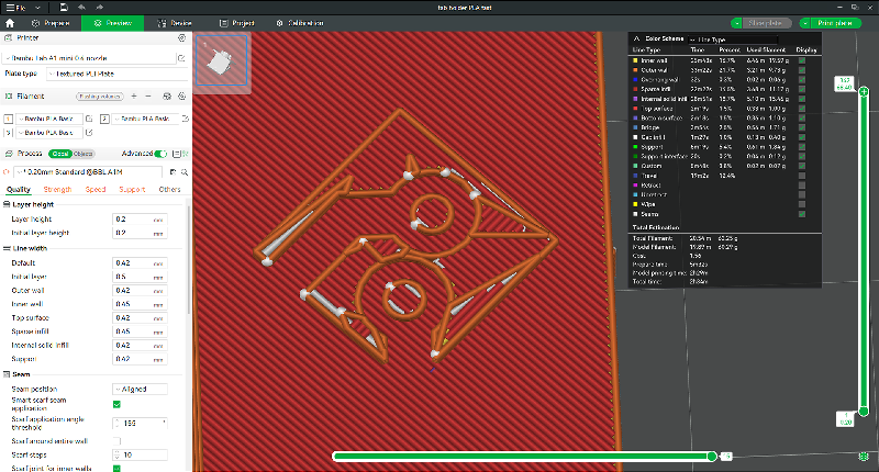

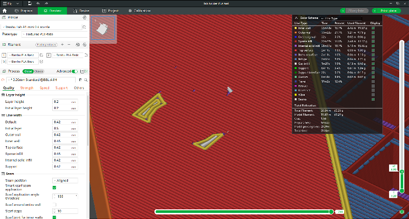

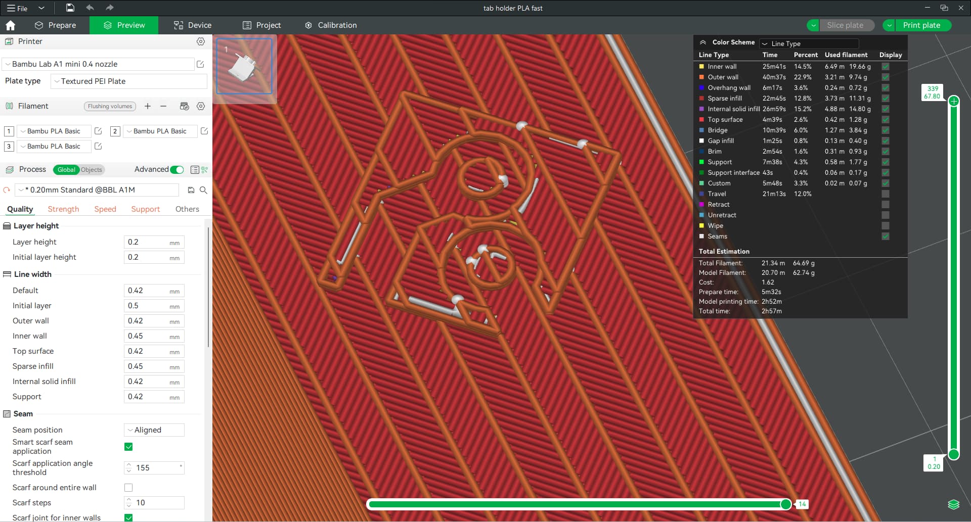

It’s fine in the Prepare view of BS, too. The weirdness is only in the slicer preview. Here are snapshots of the 4 layers that constitute the logo, in the order in which they are printed:

That’s important because the slicer is extrapolating into 0.08, 0.12, 0.16, 0.20, 0.24, and finally 0.28 mm layer heights, which don’t fit evenly within 0.50 mm. What you’re likely seeing is the algorithm struggling with trying to fit the STEP file mathematical constructs into uneven boundaries. Your image below is consistent with that sort of artifact.

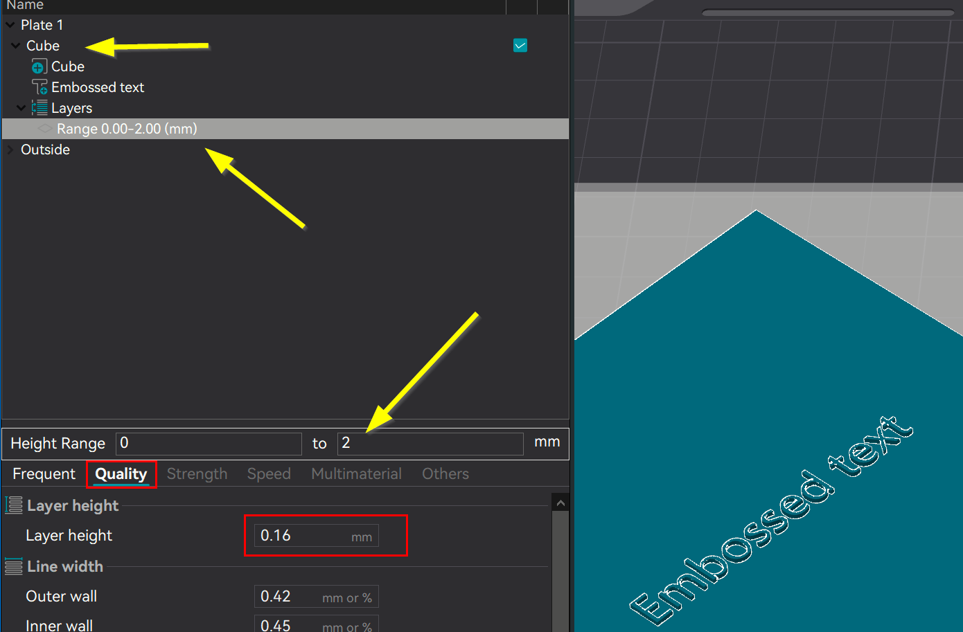

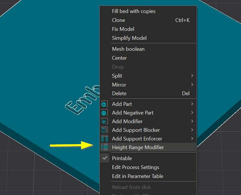

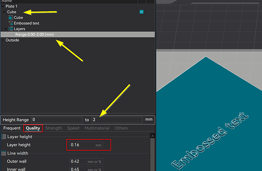

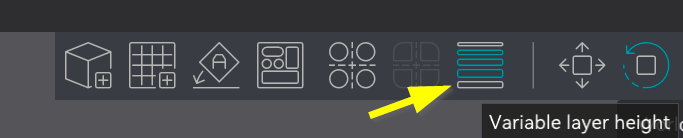

To solve the layer issue, have you attempted to vary the layer heights? You, of course, realize that you aren’t forced to do this for the entire model but can use either the variable layer height tool or the Height Range Modifier.
Both tools will achieve the same objective. Variable layer height is easier to use but Height Range is more precise as it allows you to dial in specific dimensional heights.

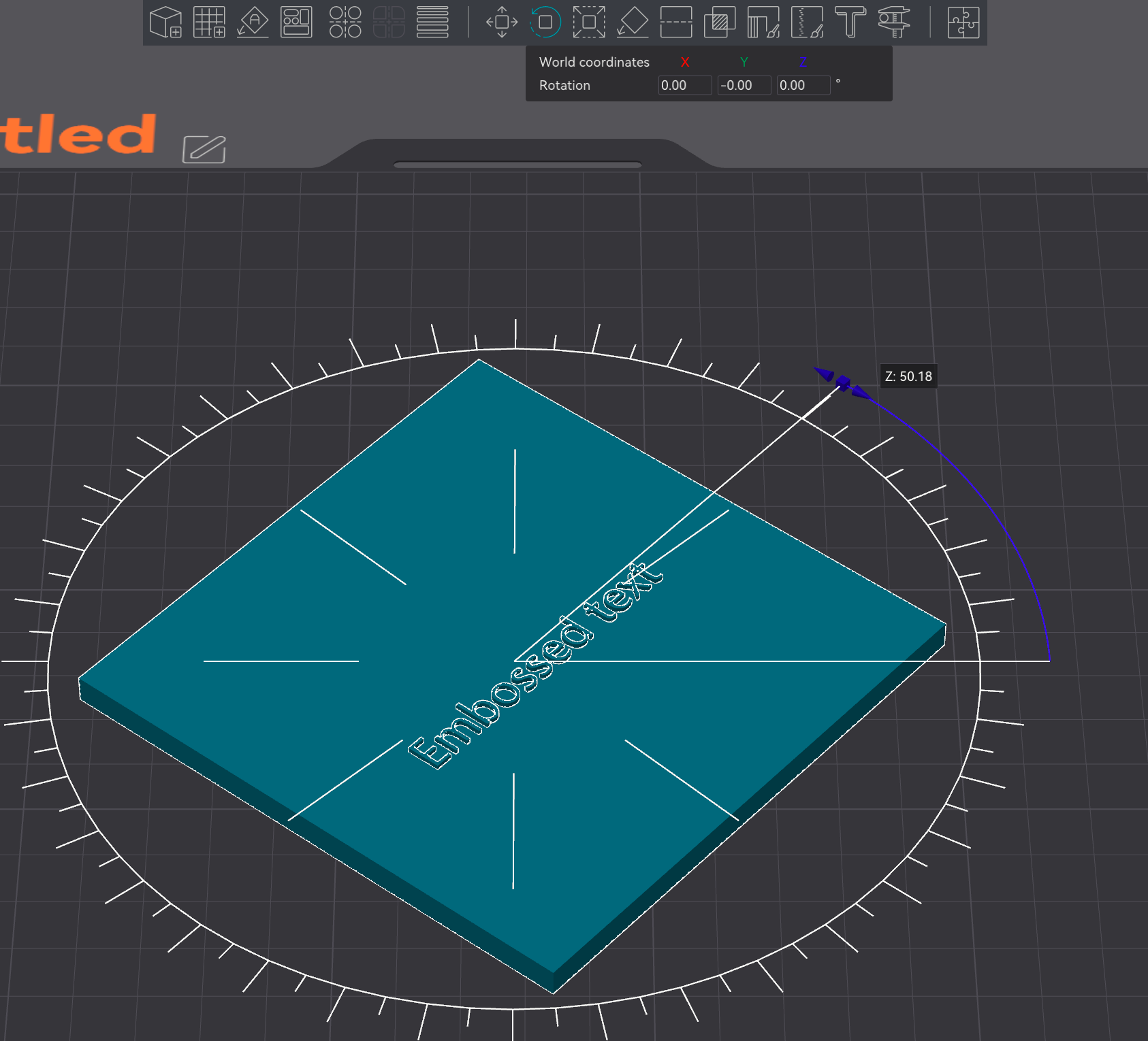

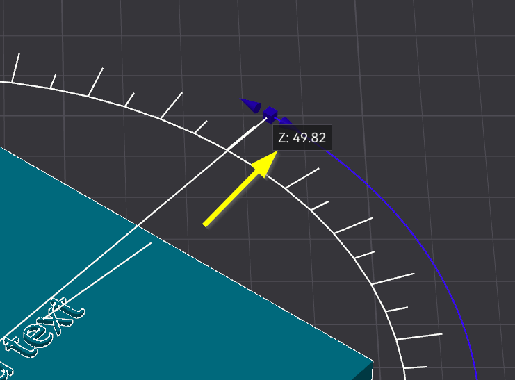

I believe the artifacts in the slicer/print are caused by a rounding issue (that precision is lost in the step from FreeCAD’s internal coordinates to the .step file and that rotation exposes this). The logo looks fine in BS’s slicer if I don’t rotate the part in BS. The rotation in BS causes the artifacts to appear. I tried rotating the part by random angles around all axis. Lo and behold, the logo looks as expected. It gets steps when it’s not parallel to the plate, but no weird geometries pop up. It’s just the rotation that makes the logo parallel to the plate, which should be the easiest, that has weird artefacts.

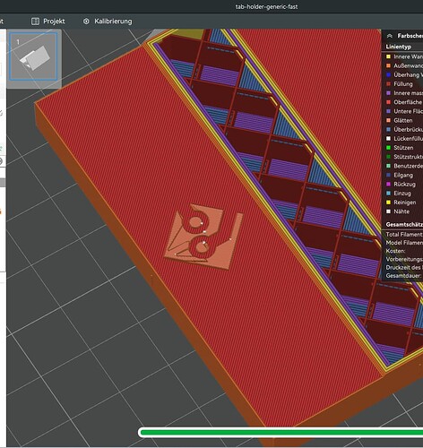

Part rotated in BS to make logo parallel to the plate (.e. rotated by 50 degrees), strange geometries appear:
Part rotated in BS by another 5 degrees from the previous position (50 degrees - 5 degrees):
I never use that. I suspect it would cause visible layer lines.

I wonder if using the adjustable STEP-to-mesh import parameters of Studio 1.10 could correct the problem?
YES! I cranked it up to the max (linear deflection 0.001, angle deflection 0.01) and now it looks good. There is still a tiny error in the logo vs roation in FreeCAD but it’s much better.
