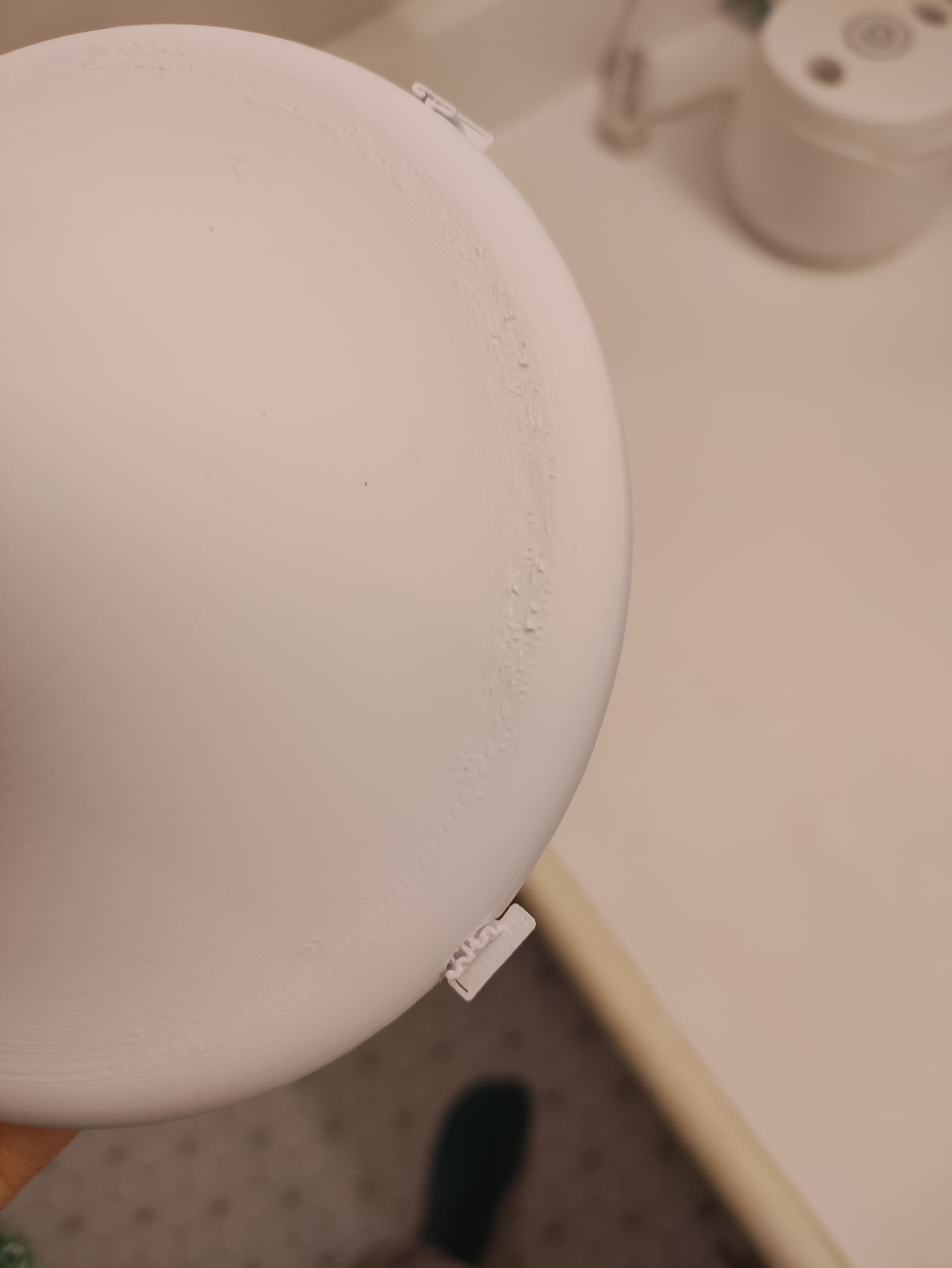

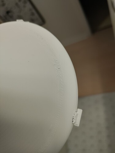

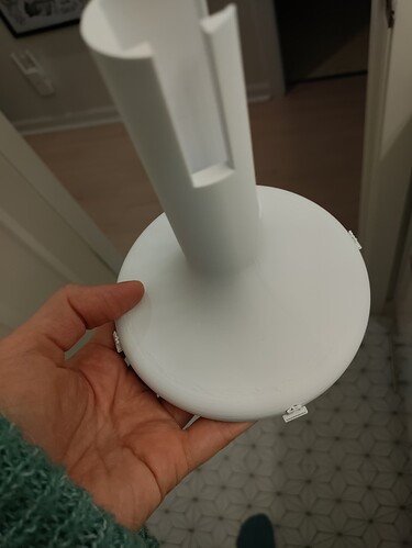

Hello everyone, so I’ve been printing for a while on other printers and got a XC1 a year ago. I’m always printing the same files (designed by myself) that I sell. I’ve been having this issue with my XC1 where I can see those rough lines on the print (see pictures). It’s like a ring of roughness all around it.
It doesn’t do it on my other printers. It’s always the same files, printed in PLA. I already tried a few things :
*adaptive layers was the first thing I did. Lowered the layer height to 0.8 in that area, smoothed it out and it didn’t work.
*changing filament brand. -slowing down outer walls speed
*turning off auxiliary fan
I was wondering what else I could try to to make it look smoother. Sanding down is not an option especially on the black color, it makes it look worse.
Thank you for your help

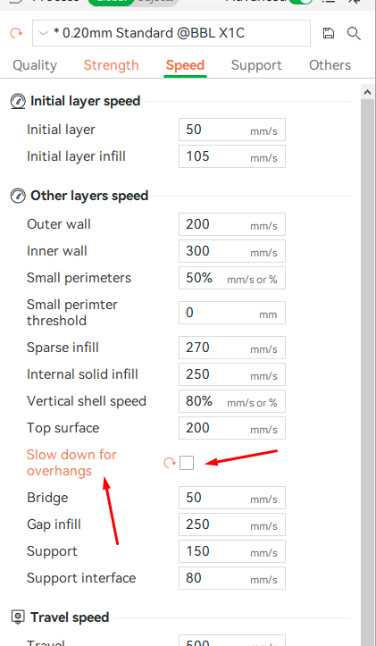

Hi, it seems to me that you have a very similar problem as me. I came across something similar after a firmware update. I managed to solve this problem by disabling deceleration on overhangs. If that doesn’t help you, maybe you can find a solution by printing with dynamic layers.
