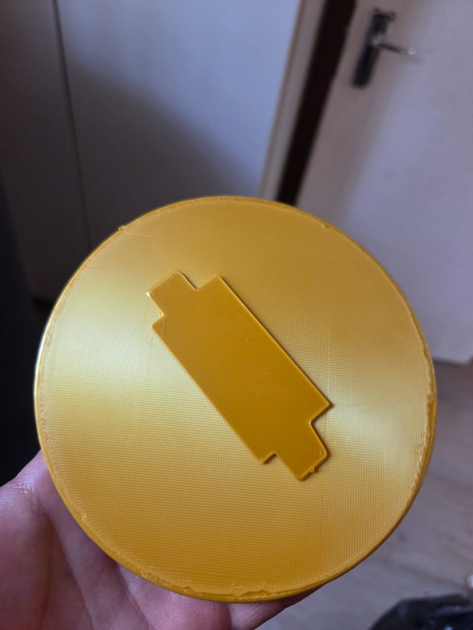

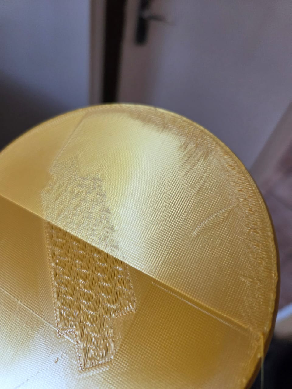

I’ve been trying to print with some PLA Silk on my A1 and for some reason, I keep getting rough top layers/surfaces and artifacts start to appear. At first I thought it was too little support underneath the top layer or too little layers, but I’ve tried configuring the number of top layers as well as top layer thickness and that has not helped at all. The result is below, which you can see it starting to form along the edges
However, what I did do is slice the print so that I only print the top layer and a couple layers before that and what I did notice is that if I do that, I get the following result
Which looks to be a lot cleaner and more slick. The only difference I can see between the two is that the first had sparse infill (gyroid 15%) and the second one had no sparse infill due to how thin it was and was essentially 100%, but I can’t now print the part with 100% infill, else it’ll use way too much filament. I have also tried to see if fan speed/cooling was causing this too happen (in that the fan speed was too low and that the filament was still too hot), but this didn’t help either.

Very important: PLA Silk requires very specific settings. Most importantly, a low print speed. The default profiles in Bambu Studio are far from optimal.
Here’s a link to the correct settings for Bambu PLA Silk - if you’re using a different manufacturer, you’ll need to check their recommendations.
…and then I see that Bambu deleted the Wiki entry with the correct settings. :man_facepalming:
This is the new wiki entry, but unfortunately it doesn’t include all the correct settings… but it’s still worth checking out.
