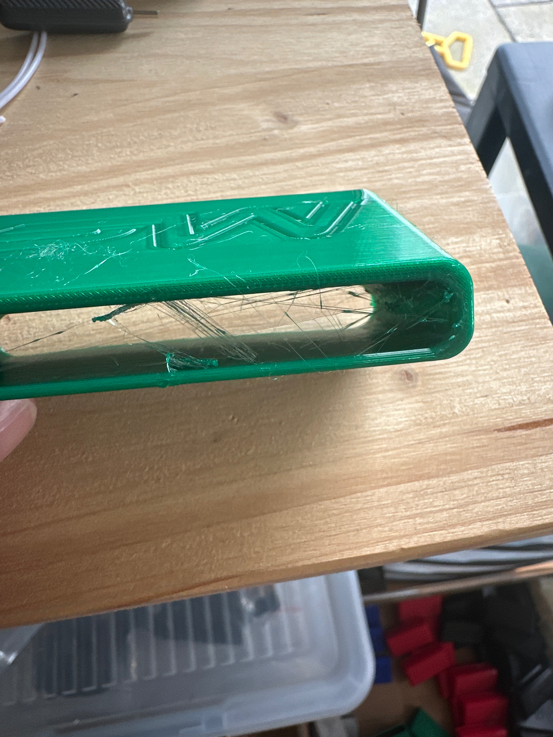

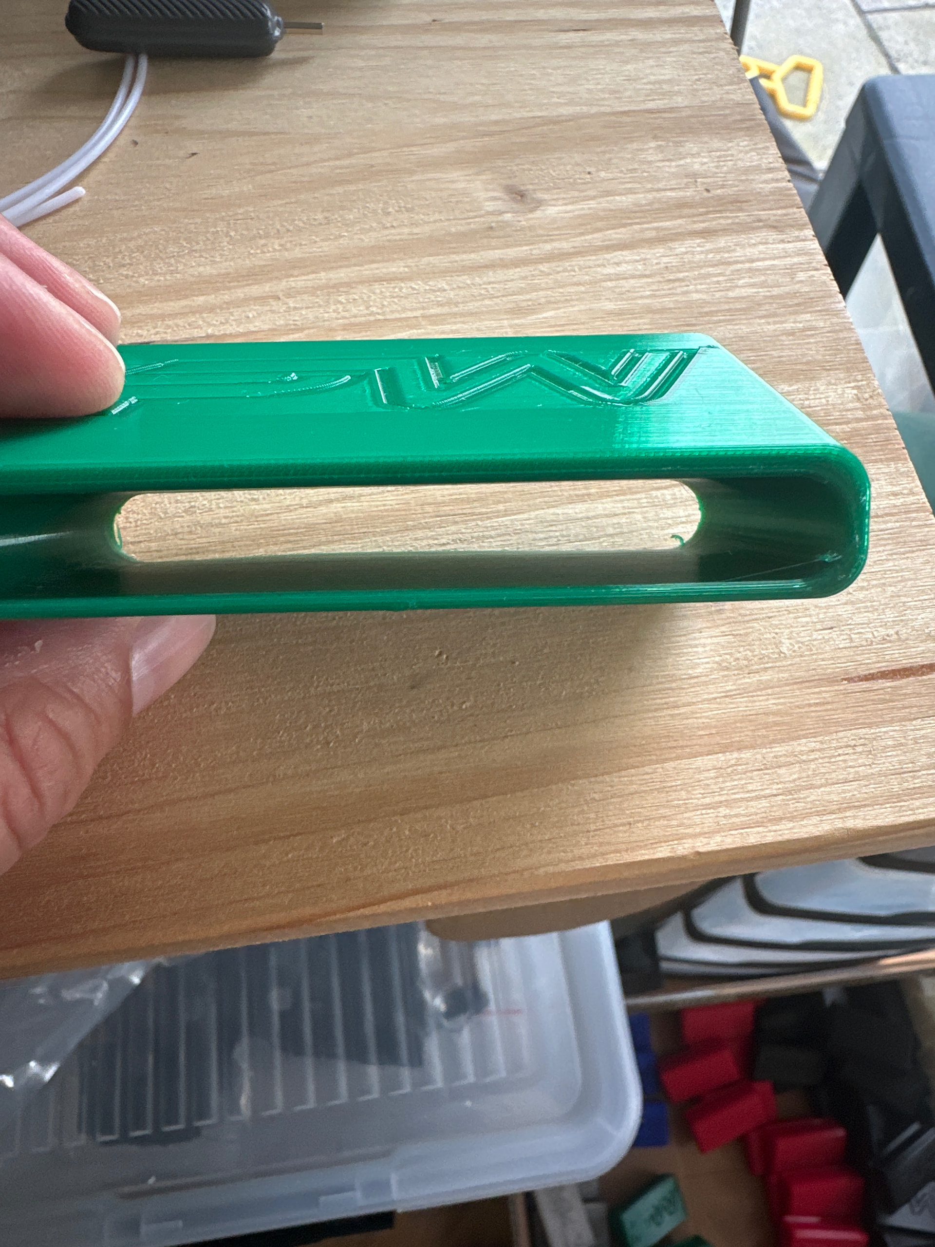

I’m looking for help diagnosing an X1 Carbon that consistently produces stringing, blobs and slight overhang curling when printing TPU. I have another X1 Carbon running the exact same print profile and it produces perfect results, so I have a direct comparison.
Symptoms
  • Heavy stringing and random blobs.
  • Slight upward curling on overhangs.
  • Prints much better in Silent Mode (50%)
  • Lowering nozzle temperature made the print quality even worse.
What has already been replaced
  • Complete hotend assembly.
  • TH (toolhead) board.
  • Front cover / part cooling fan assembly.
  • None of these replacements changed the issue.
What has been checked
  • Same firmware on both printers.
  • Same nozzle size.
  • Same G-code and slicer profile.
  • Different TPU spools.
  • Different filament dryers (including a new dryer).
  • Extruder gears inspected and cleaned (looked pristine).
Additional observations
  • One printer prints the exact same model perfectly while this printer does not.
  • I previously noticed a connector on the original TH board that felt looser than on the good printer, but replacing the TH board made no difference.
  • I printed a mod fan duct for the hotend cooling fan. No difference.
  • I recently discovered that one of the cable chain/toolhead support links at the top of the toolhead had become disconnected. I snapped it back into place but have no difference in result after.
  • At one point the toolhead was accidentally powered on while detached and hanging from the cable harness, so I am wondering whether the wiring harness could have been damaged internally. No visible clues.
At this point, are there any known X1 Carbon issues that could cause these symptoms despite replacing the hotend, TH board? Has anyone experienced a faulty wiring harness, mainboard, or another less obvious cause that resulted in similar TPU print quality problems?
I have trouble shooted with the assistance of an AI agent and last suggested probable cause was the extruder motor running to hot. Any DIY fix to this? Any way to investigate?
Any suggestions or similar experiences would be greatly appreciated. Thank you.

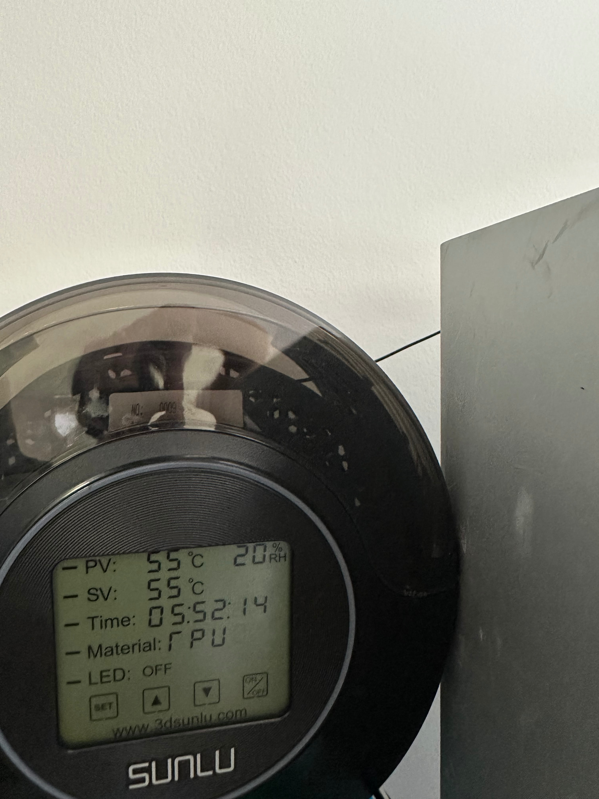

The TPU is fully dried and even replaced dryer with the dryer used on the good printer. So I believe moisture is ruled out.

My dryers are set up elevated to the left with a direct and straight line to the back ptfe tube. The drag should be very very minimal. As mentioned before I even swapped the dryer with the good printer. So any drag or resistance from the dryer must be ruled out.

Extra content. When printing at 100 % speed the item prints perfect with clean surfaces and no visible under extrusion. It is only within the crevasse/hole down the vertical middle, where the stringing occurs.
