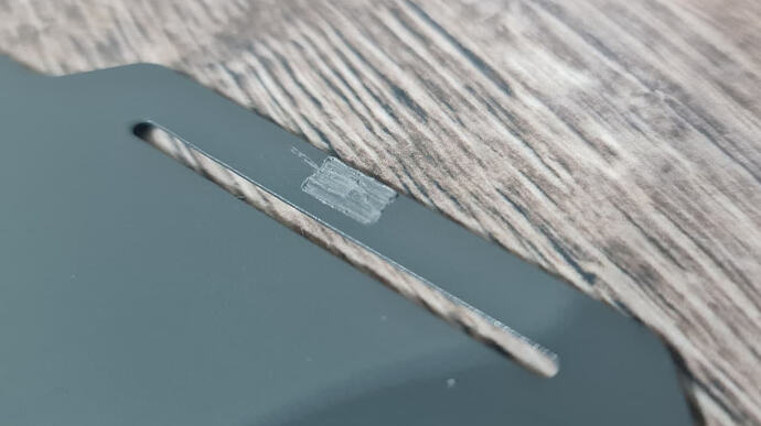

Scratch on bed

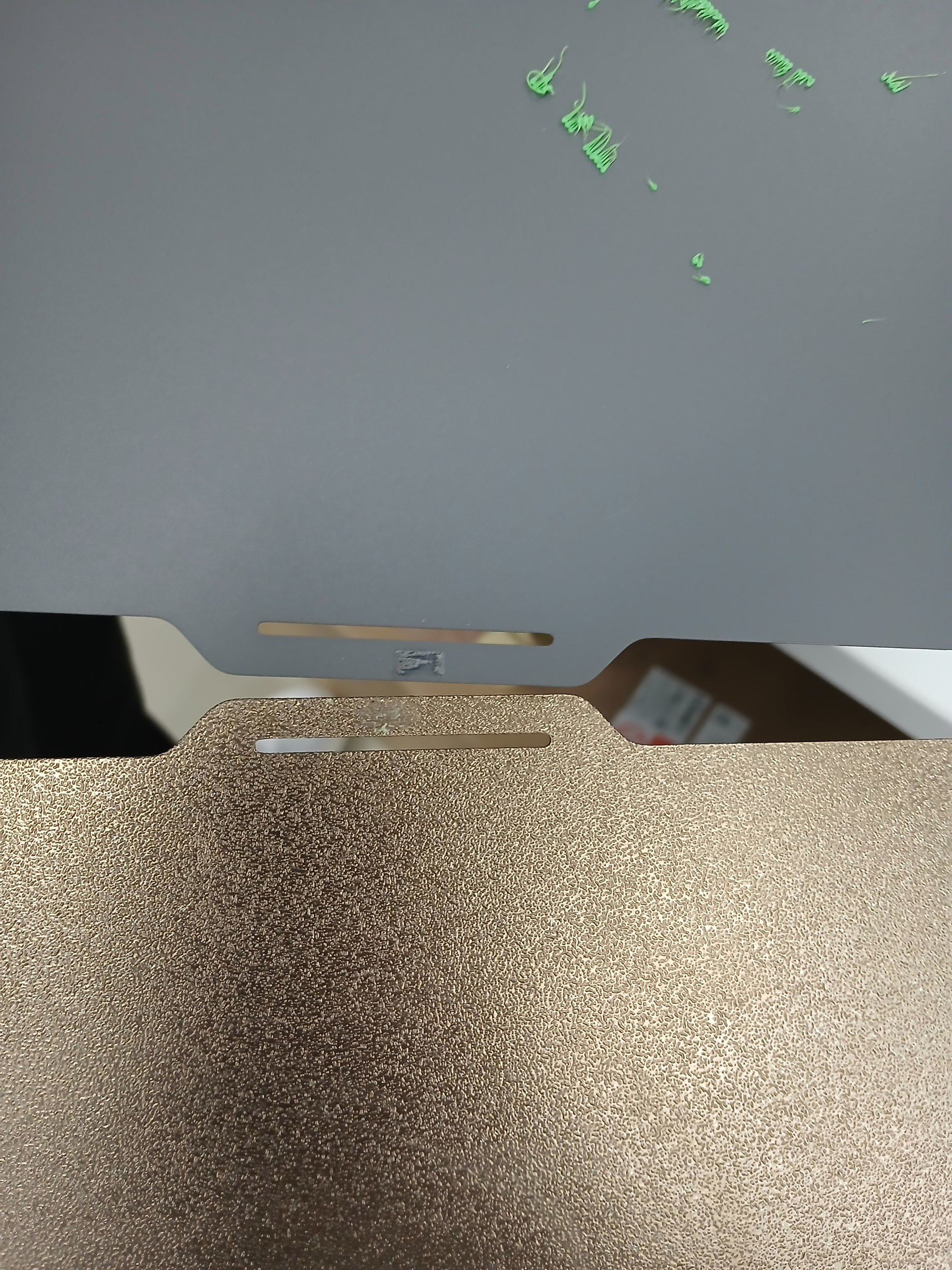

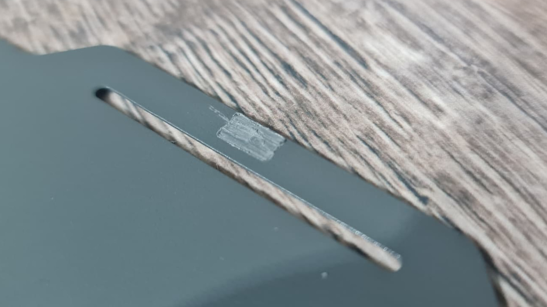

I recently purchased a new 3D printer bed and noticed a scratch mark on it. I also found that the original bed has a similar scratch in the same location. Initially, there was no scratch, but it appeared after I started 3D printing. Could you please advise what might be causing this and how I can prevent or fix it?

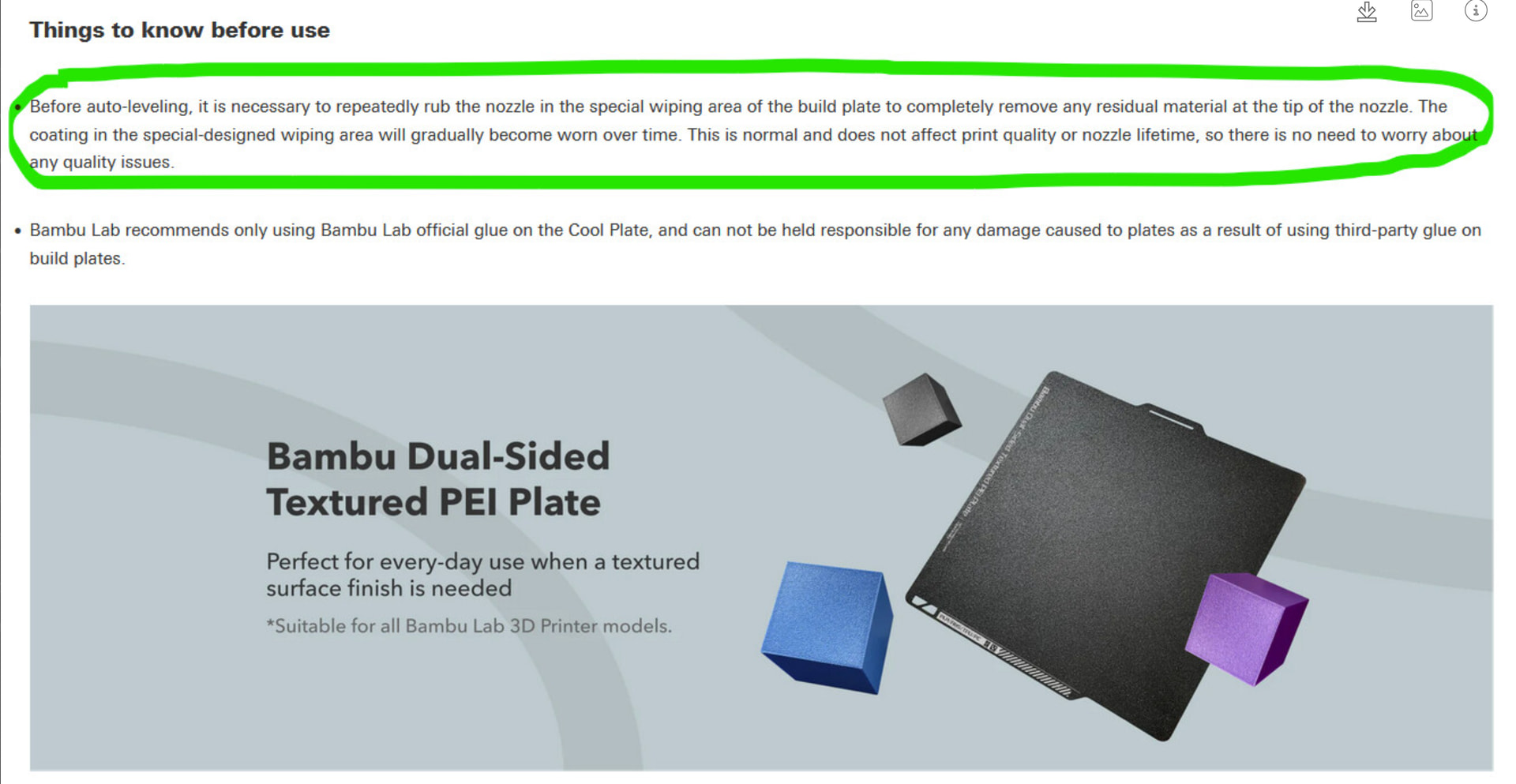

That’s perfectly normal. This area is used for cleaning the nozzle.
