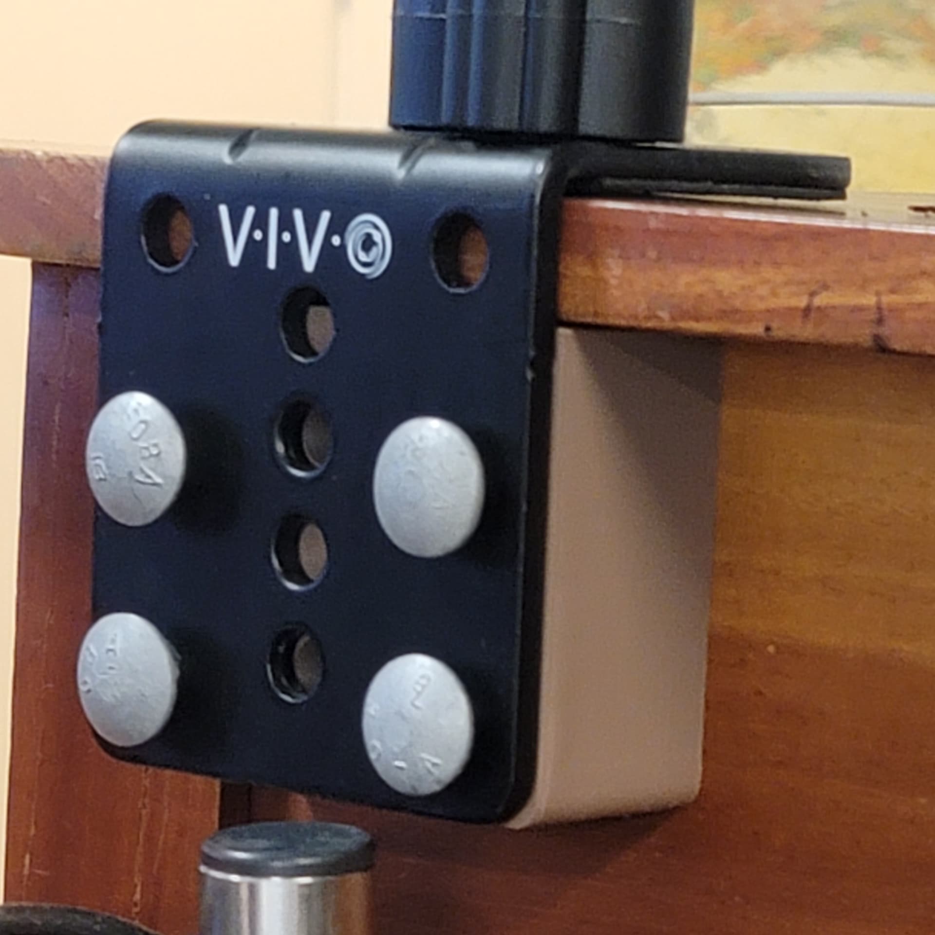

I am making what I call a shim but is a block to allow me to bolt a flat aluminum casting to an table with a typical overhang of about 1" - 2".
This block will have three bolt holes that run right through the cube.
How many wall loops is appropriate to prevent crushing? I am not going to use an impact wrench or anything like that but I think it probably needs to be beefed up some.

This is the first one I made.
6 3/8 nuts, bolts, washers.
The load is a 22" monitor on an arm.
This is conceptually the same but different plate dimensions, 3 bolts, 5/16, load is keyboard and keyboard platform.
A little side note on why. I have started messing around with Fusion and my laptop doesn’t like Fusion. So big PC and need support for monitor and keyboard that can accommodate my physical issues.
Most of the load is on the desk, the “shim” load is only if the monitor stand is pushed backwards.
My guess would be 4 walls would be more than sufficent.
Looks from the picture there is a gap between the desk and the plate that sits on it which would increase the flex loading on the block. I’d see if you can get it sitting lower or pack it with spacers.
If you are talking about this gap, There is a rubber pad under the plate.
The angle is also slightly greater than 90° and it also is a radius bend. To get the top section flat, you have to scoot the 90° out some. Best compromise I could come up with.
Looks to me what you have there should be fine what material are you using?
Bambu Lab Basic PLA

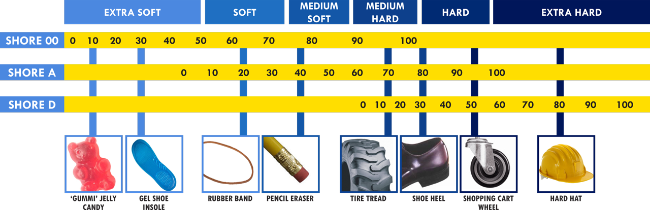

You asked for a chart for hardness, if you mean one in context of your question (as hardness on non-flexible materials is irrelevant), the the shore scale is your friend.
TPU materials are on the shore scale.
Based on what BL sells, and from soft to hard:
  • TPU85A
  • TPU90A
  • TPU95A/TPU95A HF (HF is just quicker to print)
  • TPU for AMS (68D)
TPU for AMS - doesn’t actually require an AMS, it can be printed without one, it is just the only one that can be printed with one as it is hard enough nor to get stuck. It can also be swapped in the same layer unlike any of the others.
