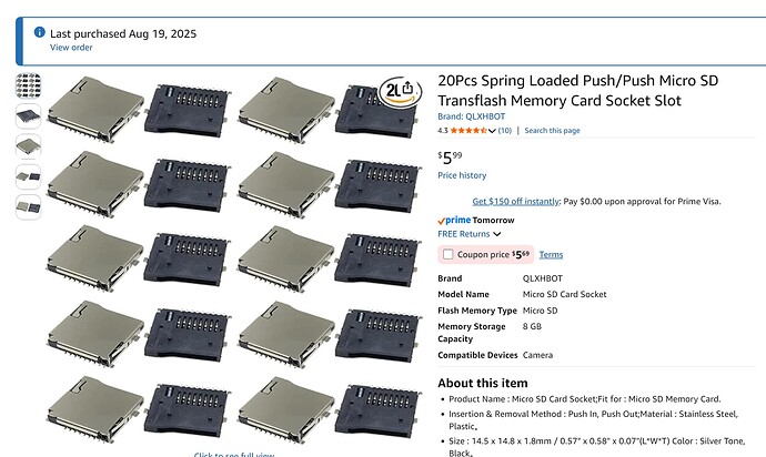

Agreed. My SD card spring failed last summer. I ordered replacement card sockets with the full intention of pulling the board out and soldering in a new one. While waiting for the sockets to arrive, I removed the board, disassembled the shield, and manually removed the spring mechanism. This was intended as a stopgap measure until the sockets arrived. Since then, I’ve just used the SD card and relied on friction. I still have the package of 20 pcs on my desk and never quite got around to repairing the unit. But for six bucks and a little soldering, why would anyone go through the headache of dealing with Bambu?
