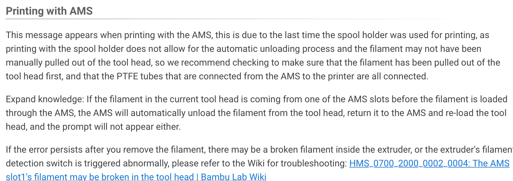

  6. The printer starts the calibration, then stops with error:
    HMS_07FF-2000-0002-0004: Please pull out the filament on the spool holder from the extruder. | Bambu Lab Wiki

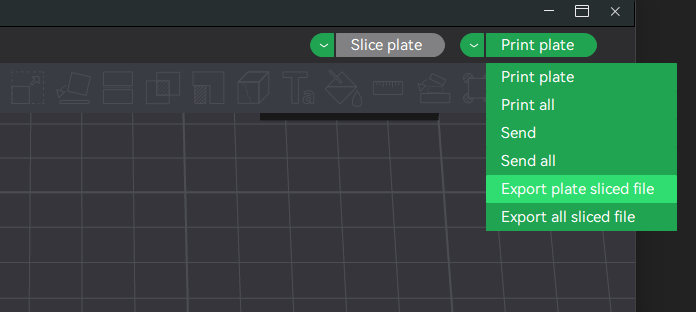

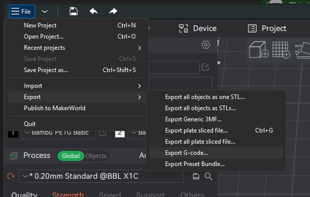

How do you generate the gcode file?
Like this?
or like this?
hey
I’m using the first option
