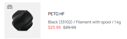

I seem to be having the same issue but with Black PETG HF (not refill but with spool)… The AMS is recongnizing it as Black PLA… Tried different slots of the AMS and checked with other spools to see if it reads correctly and yes they do.
I tried inserting the roll “backwards” so the ams reads the other NFC tag, and it got the right info : PETG HF Black! so i guess one of the tags is corrupt as well or wrongly configed
And once the AMS reads the TAG, I can’t seem to be able to manualy change the information (there isn’t a “pen” logo on the slot in bambuStudio… only an “eye”)
This needs to be done on the printer.
