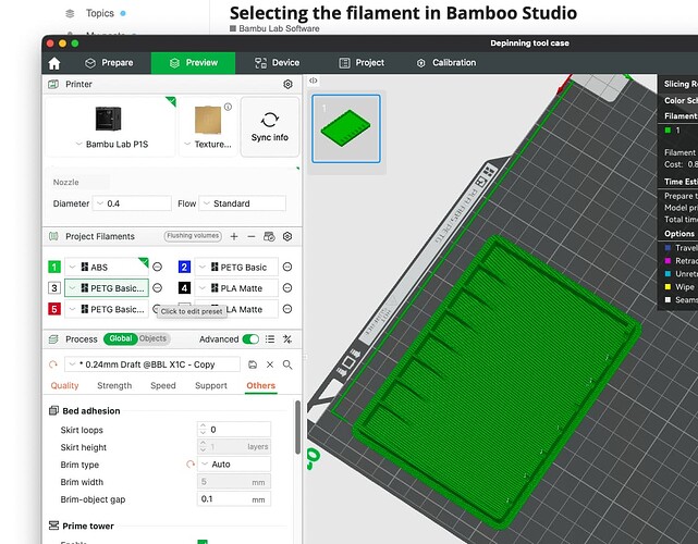

I’m not really a NOOB, but I must be doing something wrong, because I always end up in a fix when printing from Bambu Studio (Note: I don’t have an AMS).
I made custom filament profiles for all my filaments, as can be seen here:
I have green ABS, blue and white PETG, etc. –and I thought I could click on them to select them!
Now, how do I tell Bambu Studio that I want my model to be printed with filiment #3 White PETG?
Because you see here it’s still trying to do it in green ABS even though I keep selecting it in the Prepare tab…

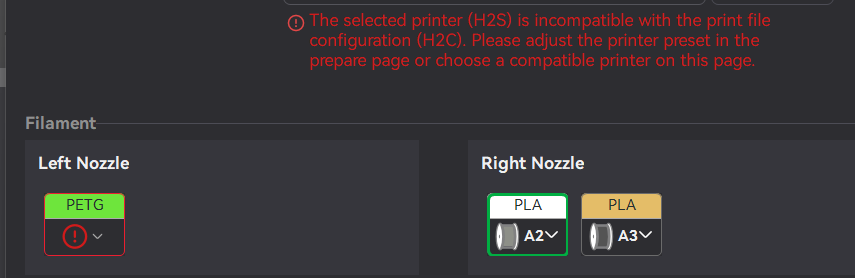

Furthermore often when I go to print, it tells me I have the wrong filament in my printer and says I must “select from the following filament” – and only one is available! Green ABS on EXT…

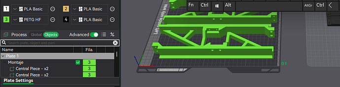

You can assign the color in the object tab of the process then click on the filament field:
or you can right click your object and then select “change filament“ (the last option) from the menu:
Reduce the project filaments to one, select the single profile from the dropdown.
Change the listed colour and filament from green abs to white petg ,dont just swap them around
Changing white pla to green petg in slot 2 will see the model colour and filament change for slicing
in this example
That’s helpful, thanks. I have minused all the other ones, so there is only one now.
I feel like Bambu Lab has forgotten about people who don’t use an AMS.
The thing I don’t understand is, why do I then have to select the filament again on the Device tab? Why does the Device tab even care? I am using the External spool - I have no AMS, why does the program assume it knows what is on my spool holder?? It has no way of detecting what is on the external spool so it should just say External spool and be done with it.
And, on the Device tab, it only gives me the original filament choices –I cannot see any of my profiles that I calibrated. So I select CustomCalibratedPETG on the Prepare tab and then, on the Device tab, I just have to select PETG Basic anyway. –What is the point?
Ok, thanks.. But then why does my single-nozzle printer with no AMS assume the wrong filament is loaded?
If you are using the external spool you need to input the info into your printers external spool tab also
