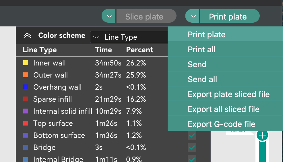

Don’t know about the P1x, but with the X1C it is quite easy: I use the „Send“ feature of OrcaSlicer (should be available in Bambu Studio as well) to send all my prints – except the very first one – to the SD card. Then, whenever a print is completed, I just select the next one from the printer’s display, deselect the filament calibration and hit „Print“. As all files already printed have a little clock icon in the corner of their thumbnail I can easily recognize them and won’t accidently print the same file twice or omit one. Much easier than the „print and cancel“ option and almost as quick and comfortable as a print queue. It even has the advantage that I can change print order anytime if a high-priority print comes up. Again, this might not be practicable or even possible on the P1x but perfectly fine on the X1C. I just have a feeling that most people don’t even know about this feature.
@Lemming Nice. I guess I do it this way because the sd card reader on my x1c died and I chose not to deal with bambu support again. lol
@Lemming
Thanks, that’s a good idea! But I cannot find the command “send to sd card” in the Studio. A screenshot would be fine.
This is from OrcaSlicer, but it should be the same in Bambu Studio:
After slicing the plate, just click on the little arrow left of “Print plate”, then select “Send”.
