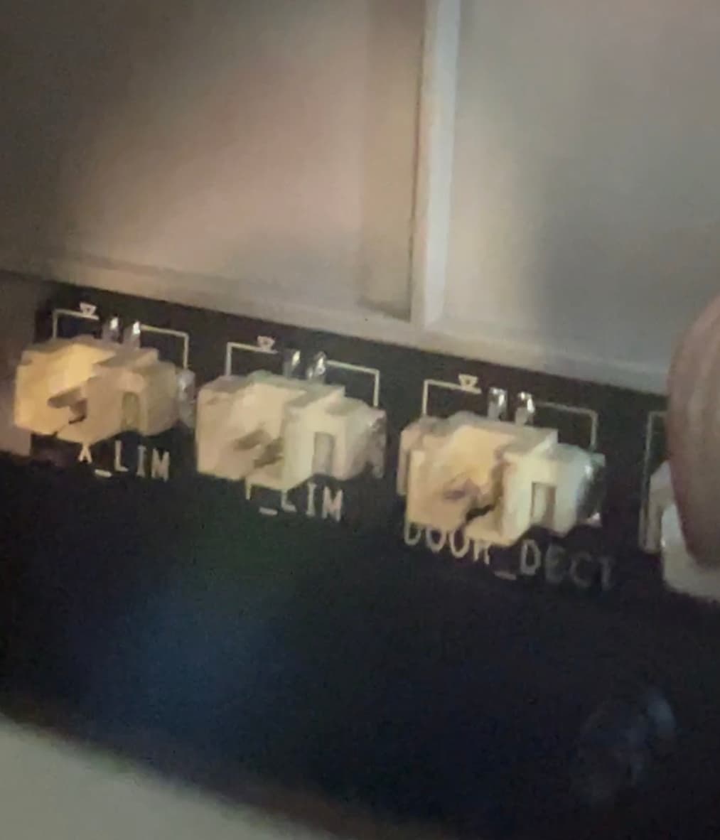

There’s 2 other connectors on the same board the Door Dect switch is connected to. Any idea’s what these were intended for? I would like to repurpose the door switch to control my BentoBox air scrubber.
“X_LIM” and “Y_LIM” would be limit switches for the X and Y axes. Which aren’t really necessary anyway. So I could see them being deleted for cost reasons.
