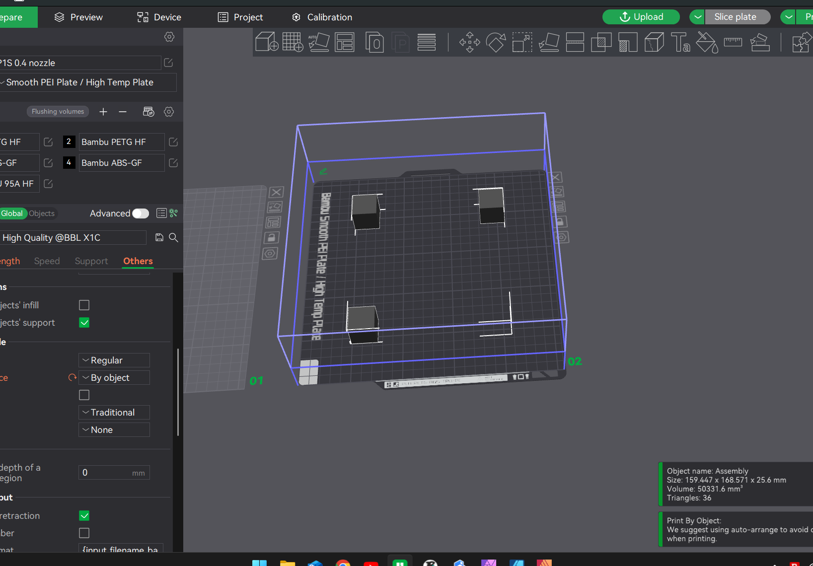

  1. Under the “Prepare” tab, set up two filaments.
  2. Add three cube primitives to the plate.
  3. Select two of the cubes and right-click and merge them into an assembly.
  4. In the sidebar, set your standalone cube to one filament and your assembly to the other filament.
  5. Change “Print sequence” to “By object.”
    You should receive the warning “Assembly is too close to others, and collisions may be caused.”
  6. Click “Arrange all objects” in the toolbar.
    You should receive the warning “All the selected objects are on the locked plate, We can not do auto-arrange on these objects.”
The plate was never locked and appears with an unlocked icon next to it, so I don’t know where this error comes from.

And indeed when dragging an assembly when “by object” is selected, Studio does compute a single keep out boundary contour for the assembly:
The auto-arrange algorithm as-is could easily solve how to position the black and orange objects far enough apart, but it instead complains about being locked which isn’t true.
