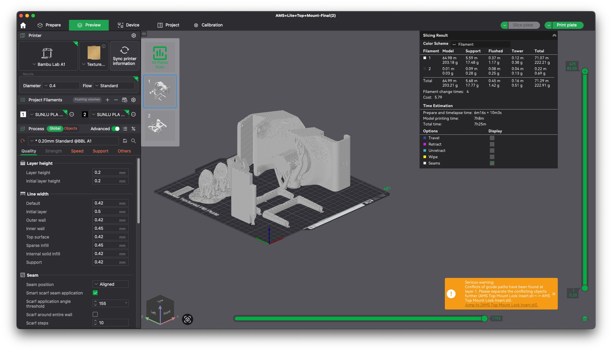

For some reason I’m getting a “Serious warning” about “conflicts of gcode paths” when trying to slice Plate 01 of the AMS lite Top Mount for A1. I’m using the default “Designer” profile with no tweaks to the profile other than changing the filament to Sunlu PLA Matte.
I have no issues slicing Plate 02, though, and it printed perfectly.
I’m a total Bambu Studio newbie so I’m not really sure how to resolve this. Here’s screengrabs of the error:
if the objects including supports appear to cross paths move them further apart
Oh that was totally it, thanks!

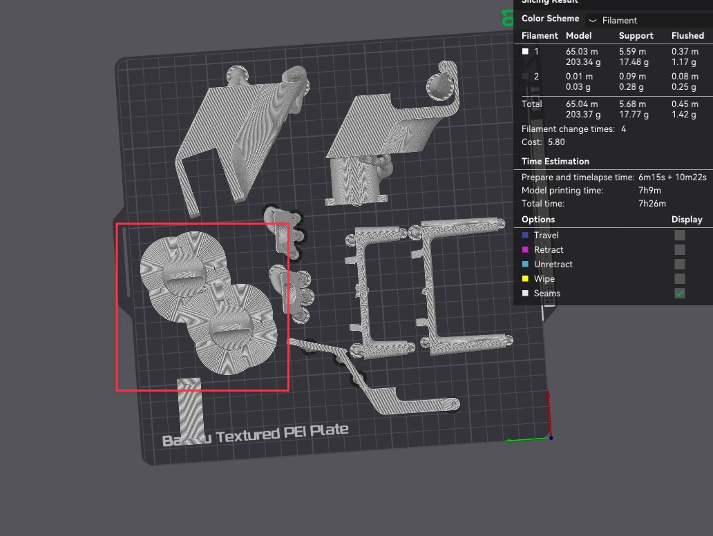

I moved the pieces farther apart, but it is ok that the brims overlap like this?
If it doesnt give an error , they might be being considered as one , slice it and see
Nope, no slicing errors now, so I assume it should be ok. Thanks again!
