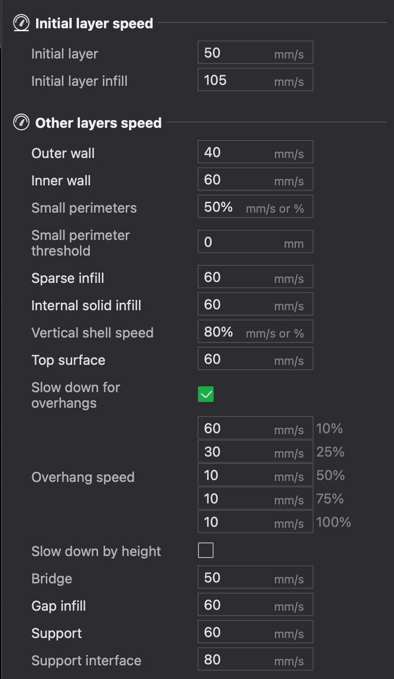

Setting print speed to what is marked on spool
I have a just-opened spool of ABS from an out-of-business(?) Chinese manufacturer (hence no support contact to which I can write). Like most spool labels, the one on that spool lists ranges for bed temperature, nozzle temperature, and printing speed. But not maximum volumetric flow.
How do I go from a labelled print speed range to Bambu Studio settings? Bambu Studio lists more than 15 individual speeds expressed as absolute mm/s numbers:
Unlike Cura, there doesn’t seem to be a master “Print Speed” setting from which the other speeds are derived by Bambu Studio. Am I missing something obvious (to everyone other than me)?
I have more than 100 different spools of filament, almost none of which have available .json files for filament and process. I can’t turn every spool into some sort of science experiment. I just need to enter the specs from the labels so that I at least am in the ballpark.
You set filament flow in the filament profile. The slicer will generate toopaths that run at the specified print speeds or at a lower speed that’s limited by the flow rate specified.
The recommended maximum volumetric flow rate does not appear on the label of any spool in my collection. I am trying to set a print speed within the specified range shown on the spool label, even if the filament is capable of far exceeding that speed based on some unspecified maximum volumetric flow.
The 0.20mm Standard @BBL X1C process has an outer wall speed of 200mm, an inner wall speed of 300mm, and so on. And the ABS filament I’m trying to print has a label calling for 30-50mm/s printing speed. So what maximum volumetric flow rate do I set for that filament?

Using the Generic ABS profile resulted in all five PTFE clips I was printing being flung all over the build plate at high speed with near-zero adhesion. That’s likely because the ABS that I was printing had an extremely low recommended print speed range (according to the label) of 30-50mm/s. Radically adjusting down a dozen or so speeds within Bambu Studio, while changing nothing else, resulted in a perfectly acceptable print the first time. I didn’t even wipe off the build plate between the two prints.
The specs on the spool label are only suggested values intended to produce “acceptable” prints with a large range of printers. They are no better or worse than values in the Generic profiles provided with Studio.
I’ll take acceptable prints done at the recommended 30-50mm/s over failed prints done at Bambu Studio default 200-300 mm/s speeds.

Required Flow Rate = (approximately) Nozzle Diameter * Layer Height * Print Speed. If the filament roll only has print speed, it’s likely assuming a 0.4mm nozzle and a 0.2mm layer height.
ABS generally has pretty low flow rates. You should end up with a number that’s around 10-15mm/S unless this is specifically “high speed” ABS.
Run the manual flow rate and PA calibrations and that’ll eliminate any guesswork. In my experience, what’s on a filament label isn’t always representative of how the filament performs.
Brilliant! Thank you very much. At 15 mm³/S, the print failed spectacularly with print speeds far in excess of what the filament could handle.
It’s looking like 4 mm³/S to get the label specified upper limit of 50 mm/S print speed:
0.4 mm nozzle * 0.20 layer height * 50mm/S print speed = 4 mm³/S
That number seems about right. Lower end but not unbelievably low. :slight_smile:

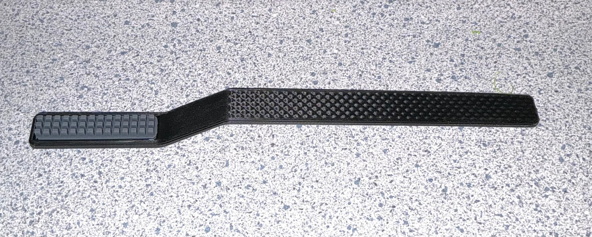

Using 4 mm³/S, I was rewarded with a near-perfect print of a handheld nozzle wiper that makes use of Bambu A1 silicone wipers:
Thanks again! :grinning:
