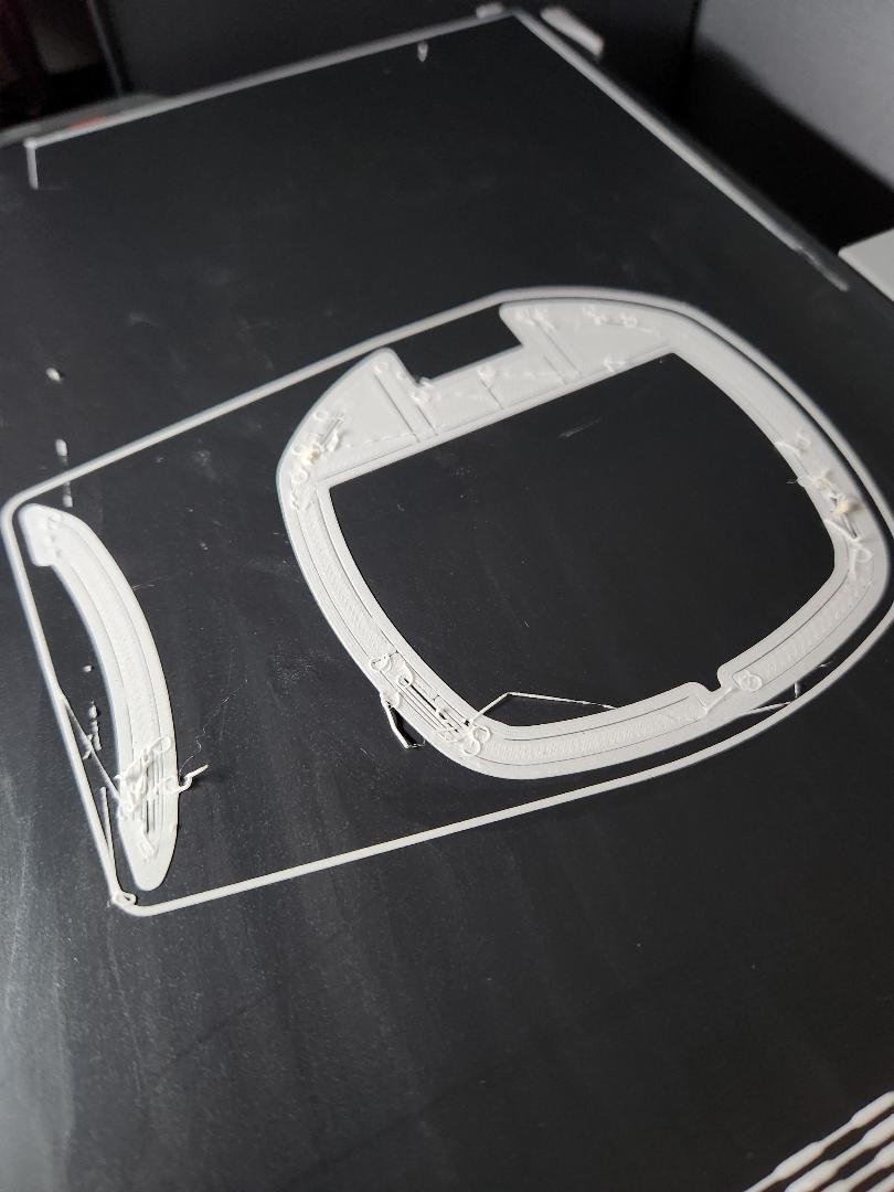

Morning, I am using eSun LW PLA with my X1 Carbon, inputted the settings shown to work by “Totorus” (thanks) and getting alot of stringing, globs and part not sticking. The first print seemed to run great, tried another part and disaster. Not sure if its wet material or? Thanks

Stringing is normal with this filament and you will always have stringing.
To limit it you have to:
  • Print only one part at a time (Very important !).
  • No retraction or z-hop in the filament profile.
  • Avoid crossing walls when traveling. Check “Avoid crossing walls” and set a large value in “Avoid crossing walls - Max detour length” (I set 1000).
Depending on the shape of the part and its design, you won’t always be able to avoid traveling over empty spaces, and it’s always in these places that you’ll have the most stringing.
I always check the “travel” box in the preview window to see the movements of my print head. This allows me to fine-tune the “Avoid Crossing Walls” settings.

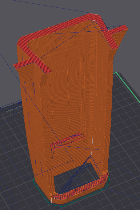

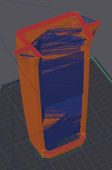

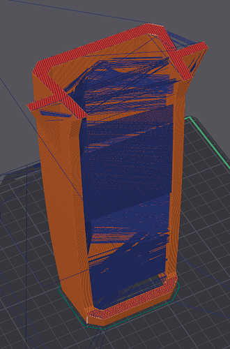

Look at the difference between slicing this part:
Avoid Crossing walls “OFF”

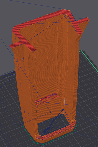

Avoid crossing walls “ON”
Printing takes an extra 11 minutes, but my part comes out impeccable.
I hope this helps.
