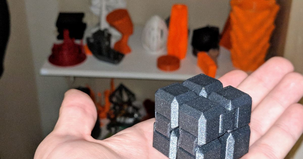

The challenge with these print-in-place models is that they work for the designer but are hard to duplicate exactly. This is especially true when crossing from one printer to another and one slicer to another.
I addressed a solution earlier in the day. You may read it here:
What I would first suggest is trying to dial-in using a simpler print-in-place geometry. It will go quicker and you can repeat the trial and error with less filament. Then when you are successful with dialing in the correct X-Y adjustments, try out something more complex like that dragon.
Here is the simplest model out there. Just two cubes.
https://files.printables.com/media/prints/928/stls/14403_8c8556e2-5f1b-4056-b808-caea45adcc85/yafic_v2_test.stl
And this is the page it came from. Tune your filament using the two cube version first then step up to the full model.
