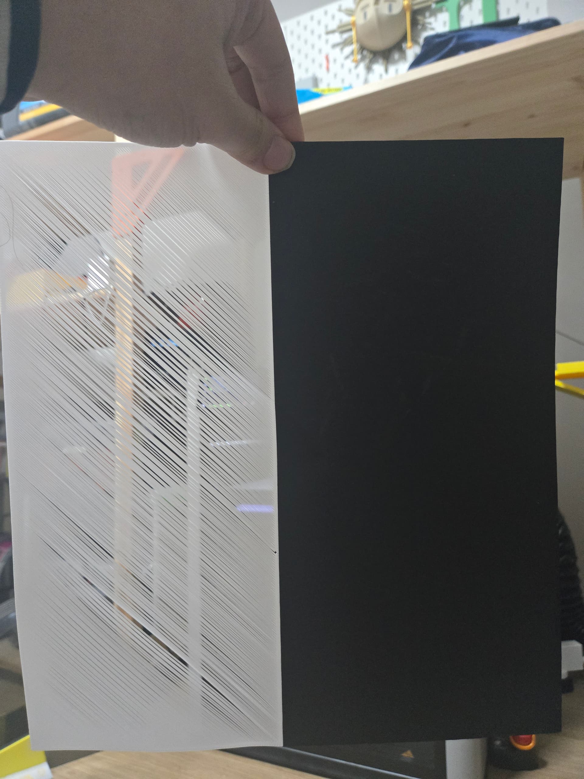

For some unknown reason they probably have changed something regarding to the left nozzle’s bed mesh.
This is what I was getting with 1.01.03: the white part is printed with left nozzle.
I did a factory reset, redo every calibration step, then it simply went from Z too high to Z too low (I got tons of wavy patterns).

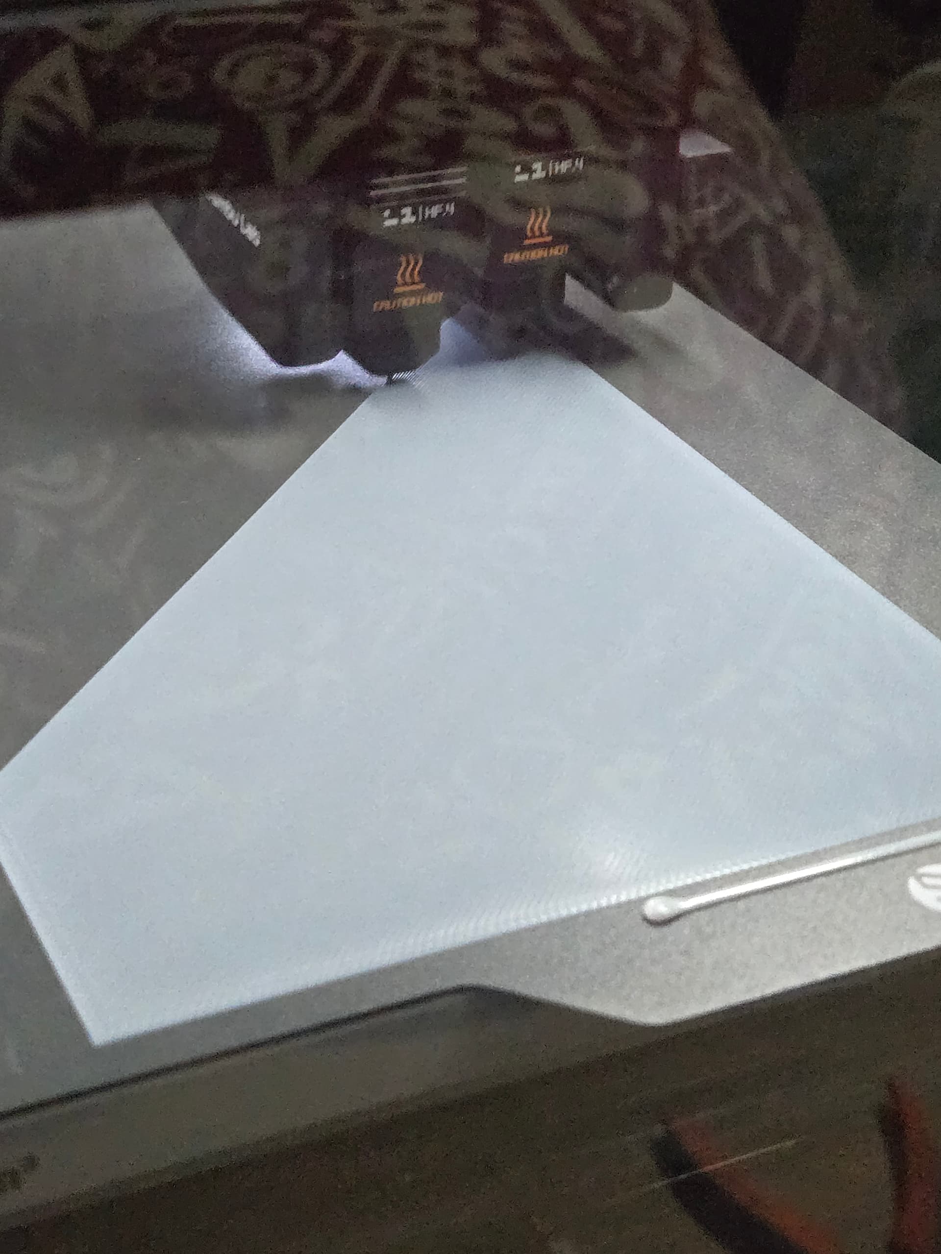

Then I downgraded my firmware back to 1.02.08 (latest production firmware), this is what I’m getting from the exact same file:
Perfect white area, printed with the left nozzle.
All I did is to just downgrade back and redo calibrations.

But the result is still, new beta firmware= bad first layer for left nozzle; old firmware = great first layer for left nozzle. Even if nothing else has changed.

I can’t say for sure, but this looks more like poor adhesion rather than a calibration issue.
When I print a full bed sheet on my X1 Carbon with too low bed temperature, I get exactly the same result as the left part of your image. Once I raise the bed temperature to the correct value, I get a solid sheet that releases cleanly.
I also tried a full bed sheet utilizing both nozzles on my H2D, and it came out as a solid two-colored sheet.
I’m on the latest beta, and as far as I know, my full calibration runs both nozzles. Even if it doesn’t, the prints still come out fine.
no. just try it yourself. do a bed calibration and then run a single layer left nozzle test. You would be surprised.
also it has nothing to do with bed adhesion, the plate is a PLU plate that is capable to stick your fingers on it :stuck_out_tongue:

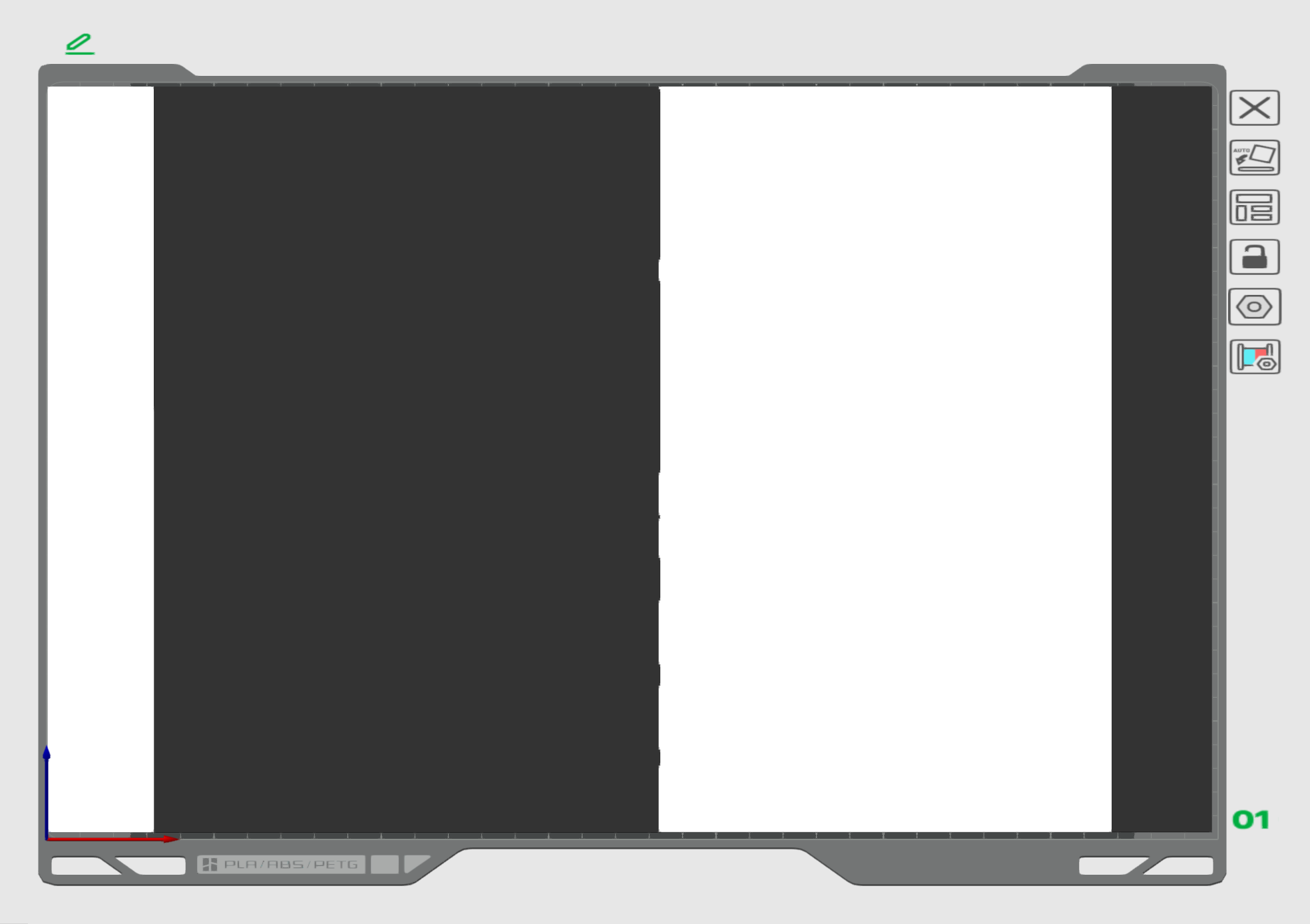

but the real reason is that I didn’t post the photo of leftover parts of that test print.
This is what it actually looks like in slicer. The rightmost black part printed with the right nozzle is having a much better performance than the white area printed with left nozzle.

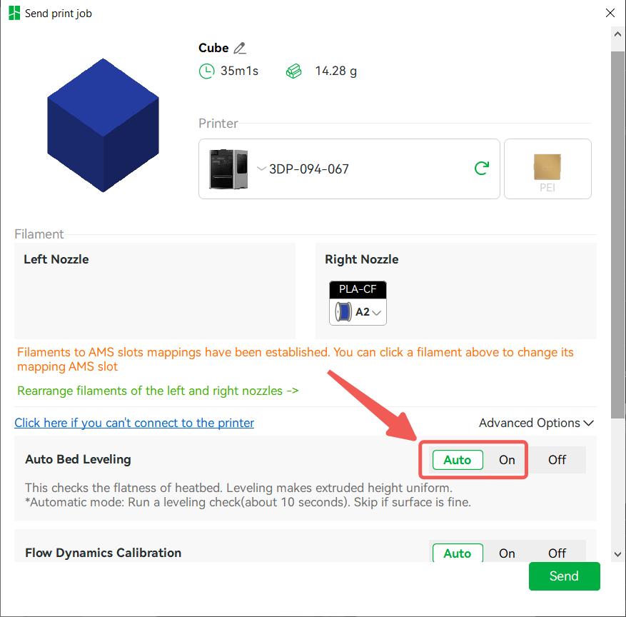

Please @supportasistant, don’t do that. @hotellonely, I’m not sure of what you found. I will have to check but I think you still get full mesh when you do cold and hot bed full calibration, it is then kept in memory and during actual printing, auto bed levelling will only mesh around the model and verify or compensate for any deviations compared to what was recorded. If it were to do a full mesh at every print, I would scream.

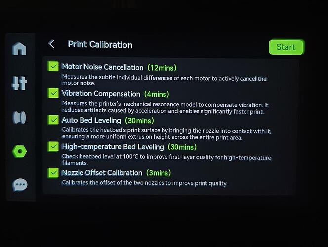

I’m not talking about the bed mesh before the print. I’m talking about the full bed mesh calibration that you do after for example a factory reset. Even after a factory reset, it’s still skipping all these steps for the left nozzle:
Full bed mesh (dense/detailed)
High temp bed mesh (sparse and dense)

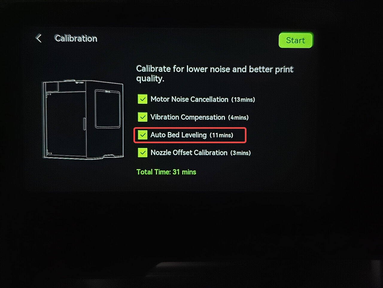

If you do a full calibration(including motor noise and vibration comp/input shaper…etc), you would notice that even though the estimated time is ~1hr, what it actually spent is MUCH LESS THAN THAT, somewhere like 20-40 minutes is all it takes. Because it’s skipping those steps.
Previously it was literally taking that long.

Now I have reverted back to the previous public firmware, and I can confirm that the behavior is different and it’s doing the calibration right without skipping those steps I mentioned.

I think it has always been this way. Take a look at the wiki (reproduced below)
https://wiki.bambulab.com/en/h2/manual/h2d-faq
Q: There are several types of heatbed leveling for printers. What are the differences between them?
Auto bed leveling on the Print calibration page
  • Heat the nozzle to 140°C;
  • With the bed at room temperature, perform an 8×8 point leveling using the right nozzle;
  • Heat the bed to 55°C, then perform another 8×8 point leveling with the right nozzle;
  • Continue with a 22×22 point leveling using the right nozzle;
  • Finally, switch to the left nozzle and perform an 8×8 point leveling.
High-temperature bed leveling on the Print calibration page
  1. Heat the bed to 100°C while heating the nozzle to 140°C;
  2. Use the right nozzle to perform the following leveling steps:
  • 8×8 point leveling
  • 22×22 point leveling
Note: The high-temperature bed leveling data will be automatically applied when the bed temperature during the print job is ≥ 80°C. Suppose you have replaced, disassembled, or manually leveled the bed. In that case, it is recommended to run both Auto Bed Leveling and High-Temperature Bed Leveling again on the Print Calibration page to ensure the machine obtains accurate bed plane data.
Auto Bed leveling before printing
When “Auto” mode is selected:
Before printing, a 5-point touch test will be performed on the corresponding areas of the model contour to determine whether partial leveling is needed.
  • If partial leveling is required, use the 8×8 leveling points that cover the model’s projection contour on the bed for leveling.
  • If not required, skip the partial leveling step.
When “On” mode is selected:
  • Directly perform partial leveling on the model contour area on the print bed.
Note: The partial leveling data and calibration leveling data (including Auto Bed Leveling and High-Temperature Bed Leveling) will be stored in the printer. During printing, the system will automatically combine and apply both sets of leveling data. This data remains effective until a new corresponding leveling task is performed to update it.
