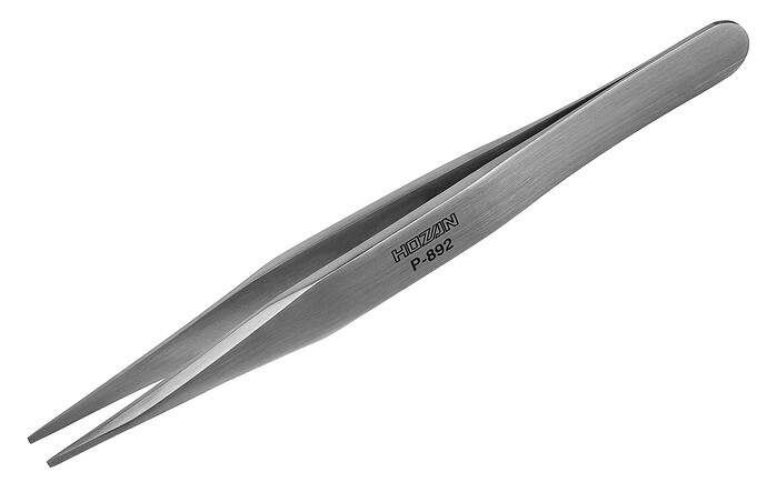

Tweezers are also a necessity
Handy for helping remove small hard to reach supports and snagging those errant filaments off the print nozzle or bed.

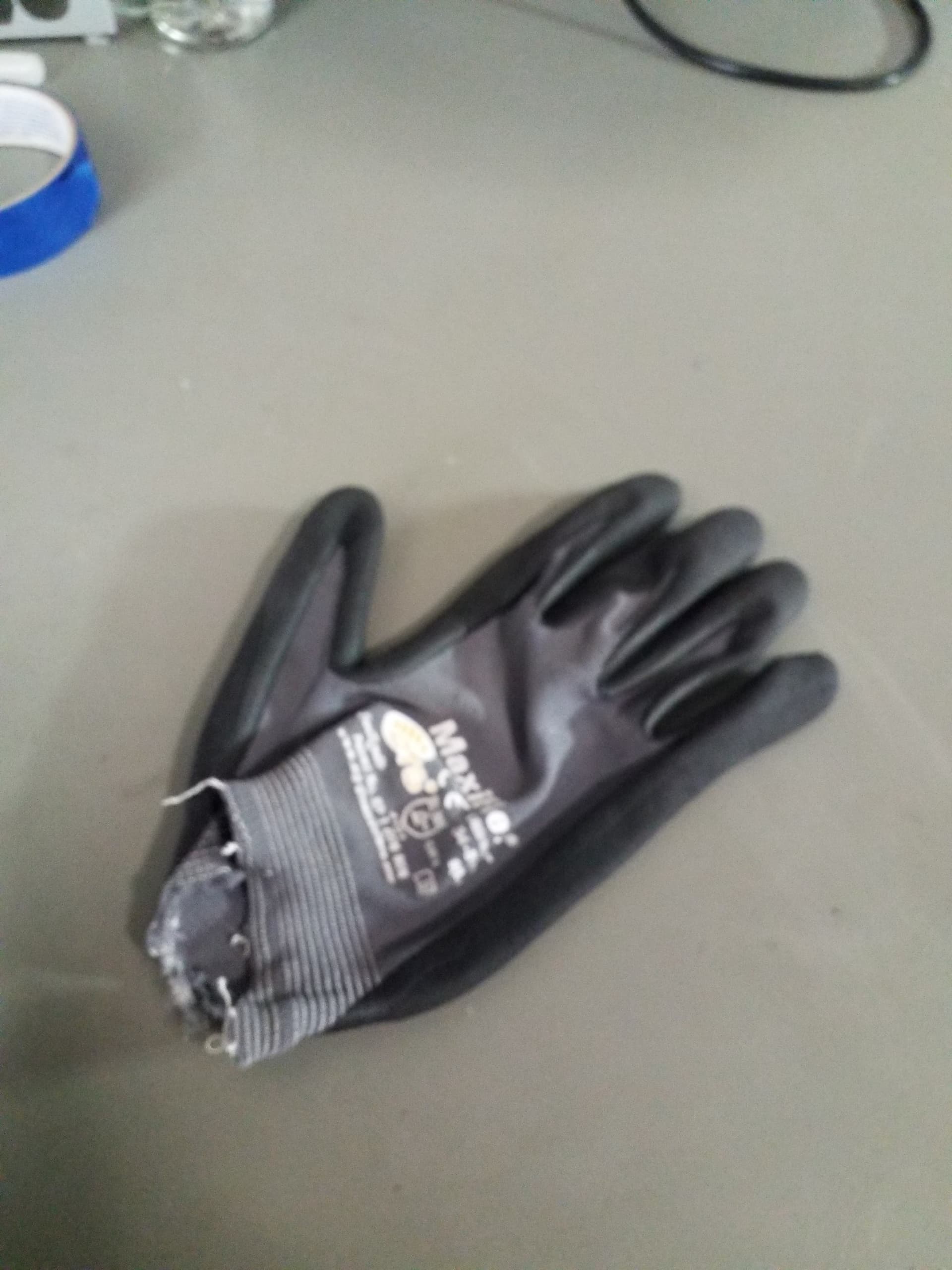

Since i print mostly abs and other hot variations of filament. I have to have this to handle the plates. Plus it keeps FINGER prints off the build plate.

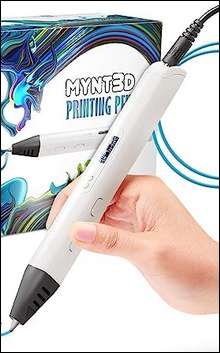

A 3D printing pen comes in handy as a welder to fix pieces together. I use it mostly to mount small electronic boards inside my projects.
3d pen

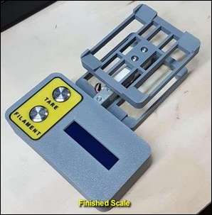

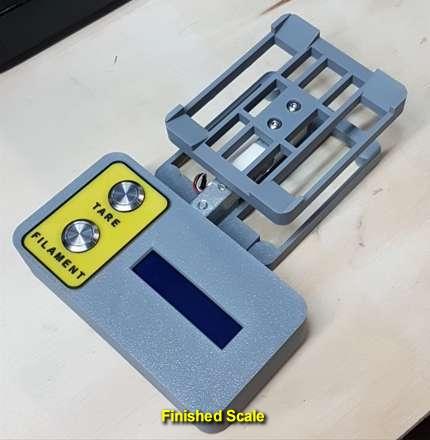

I liked the idea of a digital scale to help figure out how much filament was left on a spool but didn’t want to bother with the math.
I ended up building a filament scale to tell me how much was left on a spool.
scale
I just tare the scale with an empty spool and the scale reads out the length of filament that’s left.
Ooh the tare weight is a good one.
I forgot to add that to my list. I have a kitchen scale I use for the same thing.

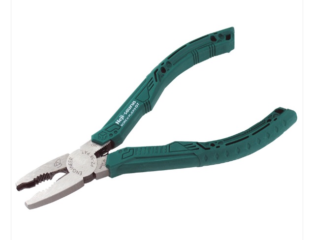

The two tools I use frequently (that aren’t things I think most people normally use) are stripped screw removal pliers and weeding tools.
While I have used these pliers to remove stripped screws in the past I use them mostly for removing supports or just gripping things that normal pliers might have a tough time with.
pliers

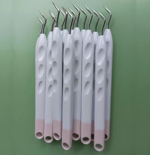

The weeding tool is meant to be used in crafting for removing the boarder around decals and vinyl, but I use them to remove hard to get to support bits. They are also handy at re-pinning JST and Molex pins.

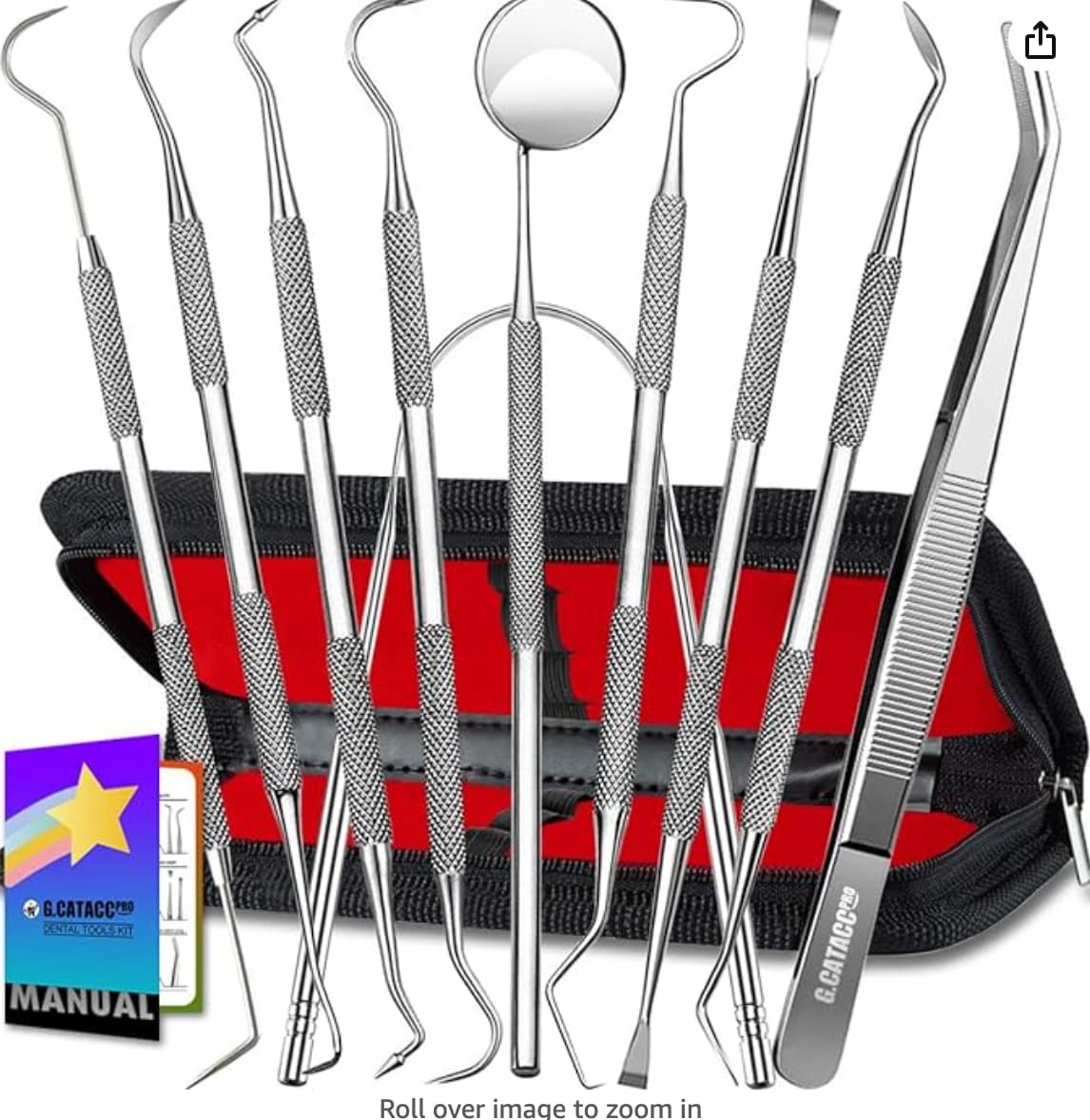

Great suggestions here and a briliant idea to start a thread on this. Similar to the last post, I use dental metal picks to help with removal of supports and smoothing out imperfections.

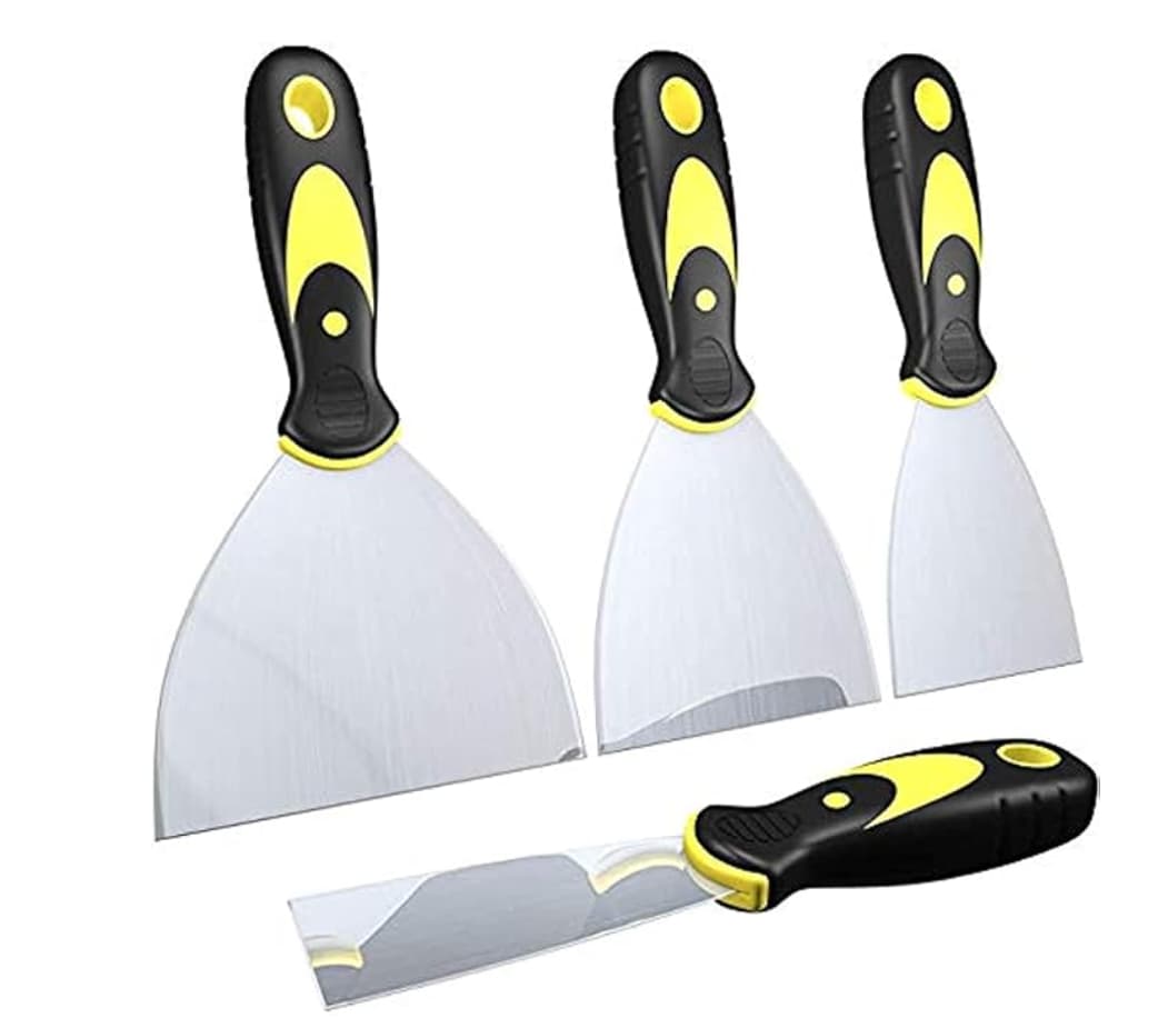

I also found out that using thin, putty knives really helps with separating supports from the base model. I use rounded edge ones, similar to what you see in this image. It’s essential to use them with protective gloves!

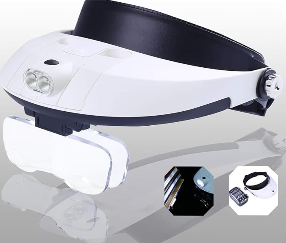

I use a head mounted magnifying glass with a light that helps me work on fine details when I paint models.

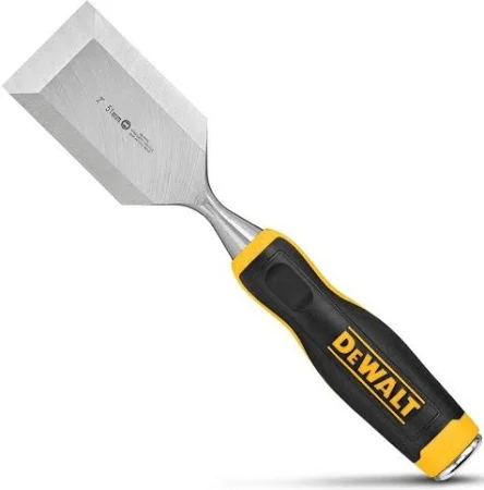

I use one of these to remove plastic from the build plate. The flat back side of the chisel blade can be laid flat on the surface of the build plate. The sharp edge gets under everything and as long as the back of the blade is flat against the build plate (and the plate itself is relatively flat), there’s no scratching of the build plate or damage to the model.
Much better than a plastic scraper or one of the type that uses a razor blade.

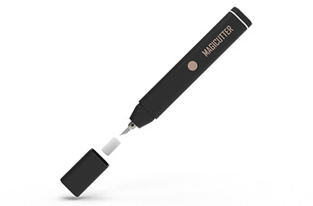

Then, I use one of these ultrasonic cutting knifes to remove stubborn supports or other print-related artifacts on my printed model. Expensive, for sure. But it’ll cut through thick plastic like a hot knife through butter.

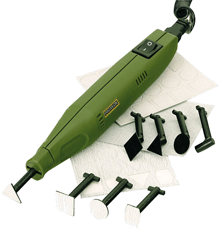

This small power sanding tool is good for smoothing small areas. CAUTION though, they rape you on the cost of the required power supply. I got a variable 0-20V supply from Aliexpress for about $15 that works perfectly (had to chop the connector off the sander though). Proxxon PS 13

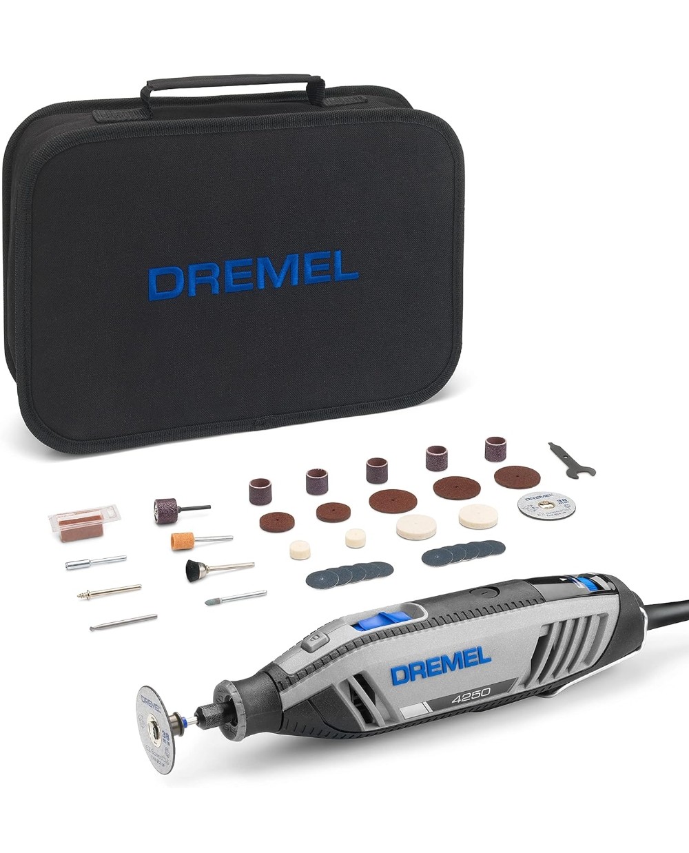

I’m regularly relying on my Dremel 4250 set (supplemented with various accessories as shown below) for various post-processing work on my projects, as well as on the very useful “Stealth Press” for inserts accurate placement (Printables)
