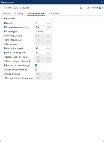

  • PETG - Tuned X1C Print Profiles for Bambu/Orca-Slicer

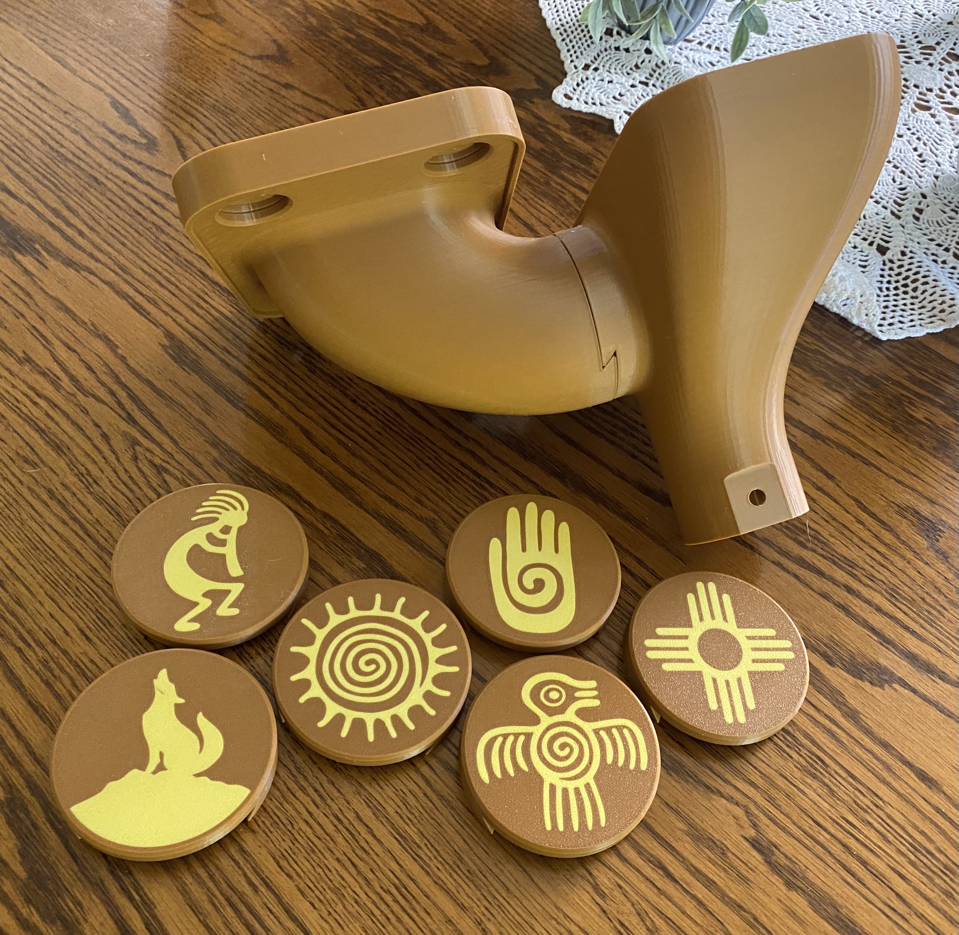

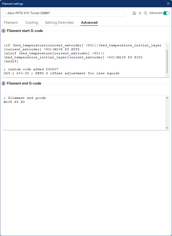

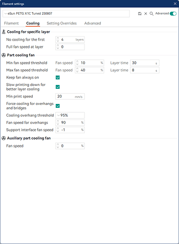

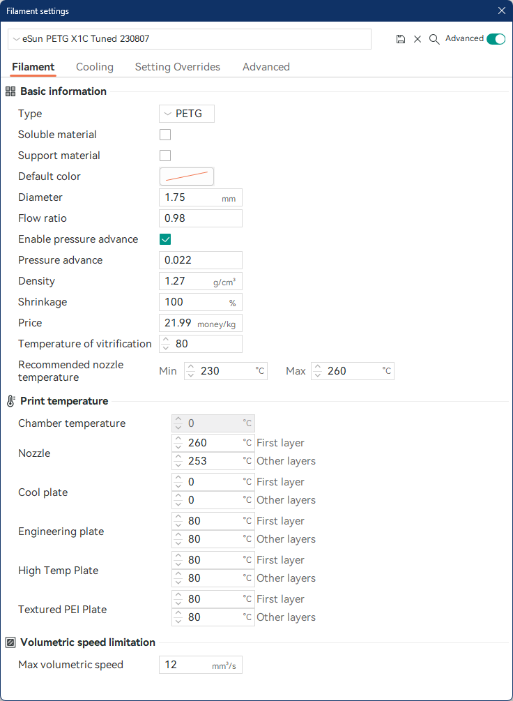

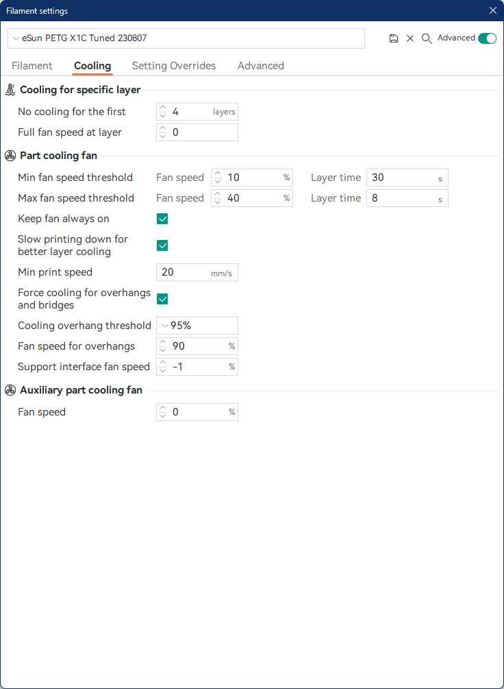

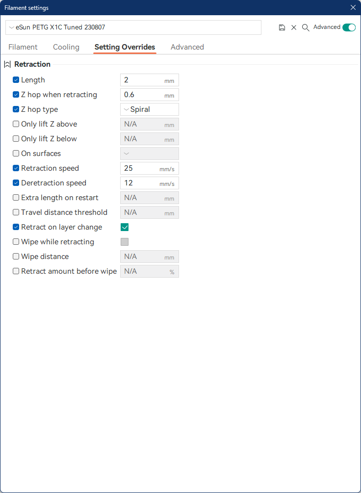

I’m currently tuning eSun PETG. Not entirely happy with the surface quality yet, but this is 90% there. I started with the eSun recommended X1C settings and tuned from there.
